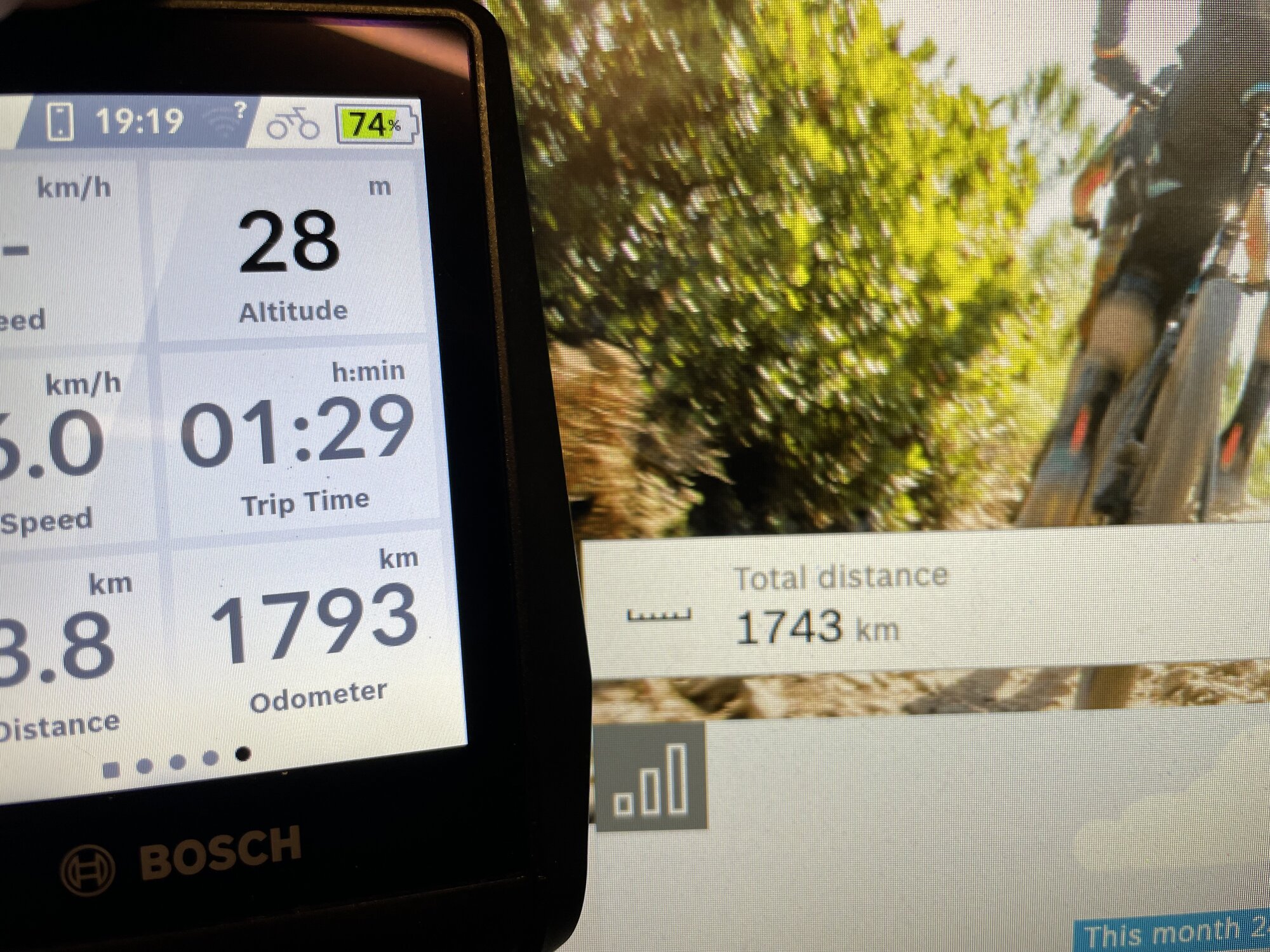

I have a discrepancy between my Nyon and eBC.
Last Friday, I updated the Nyon's software and downloaded the October 2021 maps. I then went for a ride of about 10k which the Nyon registered at the time, and I'm sure it updated the odometer's total, but when I looked the following day there had been no map drawn and the ride didn't register on the day's total. At the time I set off for the ride, I was sure that the downloads and updates had finished, but there was a warning message the following morning about it being dangerous to update the maps whilst riding. I wondered whether there was still some work going on behind the scenes that I was unaware of when I set off.
A couple of times previously I've had trouble with the Nyon synching with my phone. I suspect that's where the discrepancy lies. But, as per my photo, there's a 50 kilometre difference between the Nyon and eBC.

I don't even worry about it often I cant get bosch to upload the ride that day unless I go on another ride. it usually updates fully the next day. also it may not show on the webpage right away. I have to refesh on my phone maybe a couple of times before the webpage updates.
What type of mobile do you use? Are you using a BT and/or Wi-Fi connection?
Iphone. I think its just the way the nyon uploads. it can say it has synced but it has not. I take a lot of rides in a day sometimes but its hard to get the last ride to upload till I ride again.
bluetooth. most of the time I cant get a wifi connection.
I use an Android phone. The Nyon has both Wi-Fi and BT permanently turned on. When I arrive home the Nyon quickly connects to the Wi-Fi access point 10 to 15m away. I wait for the syncing to be completed before turning the Nyon off and removing from the bike. With a couple of spurious exceptions this scenario has been very reliable.
When you are syncing via BT does your mobile phone remain close to the Nyon? At the time of syncing is your mobile phone connected to the internet via cellular data or Wi-Fi?
sometimes I want if it will connect to wifi then I just leave the nyon on till it turns off on its own. its just finicky about syncing. but I jump between two nyons sometimes several times a day.
