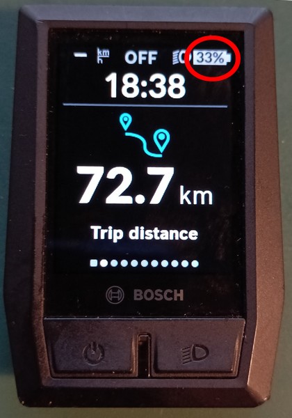

I am using an original Kiox display on my 2020 Moustache Friday FS27 '45' Speed-pedelec. [28mph]
My problem is I need reading glasses to see the tiny % digits in the top right hand corner.
But I don't want to wear glasses on my e-bike. My distance vision is perfect.
I'd need reading prescription lenses in my various pairs of sunglasses too.
Before I rush out and buy an expensive Nyon upgrade kit: For the larger screen size..
Can the tiny Remaining Charge digits on the Kiox be enlarged somehow?
Or shown more clearly on another of the optional screens?
I have ringed the tiny, Remaining Charge indicator digits in the attached image.
Thanks for any advice
Chris

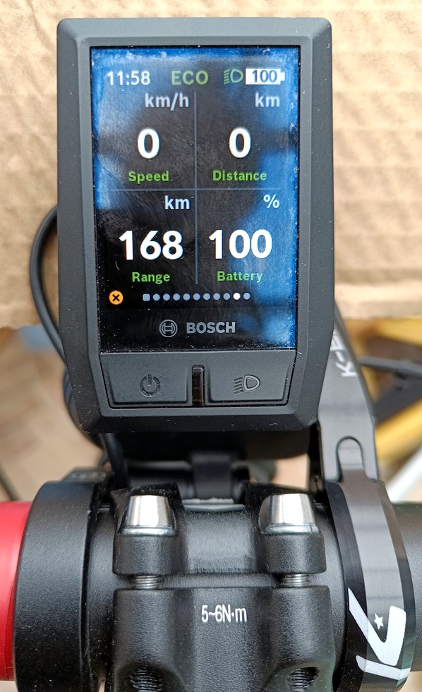

Success! Many thanks to those who responded to my request for help .
A great improvement! Which will save me searching across multiple screens.
Not always easy while wearing thick, winter gloves.
Now all I need is available at a glance in large, clear digits. 👍
Thanks again.
Chris

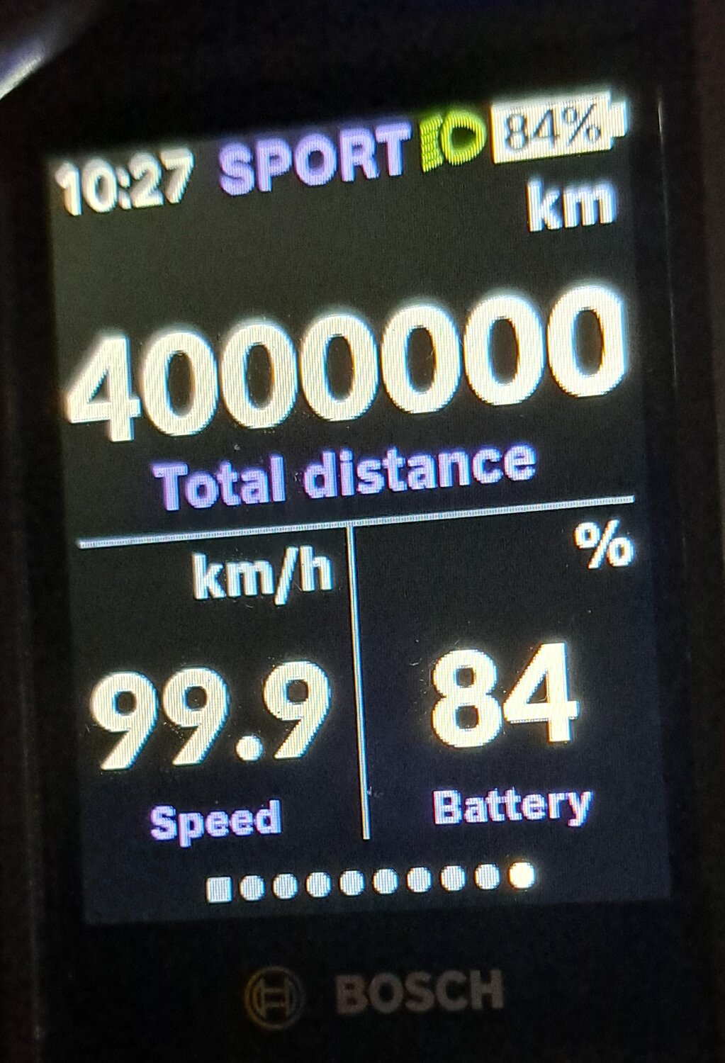

BTW: Was the 99.9km/h a GPS reading in "free fall?" ;)
No, just wanted to know if the motor or Kiox rolls over at 10 Gigameters. But it just stops counting at 4 Gm which equals 4,000,000 km
