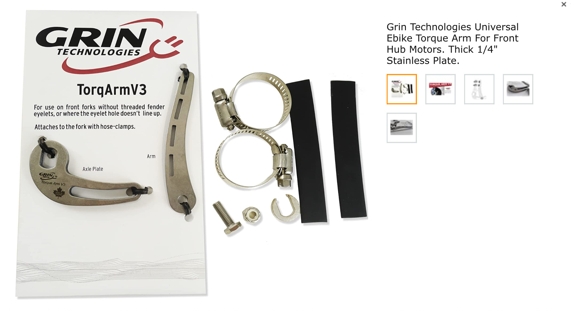

A pair of lets say Grin v3 clamps, secured by three hose clamps, not just one, and you'd be giving that axle and the dropout a lot of support. Especially considering we're only talking a 45-60Nm motor.

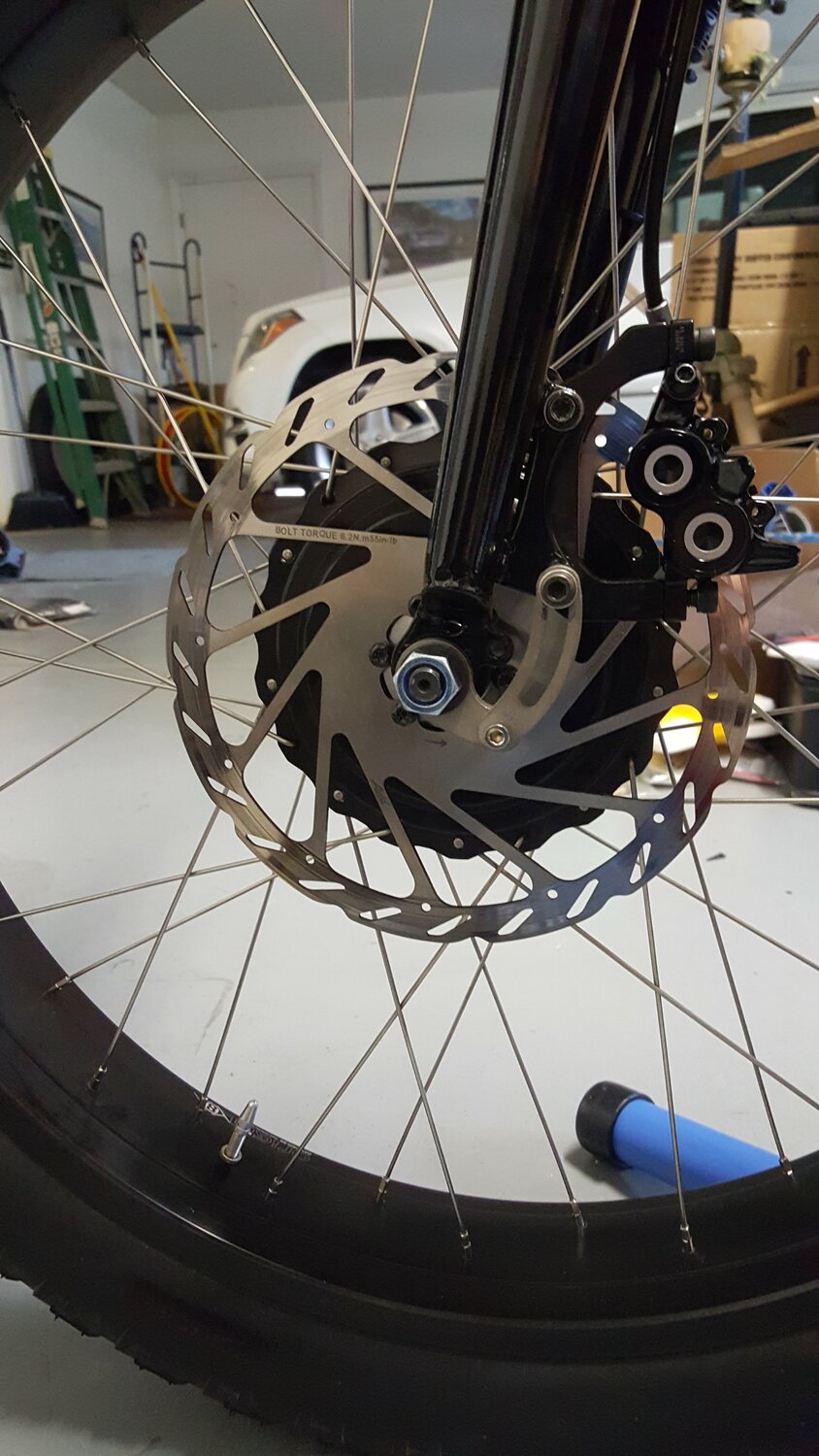

I dug into my archives. This one is from early 2017. Its half Grin v2 around the axle, and half of another UK manufactured torque arm (go to Ebay and search for 'bicycle torque arm'. Among the many Chinesium ones there is a company there selling them). What its doing is using a longer bolt on the brake mount instead of the short hop up to the dropout eyelet. Since you have no eyelets, this is a viable option for you (for me it helps to have a lot of spare parts in the garage so I can mix/match this sort of thing). Doing it this way lets me do completely without any sort of hose clamp, and the anchor bolt is a nice beefy M6 bolt. This is an 80 Nm motor tied to a 35a controller on a 52v system. So it is more than capable of ruining a steel fork.

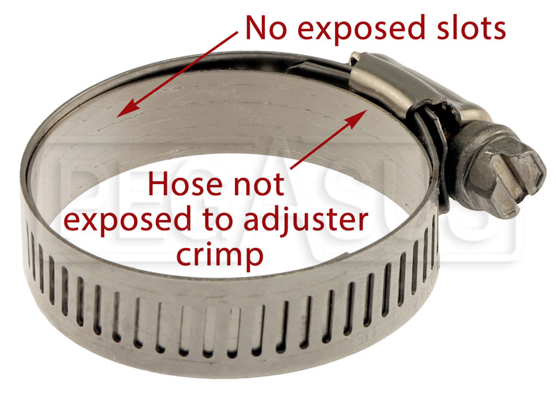

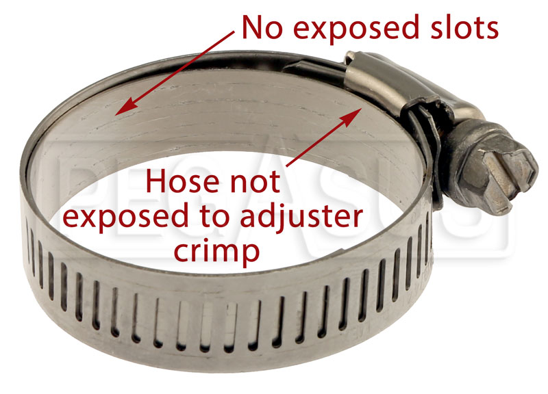

My replacement fork does not have any disk brake or fender eyelets that I could bolt the v.2 clamp on to, so V.3 is the only type that would work. (I think I wrote the numbers backwards earlier). I fully intend to buy some Grin torque arms. I was unfortunately not looking at a typical clamp when I commented on "worm hose clamp". hose clamp with metal lining.JPG

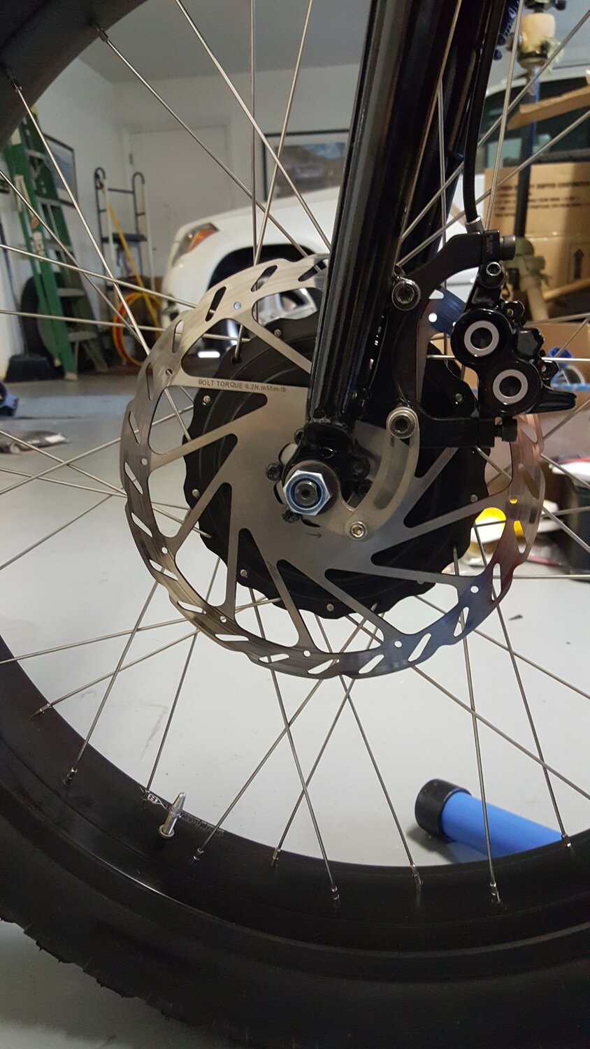

While I continue to whimper and whine over the price, I still have former customers running powerful front hubs, even with aluminum forks, for thousands of miles with Grin V3. My own 1500W peak F DD has several thousand miles of being beat on, hauling a too trailer, groceries, bags of concrete, and anything up to 150lbs of drag on the “tractor”. No sign of wear or failure.

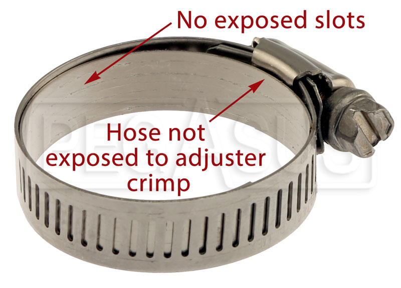

I recognize that watermark on that hose clamp pic. I used to buy stuff from there all the time when I was tracking a car and needed all sorts of related parts for it. Pegasus Racing is a good source. But still... a "lined hose clamp" is not lined to increase clamp strength. The liner exists to protect the underlying silicone hose, which isn't a factor here.
If anything, given that you need the thing to bend at a sharp angle likely as not, the second layer of steel will work against you. And since its a v3 with multiple clamps, AND you are doubling the torque arms... crazy overkill that may even work against you.
If you can make them work, great but you aren't creating any benefit. The local Ace Hardware will have more variety and is probably right down the street.

Thank you for your advice. I will order double V3 torque arms for the two tricycles and the bicycle in my garage. I sort of wish they did have Ace Hardware in Norway, but they don't. I will order Grin arms. I will also have to learn to read the threads a lot more thoroughly if I want to participate in forums. I appreciate your patience!
