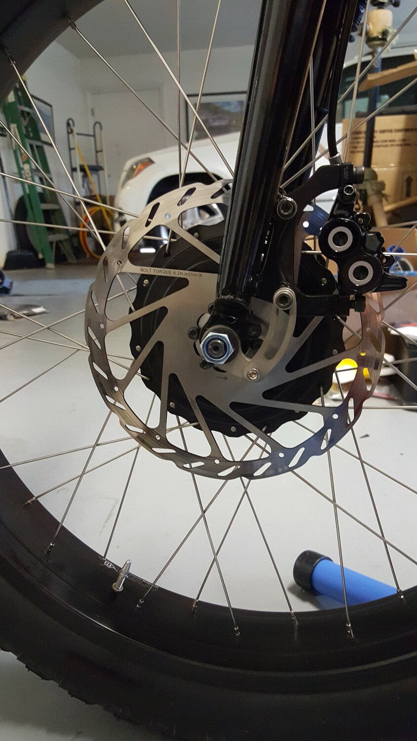

I have put a 250W motor on an alloy fork, but I used two torque arms. Torqued the nuts down to 22 ft-lbs, marked them with a sharpie and they never moved. Findally one day I came across a bike with a steel fork that used disk brakes, and I ordered the fork.
I used to be in doubt about whether to put the torque arms in front of or behind the forks. I recently took a couple of photos of what might happen if you put your torque arms in front of the steel forks. I think the photos speak for themselves. It was a 500w Bafang motor. I will also show a photo of the new fork and where I placed the torque arms (both sides).

@suenord1 frankly those torque arms are junk. They are the Grin Tech v1 that is widely counterfeited and seldom has even remotely tight tolerances at the axle. And even if they do, that torque arm can slip straight down even if you put them on properly. You've figured out the hard way not to put them on backwards; I assume thats a direct drive hub and it came out during regen/deceleration?
@ChrisOfBristol there is some merit to the thought that on only a 250w motor you can get away with torque washers. But not enough to risk your fork, which will be permanently destroyed if you spread the dropouts... which can happen. And on an aluminum fork? Thats playing with fire. The internet is absolutely riddled with photos of alloy dropouts on rigid and (especially) suspension forks that snapped clean off even with dual torque arms. Can you get away with a front 250w rigid fork if you use torque arms? Probably. Should you? No. You should use steel. Do enough research and you'll find more than ample examples not to emulate, and I am including the 250w power level, bearing in mind the wattage rating on a motor is meaningless and what really matters are the Nm of torque they output, which is comparable to much more powerful motors.
I've done many front motors; usually as part of a 2wd system. I've also done alloy forks successfully (so far) and I have ruined steel ones (using the torque arms that @suenord1 used above). What you want to do is eliminate the possibility of a problem because the consequences will be severe and permanent (you'll wrap your motor cable around your axle and about half the time it will tear out of the motor as it wraps). Since you have an alloy fork and thats that (and it looks like a nicely snug fit that I hope came naturally, you should
  1. Use TWO torque arms. Yes I know that doubles the cost. Compare that to a faceplant and a new fork. You want overkill here.
  2. Do not under ANY circumstances file the dropouts so the axle fits centered in the dropout. If you have already done this, go get another fork and try again. Filed dropouts snap off. Especially alloy ones. There are other ways to deal with the lawyer lips on a fork besides grinding off material crucial to structural integrity.
  3. If you can, use torque arms that move the point of contact up and away from the dropout. It looks like you have to do this since you have no fender eyelets. On an alloy fork with low power two eyelet type Grin V2 stainless arms would be plenty. Instead probably you are looking at something like a Grin V3 that has multiple anchor points on the fork.
  4. If you are doing two torque arms, its fine to use them both on the back side so long as you are not using regen on a direct drive motor. If you are, it has to be behind on the right side and ahead on the left. If its a geared hub just put them both behind and you'll be fine.
It was a 500 watt Bafang geared motor, the same as I have used on about 8 e-bikes. The dropouts failed in the first 5 feet, under very low acceleration. I did not even get out of the driveway. I know the copied torque arms are junk, but they were all I had. I have never had a wheel fall off like that on any other ebikes I built. The forks on that tricycle were were absolute trash. I have 2 tricycles and 2 bicycles in my garage. I hope the torque arms are on the back of the forks, but I will certainly check before using them again. I just hope my photos will make some people think twice about mounting them on the front of the forks. Thank you for commenting!
