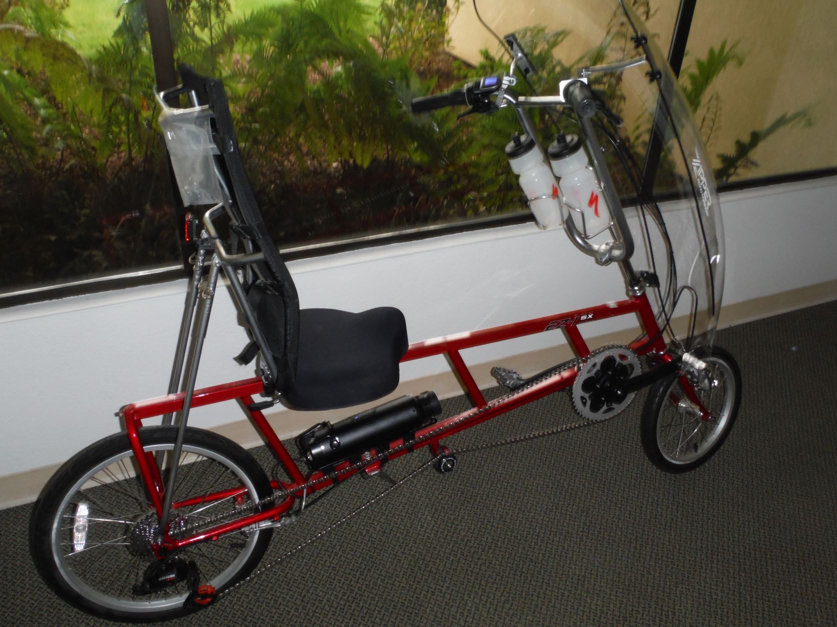

@slitespd, That is a big deal, having the weight out on a boom like that up it the air. It makes a recumbent highly unstable. Also Bafangs have some lag before they kick-in, then some over-run after you stop pedaling. Here is a photo of the worst build I have ever seen. It is a death trap. Put the weight low and centered, like on the red bike. Or, where you would put ballast on a sailboat.
Hence my hesitation in purchasing anything as of yet! I am also considering a motorized hub with a lean towards the front wheel for better weight distribution overall. Battery mounted just below the seat.
