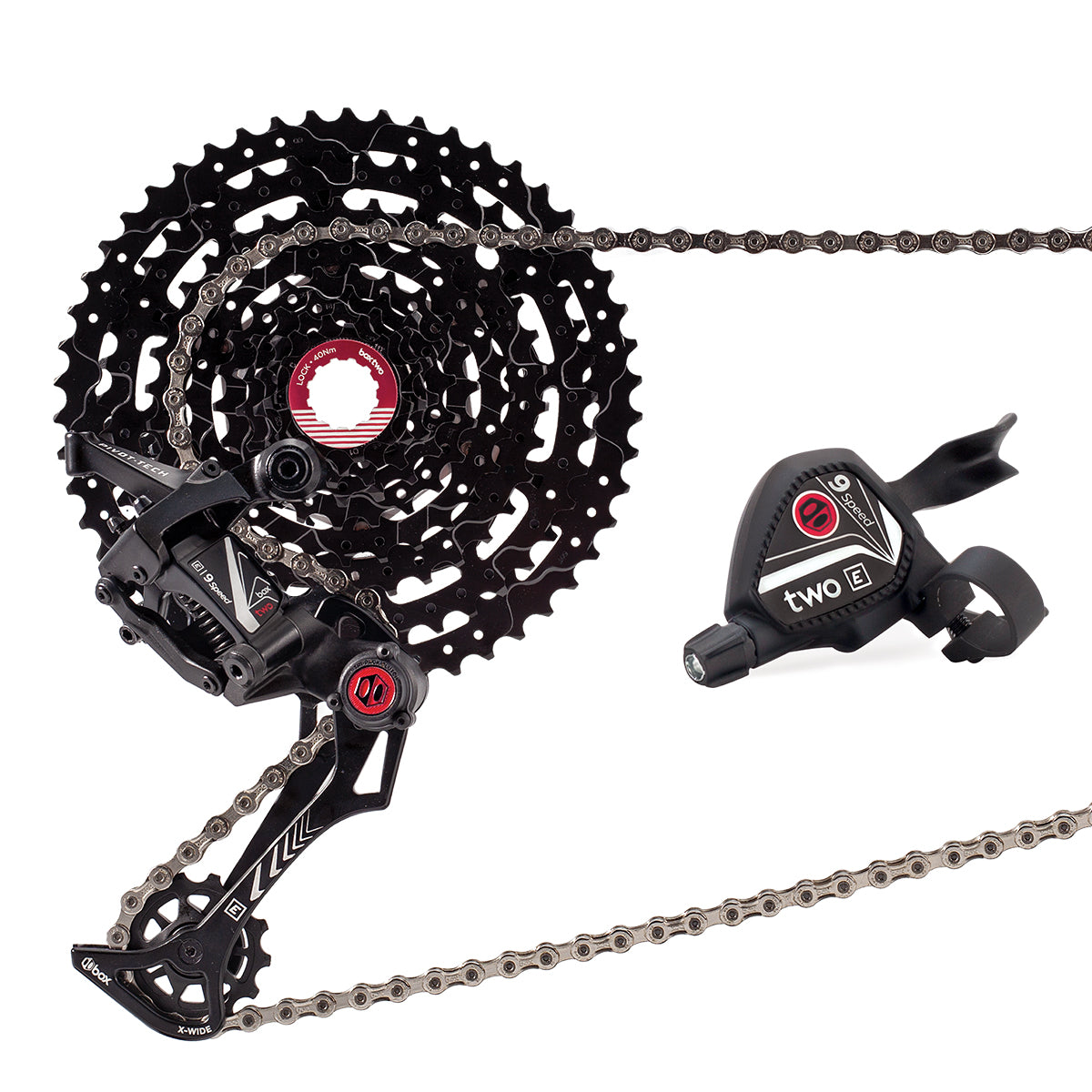

Looking into my crystal ball, there's even a potential future where we find a way to get to a nine speed, hopefully a mega-range, from 52 to 10. As we've gotten deeper into this, and I've scoped around to find posts from other folks who have done something similar, there is some alchemy involved to get optimal power delivery and resolve the chainline issues. People have done it, it just takes some experimentation.
