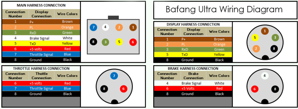

Here's the wiring diagram for the M620 connections. Just need to solder the julet on correctly. @scrambler is the Domino throttle pretty much married to the grip that comes with it or does it look like there's any way to remove the grip? Would be worth a try to switch it over to a thumb throttle or at least a half twist. I imagine the potentiometer based throttle is smoother and the innards take up a little more space (nature of potentiometer vs hall sensor). Strange to me the pot based one is cheaper considering hall sensors are dirt cheap and have no moving parts

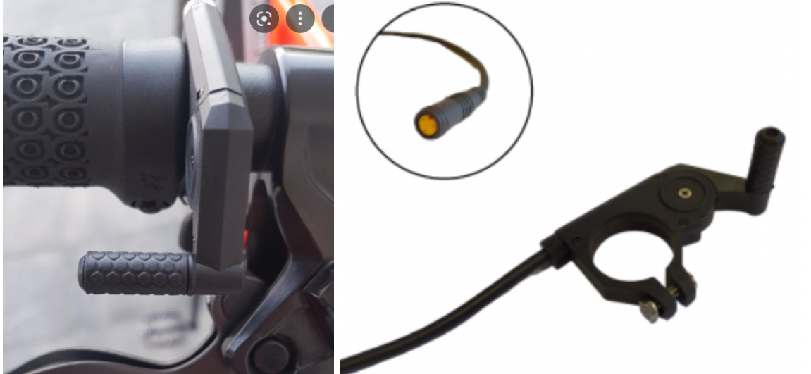

This is one of the ones I got from that guy in Poland. $35 and works great for what I use it for which is while starting off, as a walk assist and the occasional burp while actually underway. Well built and for my needs perfect as I use a grip shift and need as slim a design as possible so that my brake mount isn't shoved too far down the bar as to make it only a one finger lever.

And it was plug and play with the M620/M600 series as well as BBS02, BBSHD etc..
Really nice! Apparently they're out on holidy until next week I'll have to shoot them an email and see if they have any in stock. Like you I really just want a throttle for walk assist or to get moving on very technical terrain where pedaling may cause a strike. I'm going to see about leveraging my bike to tow supplies to assist with some volunteer trail work from time to time as well. I was out a couple weekends ago an came across a Canycom BFP602 just... out there... 5 miles in and 4000' up an often tight and winding trail. I can't imagine it being too fun huffing exhaust from that thing for 2+ hours to get it there, though I don't think I can outdo a 1000lb payload... more quickly hauling tools and food/water for day jobs that use downed trees and rocks already in the area than bringing bring that and a half dozen bags of crushed stone and 4x4's - getting some stuff to less accessible areas.
While I've got no doubt in the quality of the Domino I can't stomach $110+ for a throttle when it won't even work on my setup without modification. I checked their site apparently they sell different throttle tubes (the twisty part that the grip slips over) which leads me to believe they're removable and you may be able to get it down to just the budy and a little twisty bit the throttle tube fits on. This would make it easy to print a little thumb paddle for it but there's no guarantee it'll work with the X1 nicely and even then still seems fairly clunky like the other thumb throttles out there. I've got a pair of SQLab 710 grips and the 410 horns and don't want to have to sacrifice comfy contact points for a throttle - especially when I probably won't use it at all bikepacking.

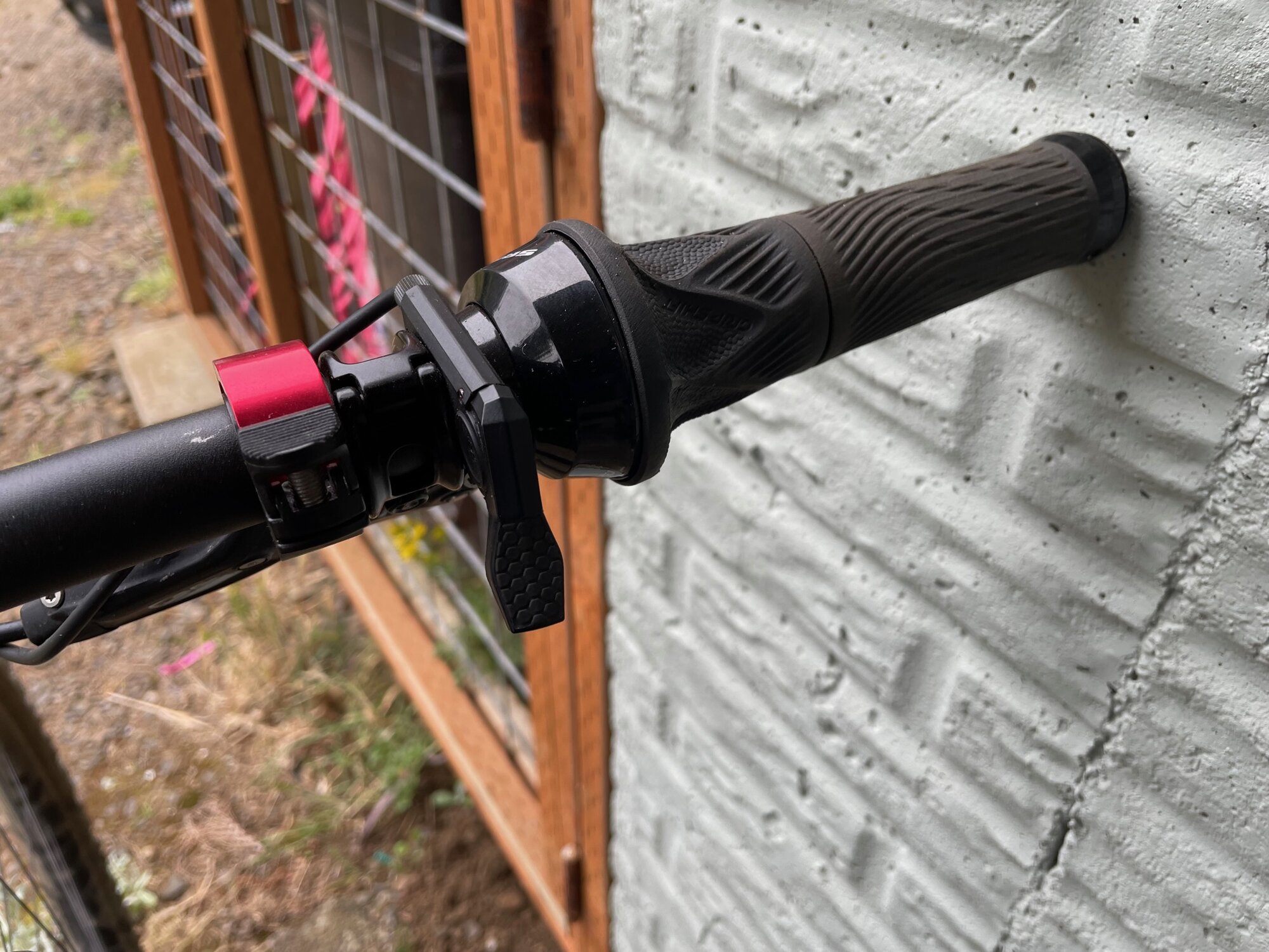

One thing I do notice from the picture is the lever is looking a little misaligned from the clamp/body of the throttle - how sturdy would you say the thing is? Looks like it may have a little side to side play. I was kind of digging the other throttle they had with the post instead of the paddle.

@tomjasz https://e-bikestuff.com/en/12-throttles but looks like they are out on holidy until next week so the store is inaccessible. They've got several different plug versions and then the thumb paddle one pictures above as well as a 'trigger' which isn't as much of a trigger as it is the same kind of lever just with a post wrapped in rubber gripper sticking out of the side. Looks like you could flip it either way and run it as an index finger trigger or a thumb throttle.
This is what the other version looks like
Just fyi that thin throttle also works on the M400, that is the one I put on my tern bike

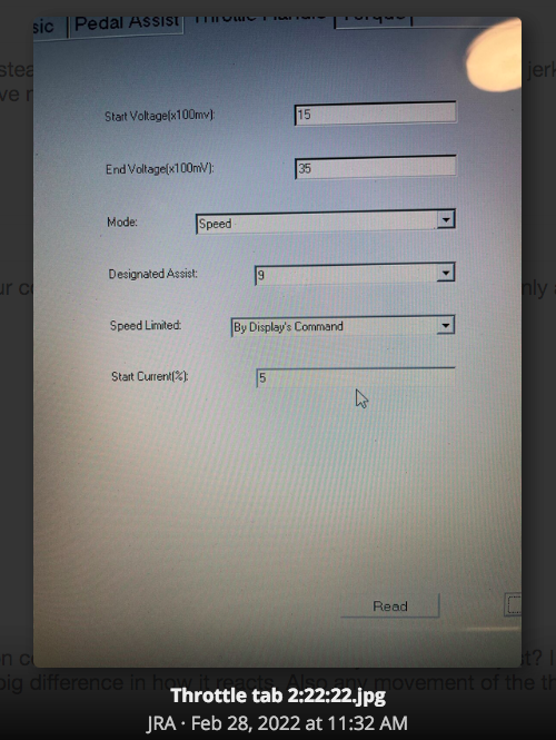

I did in February the first time the OP posted about their throttle problems but here it is again.
My understanding, your settings should be:
  • Throttle Mode: Speed
  • Start Voltage: 15 (=1,5V)
  • End Voltage: 45 (=4,5V) (4,99V w CAV3 stuff)
You're shutting down nearly 30% early from base 'vanilla flavor' - but it should be smooth because you're using 'SPEED' for the mode.
When "Throttle Mode" is set to CURRENT, the throttle grip reacts like a switch - ON or OFF.
When "Throttle Mode" is set to SPEED, the throttle operation is smooth and can be adjusted with the grip.
So, that's 90% of the battle won.
Additional tuning is pretty simple, installing a 470 - 560 Ohm resistor between Bafang RED and throttle BLUE - "otherwise the error 04 is shown very quick (less throttle ramp)." This trick was reiterated a second time - "Some controllers have problems with the full voltage of the poti - a 470/560 Ohm resistor is recommended".
Next, If you add a second 100 Ohm resistor between the BLUE/BLACK and RED/BLUE wires, then you can use the full throttle range.
This will also make the throttle react earlier.

My throttle in fact does have a bit of a list to it. Seems sturdy enough though just after inspecting it for comment. As you can see in the pix that one is straight. I guess I have to fess up to the fact that end of the bars has seen the ground a few times. But it really isn't in harms way unless you maybe dump it into some brush.
As far as the extended design personally I bi-passed that option. The way the inline one works, for me, is while I actuate it with my thumb it is the outer thumbf that gets used not the pad or grip. This allows me to approach the bars with my thumb mostly under the bar for a good grip, getting older you know and don't want to fall of in the first 20'.
The guy who makes them is very easy to communicate with and even has some fun color options available as well as plugs for a few of the most common systems so be careful to stress you want one set for a Bafang if ordering.
Caveat disclaimer is that I have the standard thumb pad type on my drop bar bikes that don't have PAS as they fit the situation better.
