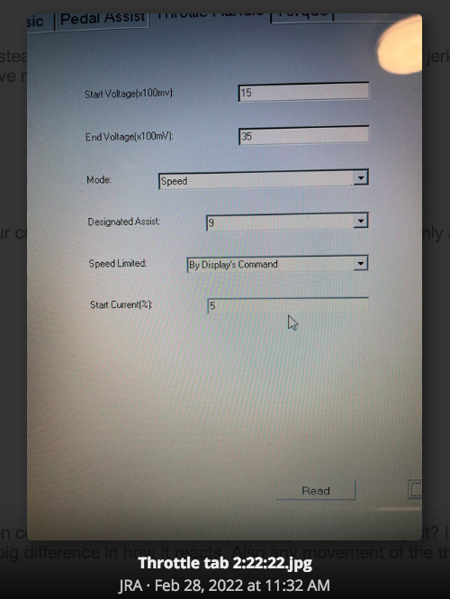

Throttle works just fine on my stock controller UART Ultra bike, admittedly after having to do some tuning via the ability to do so easily, so I don't think it is a Bafang issue personally. Your mentor is off base saying there are no throttles that work well it is how the signal is received and translated in the controller that is your issue.
I did in February the first time the OP posted about their throttle problems but here it is again.
I understood that, wasnt asking for me so much as everyone else
If that works for a lot of stock throttles then we can probably figure out something on the archon
But this stuff is also user subjective , so would be nice to hear from others that have set their stock ultras up like this
