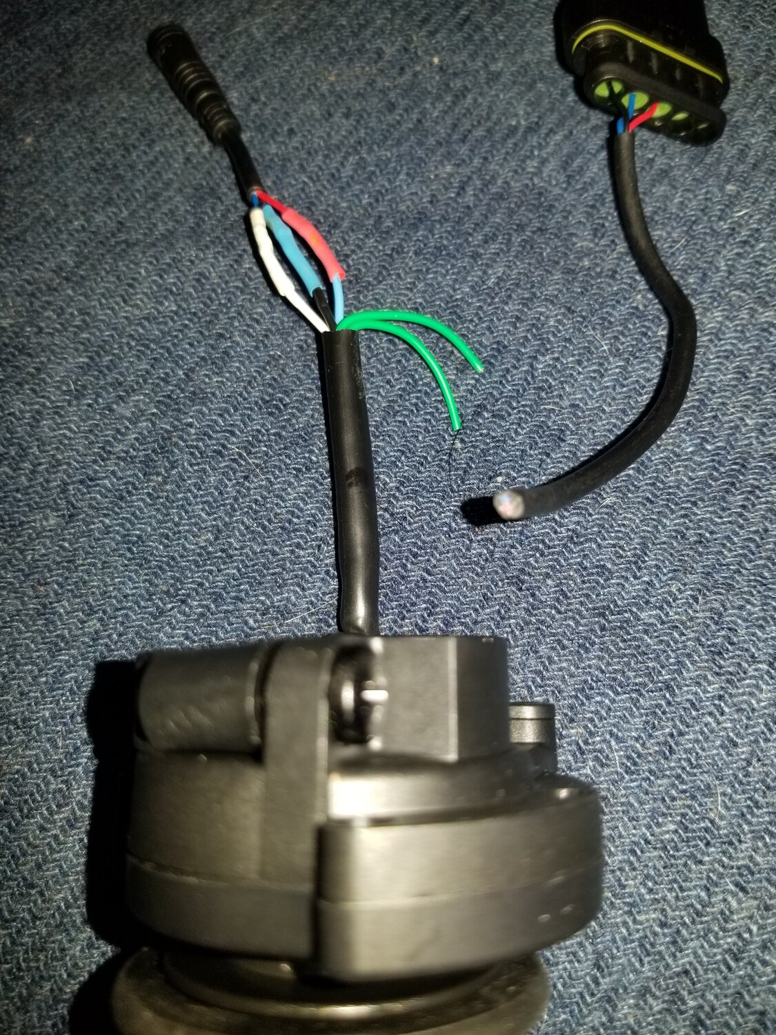

I make my own harnesses so I ordered the required Julet 9mm Base Connector 2Pin Cable Waterproof Connector w/ 1m wires.
It might be one short line from the throttle to the MT5's front brake Julet and a longer one to the rear brake's Julet plug. I may dump the whole connector for spade plugs.
The problem is the Julet plugs clearing the ports into the downtube/ batt compartment. Same issue WW ti bikes have.
My throttle's three (sheathed) wires ( signal, 5v+ and -) will replace my shift cable.

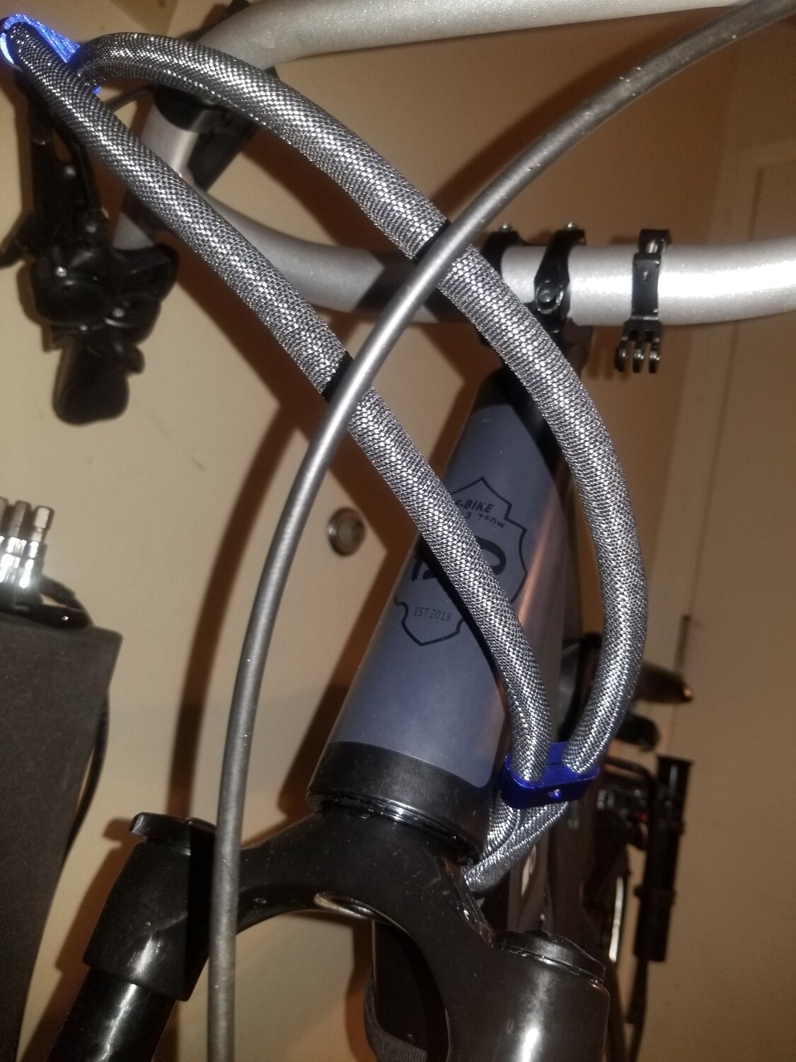

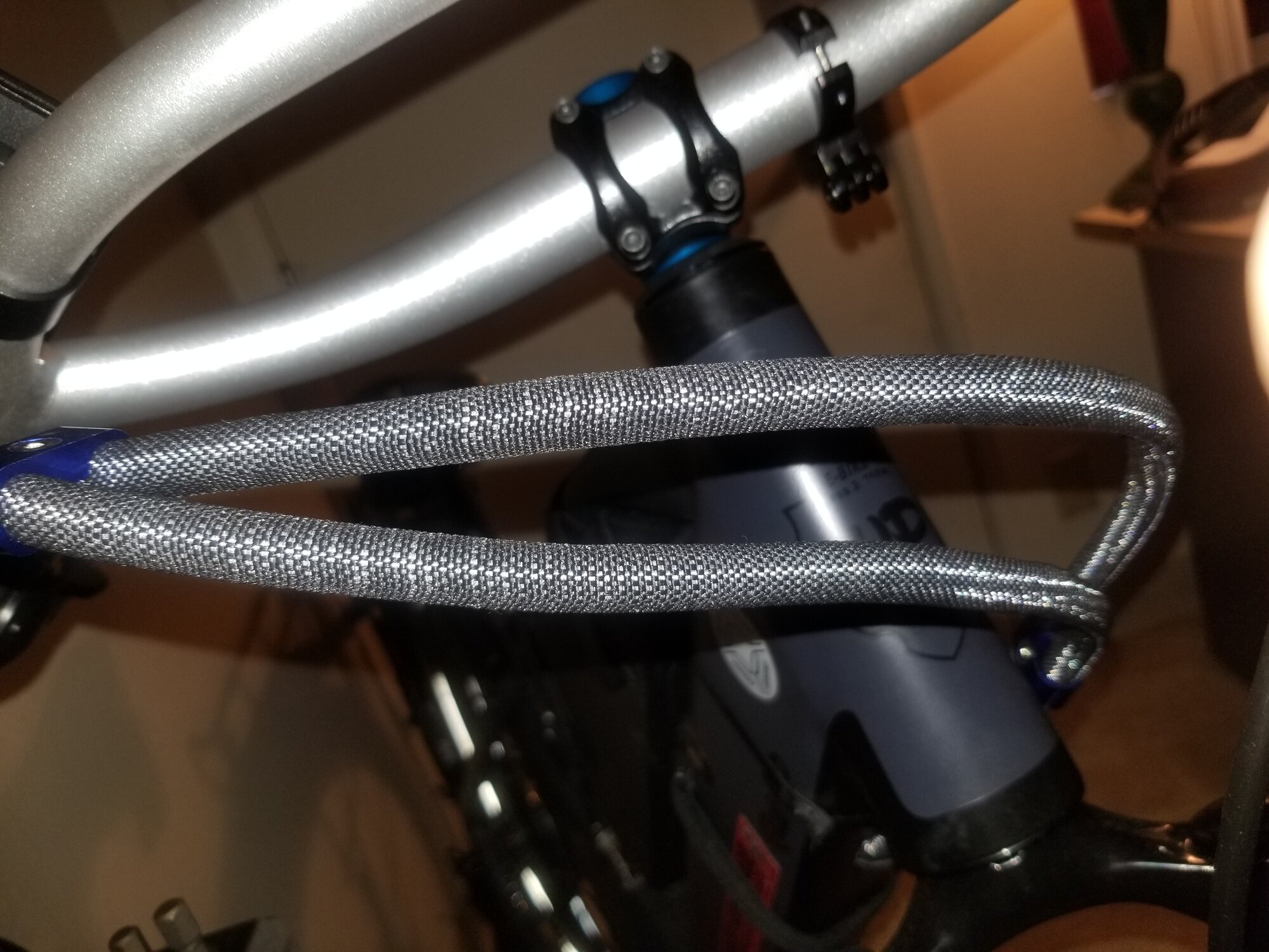

I'm particularly fond of the F6 techflex self-wrapping woven sheathing for my wire runs.
Currently using 3/8" ....
... to house rear brake cable and five display wires in one bundle and the (soon to be removed) shift cable w/ three throttle wires in the other.
The 1/8" size can house up to six AWG26 wires in the same size profile as a shift cable.
If anyone else likes this sheathing, be aware I've used most all their products.
Every 'hook and loop' type I tried was a big FAIL that only added bulk, and the loosely woven types are not so hot - plus much more difficult to seal when cut.

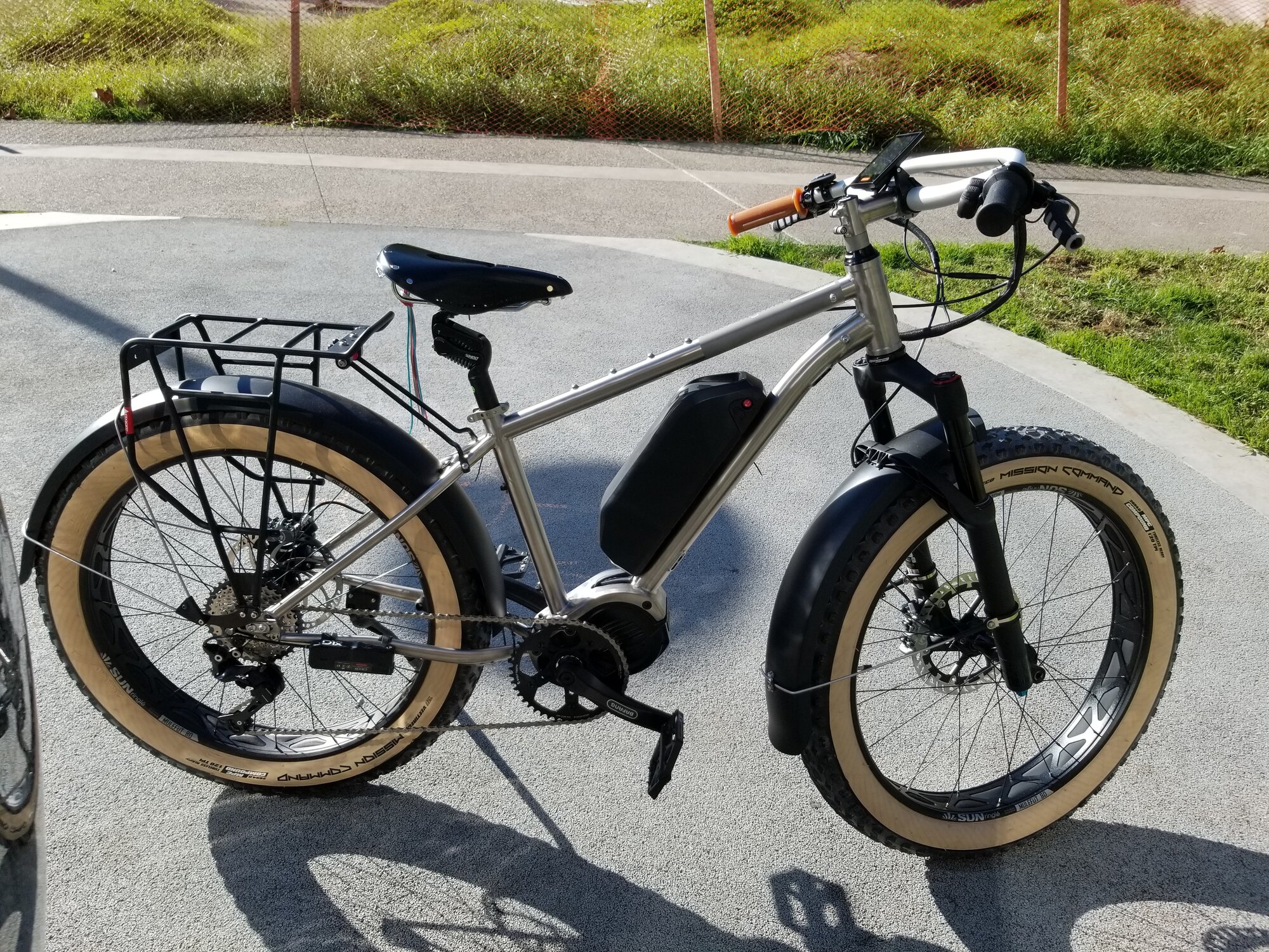

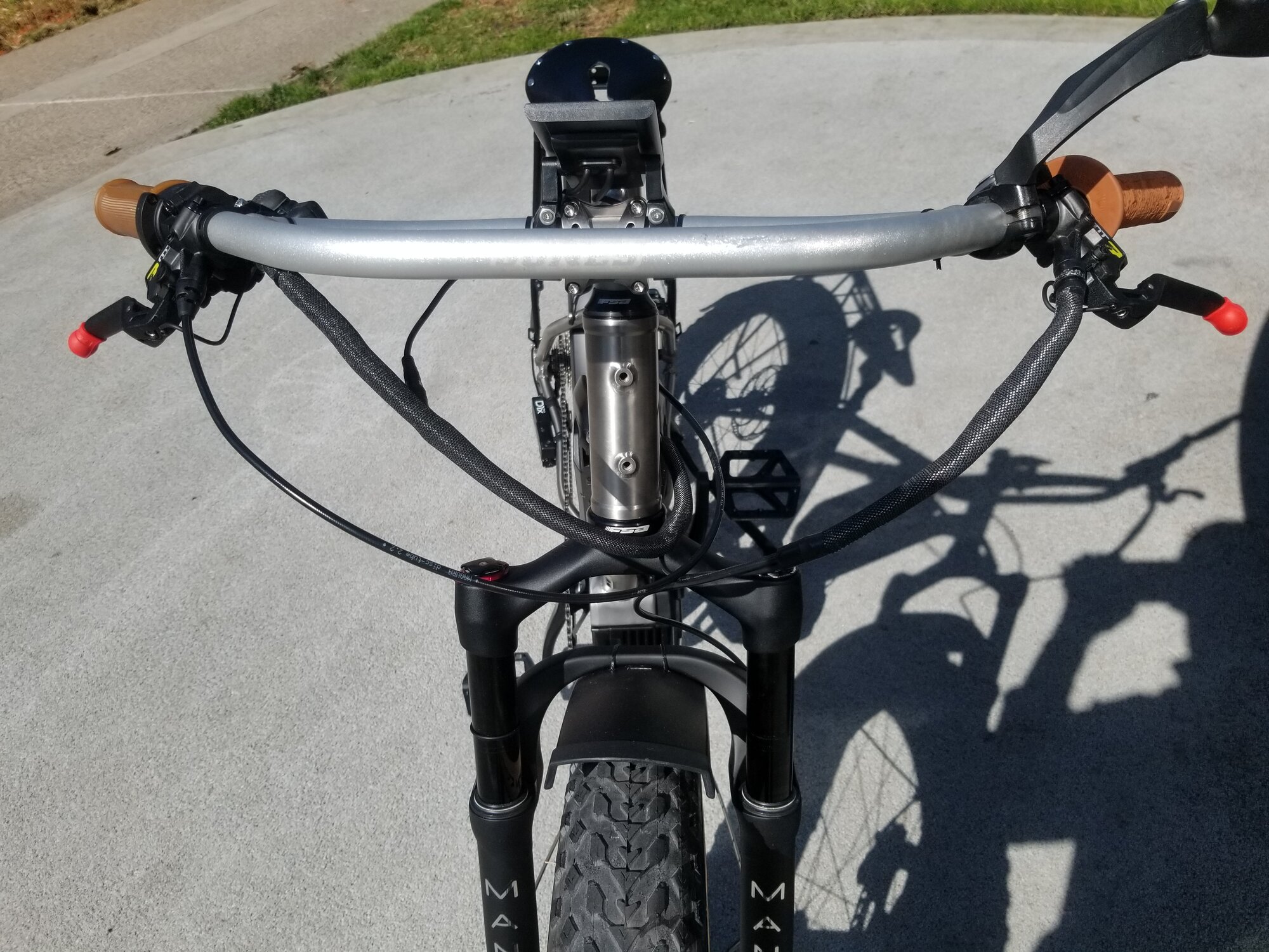

Here's my West Coast WattWagons titanium Cross Tour fattie - with OEM installed Domino's 0 - 5ohm e-throttle.
Great job WattWagons !!!
We concluded an Archer D1x was the only proper ticket.
My wiring changes included dumping that giant plug .
The Archer required a (left) Magura shiftmix adapter to fit perfectly ... Chop chop. Solder and shrink fit to Higo. Green wires go to a 5v cut-off switch built into the bar's ends, under the rubber.
BEWARE: We've concluded only the Archer (legacy) would work.
Any reliable understanding to the contrary, please post it and a photo.
The one and only 'Gumbo Bodacious'

I've ordered the resistors required for tuning and I've installed a nifty on/off switch.
Performance: Great for first 2 Eco modes. A bit jumpy on take-off in level 3.
Sports mode (L1), we have a problem Houston. Yes it'll pull wheelies. Unacceptably jumpy.
An issue's 'the first third of the throttle throw is unavailable' - so you get a sudden jolt to 750watts.
I left it alone. (1) not into stressing the drivetrain like that and (2) not into stressing the drivetrain like that. Resistors will give me full range, so exploring those realms will wait - and I still may disable throttle for SP modes, or not.

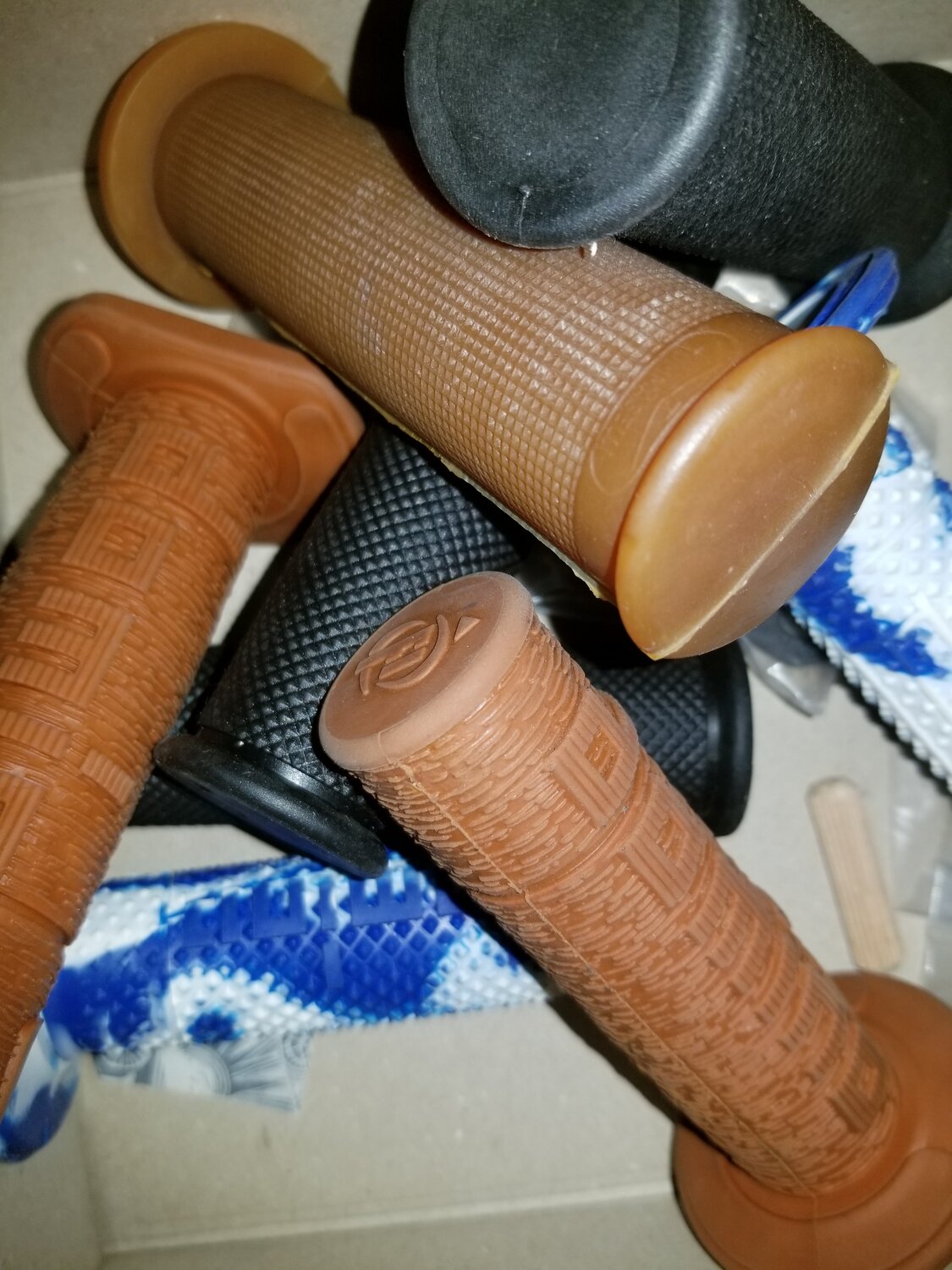

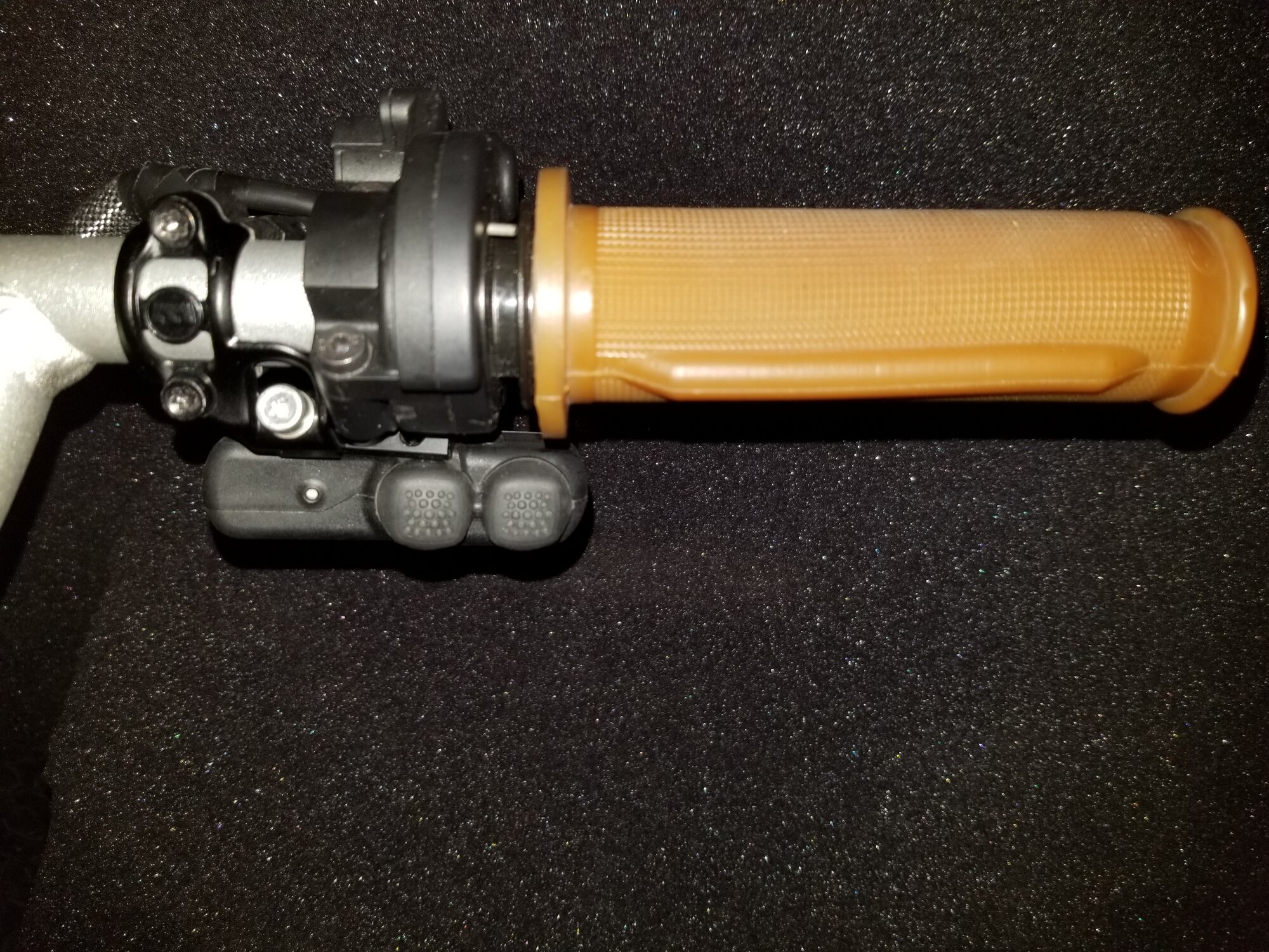

A major reason for a Domino is the vast selection of arguably the best cycle grips ever made.
The good: There's 'hard; hard inner/ soft outer; soft and very soft' cushion styles; various color schemes and thumb-guard variations. Grip is outstanding. Never slip on or mar bars. Extreme durability, 100% waterproof. Minimal weight/ no screws/ clamps required.
Price? Buy 2 - 3 sets of all rubber, Motorcycle grade grips for what you pay for a set of Ergons.
The Bad: You need compressed air to remove them - or just cut off and ruin. You're blessed with a garage, compressor's a must have.
Requires a slender nozzle, under grip, blow up with air and they slide off. Five seconds. Or, you can play Hulk Hogan vs Andre the Giant he-man WrestleMania - probably fail, and 50/50 damaging something.
Expect the left side grip's consequences. To remove Brakes, you must have faceplate, not slide-on clamp levers.
It's an application where one thing leads to another. You come here, expect to change stuff.
No other stock shifter will work.
No other faceplate (including the Archer stock) will work.
Using the correct parts, the wiring must be on top.
You need bars with the real estate.
Those (Gum Color) Daytona Grips are Vintage '80's - hard inside/ softer (but still pretty hard) outer. Did I mention the rubber (esp the older ones) last and last?
