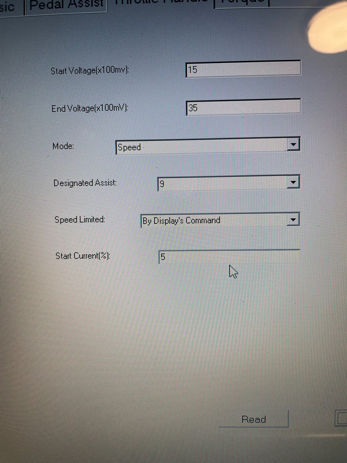

There are parameters within your controller that influence how the throttle responds. Only as an example here is what a UART throttle tab has to offer:
Throttle tab 2:22:22.jpg
I would imagine that your Archon controller has a similar feature that you need to adjust? I know from messing with my settings that even small adjustments can make a big difference in how it reacts. Also any movement of the throttle at other than fully activated will be sensitive no matter what.

Just changing the Mode from Speed to Current would make a big difference.
Also adjusting the Start and End voltages to match your throttle will widen the range
