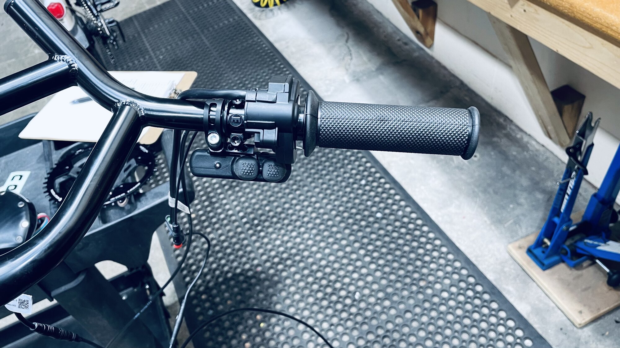

I asked WW if they'd install a Domino twist throttle. Tentative Yes.
When it was time to build, there it was on the build sheet. Saying twist throttles are not the norm for them,
They suggested/ I agreed on the Archer. They sent me a nice mock up shot.
I'll let you know how the throttle works on my 2300watt X1 WattWagon with X1 in the next few days.
The build sheet said "Throttle: Domino Twist Grip 0-5K Ohm Throttle, Standard Firmware Profile".
Drivetrain: Archer D1x Trail 11-Speed Electronic, 46T Front Chainring, 11-40 Rear
Cassette
Here's the mock up from WW

The MXUS has my been my loyal testbed for the next chapter - a factory installed Domino on a 2300watt X1 controlled WattWagon Cross Tour.
I've included the mock-up shot WW sent. The bike's shipped.

WW sent a photo. Bike's sick. Delivery was yesterday, UPS failed.
