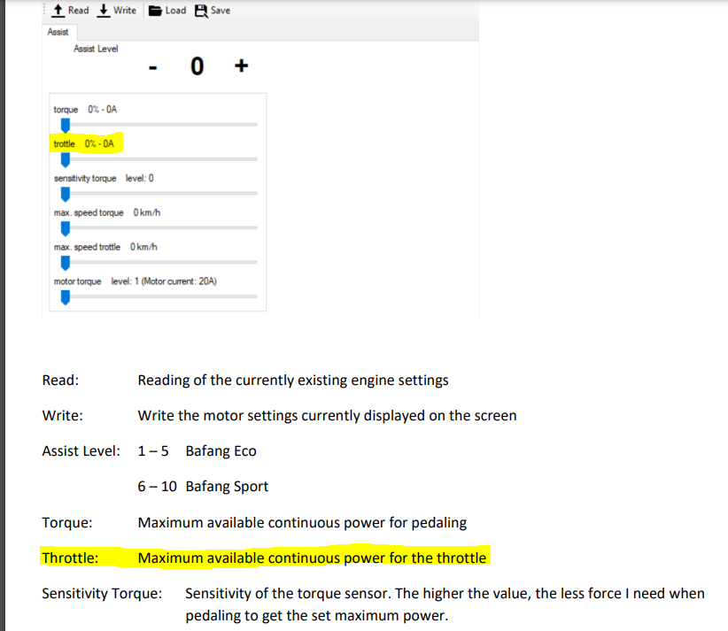

@Fast n' Furious I think you are mistaken - as far as documentation & video shows there is no option in the X1 software to set the throttle signals range like in the Bafang stock software as was being discussed. There is just throttle power, which is as described in the Innotrace documentation. JRA posted what the throttle tab looks like in the stock Bafang software, and nobody with an X1 and an account & programming dongle has chimed in to say this is not the case.
To reiterate the values you describe here are not doing what you posit they are doing... this is setting the max current for the throttle, as described in the above snip from Innotrace documentation. You are thinking of the settings in the stock Bafang software to set the signal range to expect.
Also would like to add, As per Domino's OE page they make both hall effect & potentiometric throttles and it should be noted hall sensors can be made waterproof and are non-contact meaning there is no wear. A potentiometer will eventually fail, and you're not guaranteed a 0V output when it fails. To quote someone in the E-S thread you linked 'they are both just variable resistors, one uses a magnet and the hall effect, the other uses a potentiometer' - all you are doing is taking an input voltage, and giving an output voltage (signal) for the controller to read. The controller's software is telling it what voltage values to use for signal range of 0-1 to interpolate between 0-100% output power. The potentiometer has the benefit of having its own friction/damping as a result of how the switch functions (mechanical), which no doubt lends to the smoother feeling by helping combat PIO that Jes mentioned and providing some resistance the user can feel. The lack of damping/friction in a hall sensor throttle can be compensated for either mechanically in the design of the throttle (as is probably the case in the Domino hall sensor version) and/or in the software via smoothing - but the latter comes at the cost of responsiveness unless the software distinguishes larger jumps in input from what would be assumed to be PIO.
Let's do a little exercise here, assuming you have a throttle that outputs 1.5-4.5V through its range. Keep in mind this is an oversimplification for illustrative purposes, there may or may not be functions in there to handle backing off the power at speed as well - but judging from Deacon's experience probably not.
when throttle output = 1.5, throttle_input = 0; when throttle output = 4.5V, throttle_input = 1 (this is not how it would be written in the software but this is how the software would interpret these values)
throttle_power = 30 (this is set by the user, to be 30A - try not to get bogged down be semantics, when we talk power in amps we're referring to power output at that current at whatever battery pack voltage is supplied)
max_throttle_speed = 40 (this is set by the user, to be 40kmh)
Current setting: while current_speed<max_throttle_speed, throttle_input*throttle_power=power_output (so if the throttle uses a linear variable resistor, at 25% of the throw on the throttle by the user, we would see 0.25*30=7.5A value for power_output, as long as the bike is below the max_throttle_speed)
Speed setting: if throttle_input/max_throttle_speed>current_speed then power_output=throttle_power (so if the throttle uses a linear variable resistor, at 25% of the throw the power_output will be 30A until the bike reaches 10kmh)

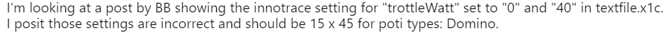

But no matter. 4.0V is still the wrong setting (there he goes again) across the entire Bafang range (ouch, he's worse) and I posted Austrian, FastBikes as a ref showing the correct ones from Domino.
Unless it's a 36V, JRA's motor can barely gasp along @ 40V. But his throttle is set to top out at that 'barely gasping' 40V ?

BB has published the new version too. The setting is still absent as well.
From listening to the behavior WW owners describe, innotrace can could be set to either to "Speed' or "Current", or it could set itself to the correct setting with a poti throttle.
That level of programming is there, but unavailable to users unless you have 'admin' privilege's.

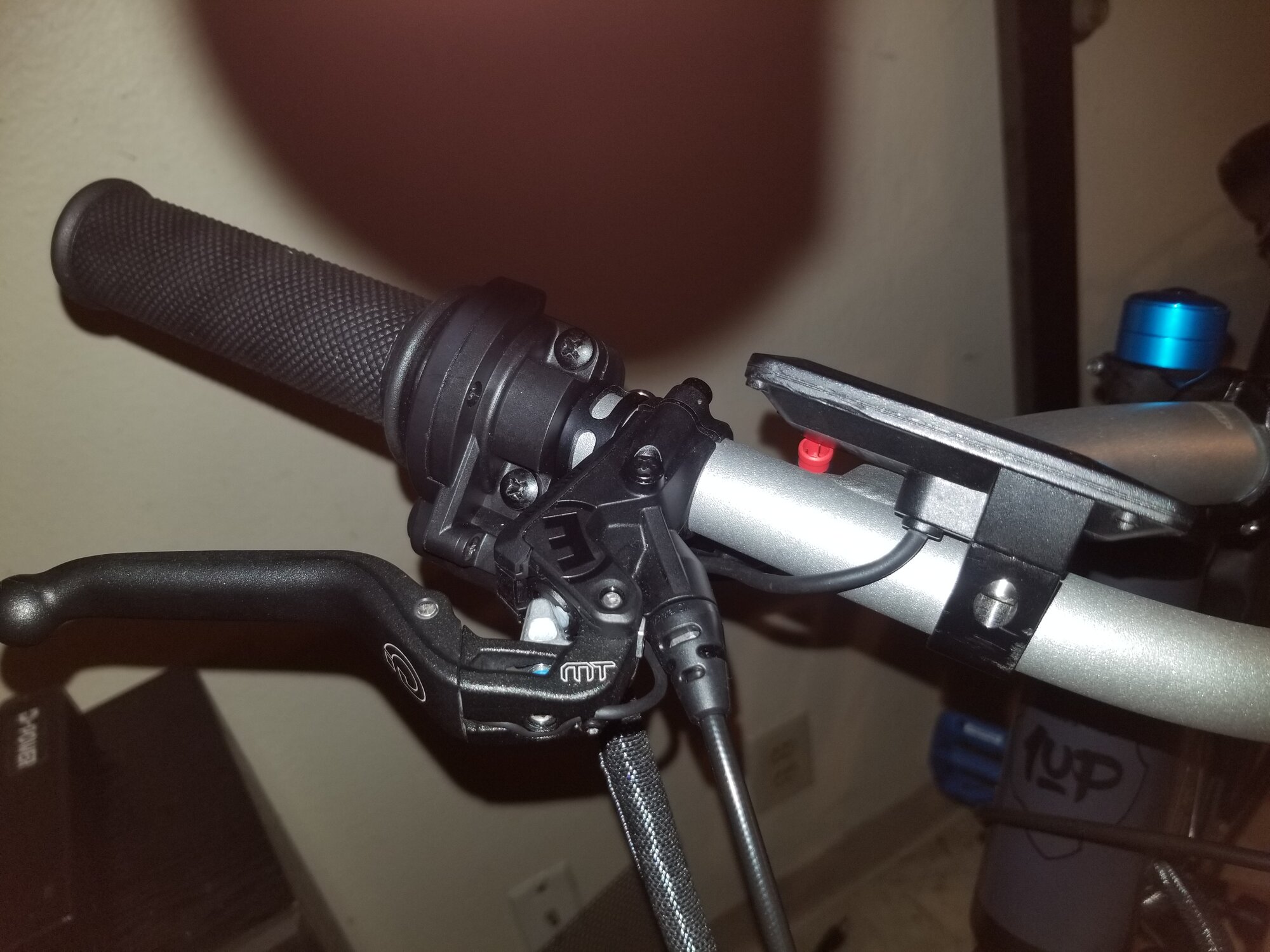

I'm in the process of finishing up a Domino 0 - 5ohm, ip67 throttle installation on my 1000watt, MXUS rear hub bik , but it's only part of the projects upgrades that include Magura MT5e's and MDRP's rotors and, Archer D1x wireless shifting and a new cassette and Box derailleur.
Blew it again too. My math was impeccable, so I purchased a 220mm MDRP disc and correct adapter.
No fittie 😵‍💫? The mount on my new fork is 160mm, not 180mm.
I saved it for my (soon, soon, soon) WattWagon's and ordered a 203mm.
It appears the WattWagon will also have a Domino.
I'm three cables, one's 1.5 x fatter - to hide the three wire throttle cable and five wire display cable. Mounted on the bars it does resemble a motorcycle's.
My method of figuring out the wiring's simple.
A VOM. Three (relevant) throttle wires. Three Controller wires.
Bike on: At controller end (VOM @ 20v) one wire tests 4.9>, the other two (ground and signal) test like grounds.
Bike off: Connect the 5v (4.9>) to Domino's Blue wire. Connect the Domino's Black to another wire and the White wire to the remaining wire from the controller.
Turn bike on - rear wheel off the ground: Test the throttle. If the throttle works perfectly, it's correct w/ Black and White wires.
If the throttle takes off uncontrollably, I shut bike off; reverse the two wires ; retest - and works perfect.
If I get them wrong I'm applying 'ground' to 'signal'. No biggie. It's just 'on'. Normally, the potentiometer does the same thing, in metered amounts - per your input. Wired wrong, you can stop it with your brakes, let off it'll start right back up.
The Domino throttle
It's 155mm (total body/grip length) BIG. A long, 123mm grip and 32mm body.
Lot's of variations in mounting, with (depending where you rotate it) flat areas providing clearance for wireless things and brakes. Not for my old Shimano shifter though. Needs a real 'matchmaker'. The Archer's mount has clearance that allows fitting the shifter buttons 18mm under the body - exactly where my thumb goes, but space gained by most placements assure the wires are more prominent - rather than say, under the brake lever.
The Magura levers play nice. Fit's great.
Another warning: No 'twist grip' throttle body should make contact with any other accessories controls. Tightening down while touching can/ will lead to a very slight 'warping' effect and intermittent cut-out/ run-away throttle effects.
Domino's return action (1/4 turn) is fast, strong and sure. It takes some force to twist. If you notice any play, it's not tightened down correctly.
Unlike other twisties I've tried that actually require you push them on tightly to interface the throttle firmly with the bars, you can push the Domino on too far and creating drag on the grip's. They're soft and you can feel when the bar's ends are poking the rubber. Bars ends/ Rubber should not touch.
It's well made (but has Phillips Head bolts I'm sure I'll change out) and the grips are super comfortable rubber, easily replaced.
The domino's 22awg wire is easily soldered to my 22awg wires w/ 3 pin JST's fittings (eBay, readymade for LED's).
My controller has 24awg.
The Higo's are 28awg ?
I'm not alone in noticing that using 22awg from throttle to controller 'feels like' a noticeable performance increase over the 28awg.
I'll post some photos and the results of my resistance check/ the resistors, should I install any.
It's Frankenbike right now. Still have to finish the Archer set up and I need a longer cable.
The Domino will be real sweet on my titanium WattWagon's Ultra, with the ti Jones H bars I have planned. Quite similar to this set-up.
An Archer D1x will likely end up on the WW too. It's just more realistic to replace a reasonably priced derailleur/ cassette and have separate electronic shifting than to go with fancy Sram or Shimano on parts that will certainly wear out - quickly.
Ride on
Fn'F

So you say that Neither "Current" nor "Speed" settings for throttle are available in innotrace - my focus"... So why do you keep mentioning them?
You spend a great deal of effort explaining ON/OFF when Current is used yet you can't change the setting?
If you found some work around for the X1 controller... Great.
But be clear about it then because you couldn't be more wrong when talking about the Bafang controller and its available settings and what works best for the desired results wanted here.

You're right Bro. I checked w/ BB on that and certain parameters are unavailable
But that nobody with an X1 and an account & programming dongle has chimed in to say this is not the case" re: JRA's post is incorrect.
JRA say's himself that this is not for innotrace/ WW etc. He was just being helpful, a good guy and showing what worked for him. That's no a WW and not and Ultra G510.
It was pretty cool he went to the trouble of repeating himself, but he stated the caveat, not wanting but giving. 'Ol bigmouth (here) had to go and say "those settings are incorrect". Maybe he will try 49V and it will help him.
His bikes programming parameters are slick, with proper permissions. Best I've seen
You even ride your bike down to 40V, I pity your batteries - soon to be deceased.
Your BMS signals 'low voltage' on weakest cell while trying to balance. When 'Low V' threshold is exceeded (in one rat cell), the BMS will refuse to charge the rest. The differences in V between the cells keeps up a power drain even when parked, while the BMS seeks equilibrium.
2.8V is well within published 'Dead' threshold specs used in BMS programs for some Samsung 18650's I have.
That's 40V in a 14S4P 48V pack. I'm at 50V right now. 44 - 46V I'm on the charger.
I never risk one 'needy' cell killing my pack. That's another topic - well described Gospel by our (MIA) resident electrician from San Diego East.
49V on top is published as correct.

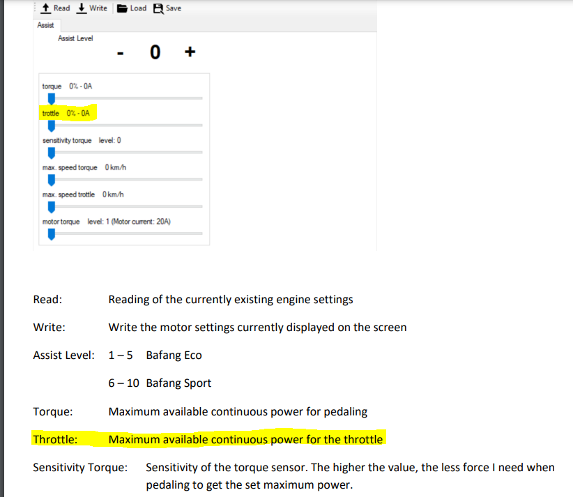

Most likely, innotrace default is "Speed" and the rest is that thumb throttle are simply garbage.
I say that because my present bike denies access to those paremiters and thumb throttles all failed, while the grip twist types work well.

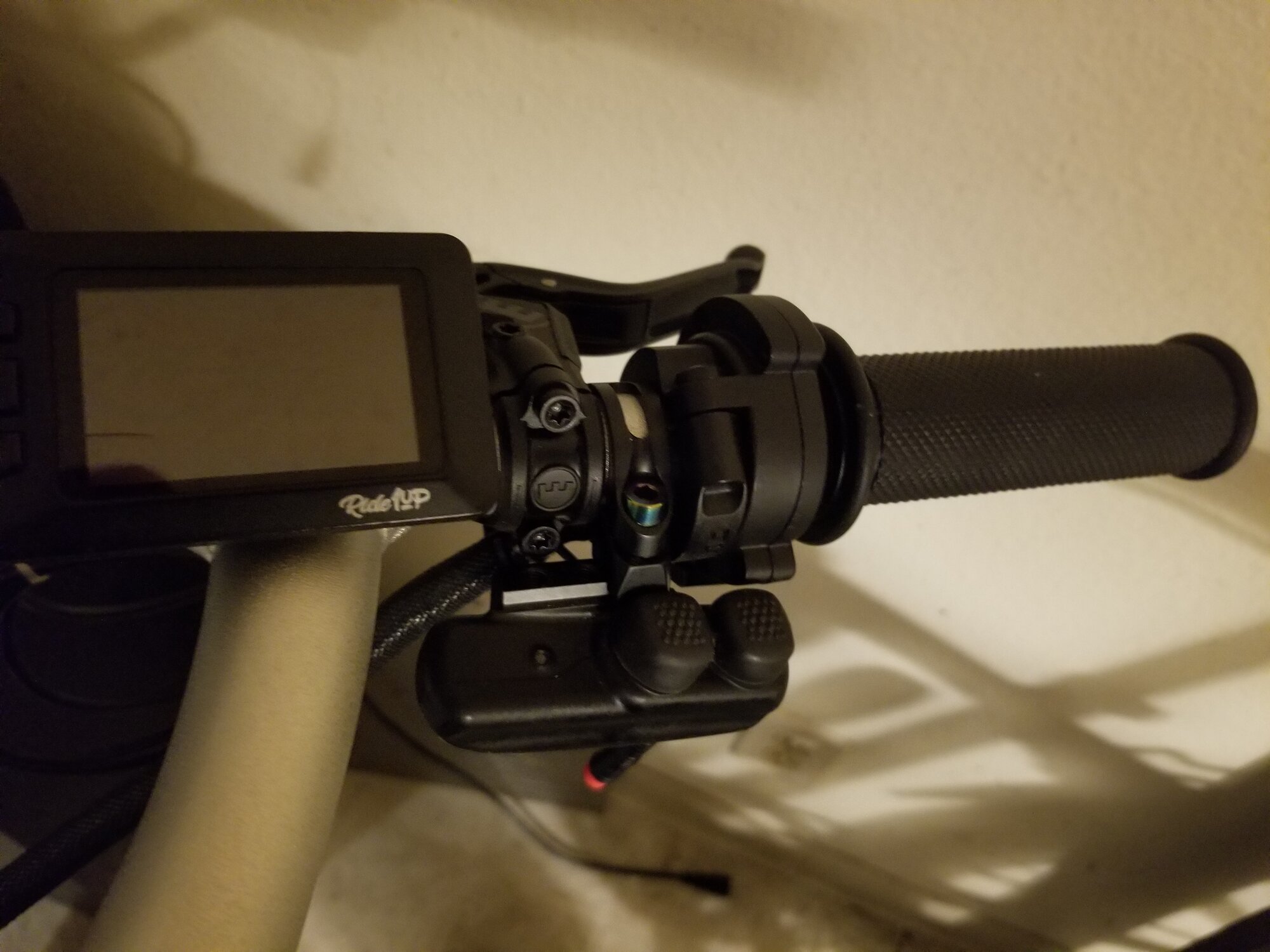

Throttle update:
As some of you may already know, I have a UC Pro and a Hydra and both, as far as I know, have the same Archon X1 controller, motor, and throttle.
The Throttle (as I've mentioned in this thread) on the UC Pro is terrible, but the throttle on my Hydra is excellent. o_O
I used the throttle on my last ride on the trails and on the pavement and it worked perfectly......go figure.
