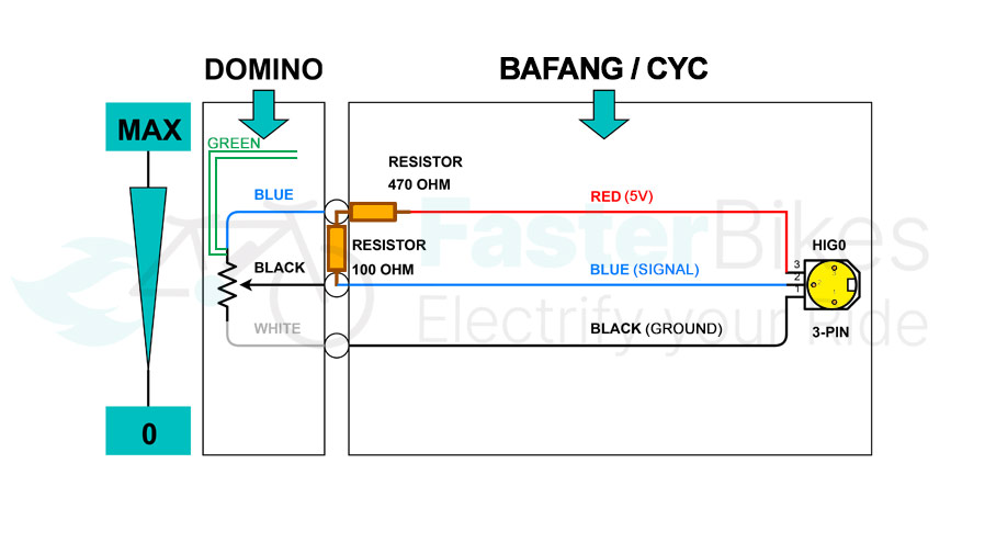

Typically one accesses and sets the Controller settings (@Throttle tab) to the following values:
  • Throttle Mode: Speed
  • Start Voltage: 15 (=1,5V)
  • End Voltage: 45 (=4,5V)
(When "Throttle Mode" is set to CURRENT, the throttle grip reacts like a switch - ON or OFF- it's jerky.
Set to SPEED setting, the throttle operation is smooth and can be adjusted with the grip).
A 0 -5 k twist throttle also requires a 470 -560 Ohm resistor between Bafang RED and Throttle BLUE - otherwise the error 04 (decreased throttle ramp) comes up very quick.
To create a more instantaneous response (like for a Sur Ron) and increase the range to 100% you add an additional 100 Ohm resistor between the BLUE/BLACK and RED/BLUE wires
To create a more instantaneous response (like for a Sur Ron) and increase the range to 100% you add an additional 100 Ohm resistor between the BLUE/BLACK and RED/BLUE wiresView attachment 130910.

I don't know which throttle you are using... But I have the complete opposite experience with a BAFANG compatible half twist.
First setting to Current over Speed results in a fully variable and linear response as setting to Speed takes into account if you are moving and if so clips the range until you match the throttle output to the speed. If you are not pedaling and set to Current the power is 0 giving you full range to your max current setting.
Additionally the 04 error means that your voltage setting is out of range for that particular throttle. When tested my throttle gives me a range of 0.9v to 4.0v...so the correct Start and End voltages are that. Setting a lower number on the Start V yields the 04 error... a higher number clips the first few millimeters of rotation with no output. Setting a lower number on the End V results in a faster ramp rate and a higher number clips the ability to reach full output.
So I really don't think there is any reason to add resistors if you test and match the Start and End V to your throttles range.... ymmv
That's been my experience on the power vs. speed setting as well. When set to "power" the bike's current speed is totally out of play, as are any changes in power as the bike accelerates up through it's capabilities.
Throttle is simple. It needs to be set for the range available for the throttle in use. If you want to get maximum resolution, go ahead and mess with it. If not, set it at the default 15 and 45 and move on....

1) Connection with Bafang BBS01/02/HD or CYC Motors (with BAC controller):
Domino ThrottleBafang / CYC
BlueRed (5V)
WhiteBlack (GND)
BlackBlue (Signal)
2x greenignore
Wiring:
bafang-domino-wiring
You have to connect a 470 Ohm resistor between Bafang RED and Domino BLUE - otherwise the error 04 is shown very quick (less throttle ramp). If you add the second 100 Ohm resistor between the BLUE/BLACK and RED/BLUE wires, then you can use the full throttle range. This will make the throttle react earlier. If you don´t want this behavior, you can simply remove the second resistor (100 Ohm). You can find the Bafang throttle wiring (same as CYC throttle wiring) in our download area.
Adjust Bafang Controller settings (Throttle):
When "Throttle Mode" is set to CURRENT, the throttle grip reacts like a switch - ON or OFF. With SPEED settings, the throttle operation is smooth and can be adjusted with the grip.
2) For Adaptto and Domino:
Brown +5V1x Green AND Blue
Black GNDWhite
BlueBlack
White E-brake/SwitchGreen
By using Cycle Analyst V3 you have to set the Fault Volt to 4.99V.
Some controllers have problems with the full voltage of the poti - a 470/560 Ohm resistor is recommended. There is a connection of the switch, when the throttle is twisted and no connection when released.
More information about Domino Throttle (specification) can be found in our download area and here:

This throttle uses a linear potentiometer (IP67). In addition a built in microswitch is integrated, which can be connected as brake cut off and/or regenerative braking. A second handle for the other side is included.
Blue: 5V
White: GND
Black: Sensor (Potentiometer)
The green wires are for brake/power interruption - it can be ignored. If you want to use it, you have to connect one of them to the 5V wire.
BlueRed (5V)
WhiteBlack (GND)
BlackBlue (Signal)
2x greenignore
Wiring:
Black GNDWhite
BlueBlack

See: https://fasterbikes.eu/en/accessories/throttles/203/domino-premium-full-twist-grip-throttle
"Some controllers have problems with the full voltage of the poti - a 470/560 Ohm resistor is recommended".
"You have to connect a 470 Ohm resistor between Bafang RED and Domino BLUE - otherwise the error 04 is shown very quick (less throttle ramp). If you add the second 100 Ohm resistor between the BLUE/BLACK and RED/BLUE wires, then you can use the full throttle range. This will make the throttle react earlier. If you don´t want this behavior, you can simply remove the second resistor (100 Ohm). You can find the Bafang throttle wiring (same as CYC throttle wiring) in our download area."
