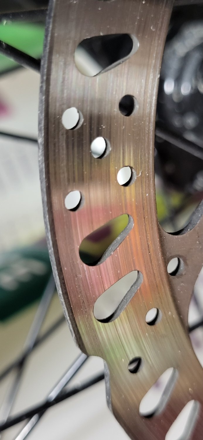

My rotors are Pretty Groovy, but I just replaced the pads so the brake lever doesn't hit the handlebars,..
The lip on the edge of the rotor is only a mm or so on each side.
Lots of meat left.😁

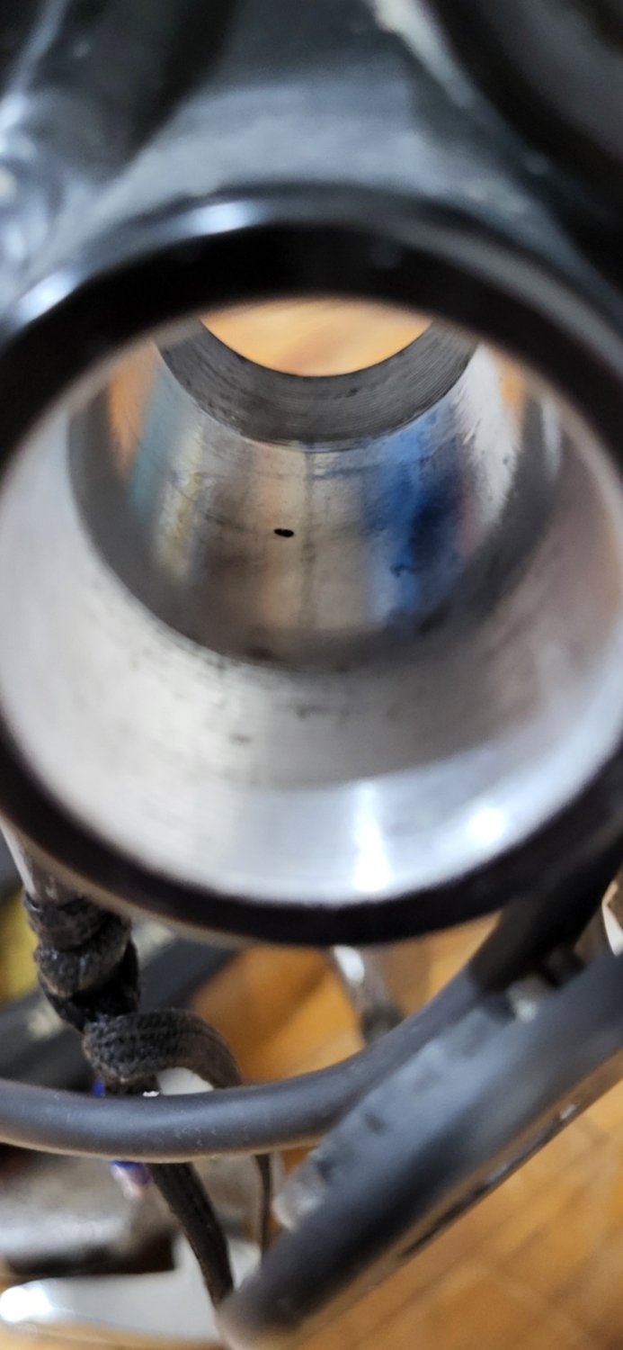

A sloppy rinse once ended with water running down to my bottom bracket on the inside. The bottom bracket bearings went on to fail at only 1,500 miles.

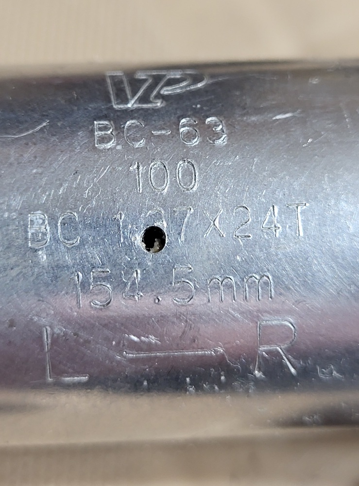

I drilled a hole through my bottom bracket on both my ebikes to drain any water,..
When I spray oil down the seatpost tube, it drains out the weep hole.
All the frame tubing drains into the bottom bracket.
Even condensation can accumulate over time and drain into the bottom bracket.
The sealed bearings don't stand a chance when they are submerged.
The heating and cooling of the BB sucks the water past the seals.

The BB is a pretty tight fit, and I ended up drilling into the BB,..
Ohh well, I'd rather have a hole in it than have it half full of water.
I can use the hole to squirt oil up in there. 😁

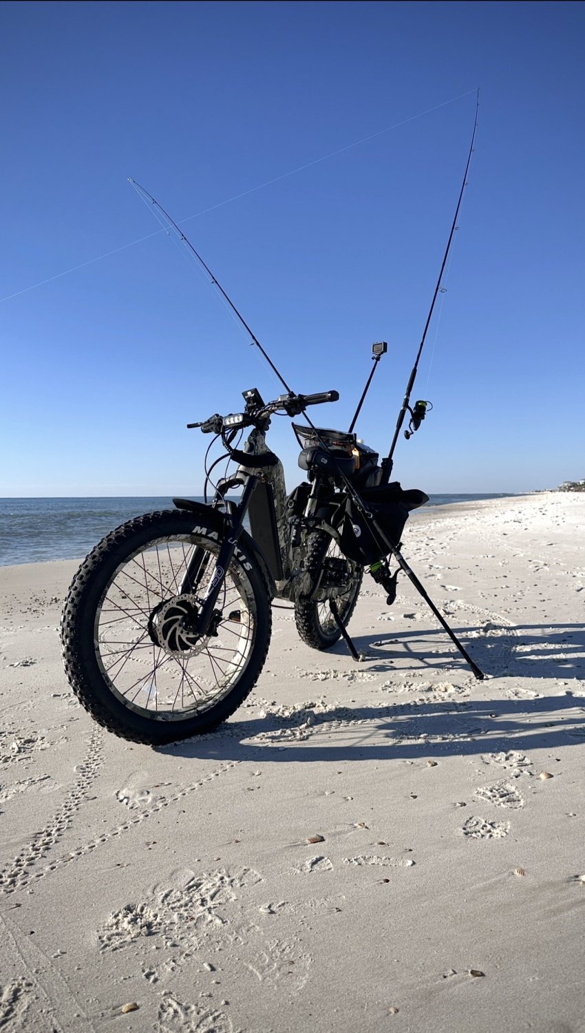

I ended up not taking any of my e-bikes on the 2023 trip. But…I did pickup a fat tire e-bike specifically for beach trips in 2025 and it worked phenomenally well.
I’m generally not a fan of Rambo e-bikes, nor am I a fan of cadence sensor bikes, but if you want a beast that will power through the deepest softest sand (with a bit of driver skill involved), look no further than the Rambo Hellcat 2.0.
AWD 4ā€ fat tire e-bike, 1,000W hub motor on front and 1,000W hub motor on rear, with a full suspension. I got the step through model, much easier on and off access on uncertain beach terrain.
Worked amazing. I spent a lot of time rigging up a beach cart to pull with it but I didn’t need it, I was able to carry everything I needed on the bike.

I'm almost positive that I can never "seat" my brakes properly to get that thin layer of brake material on the rotors, because it constantly gets sanded off?
My brakes always work fine, and I can throw myself over the handlebars easily with one finger on the front brake.
My brakes work good enough for me, even if they never get properly glazed.

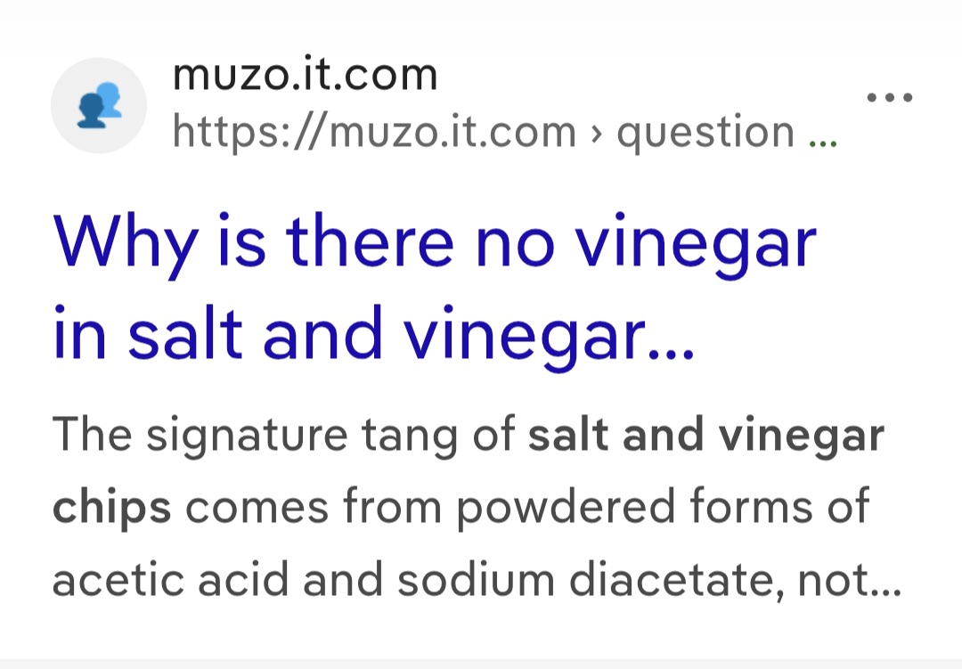

I couldn't figure out why it tasted like Salt & Vinegar Chips, so I did some research when I got home.
I knew that Salt & Vinegar Chips don't really taste like vinegar, so I wanted to know how they make Salt & Vinegar Chips.

Is your local sand abrasive volcanic glass?
Excellent question! Short answer: Little if any here in San Diego County, but plenty of other sand components (especially quartz but also magnetite and hornblende) capable of scratching at least mild steel.
Ability to scratch a hardened stainless brake rotor is the real question here. LBS said I still had pad left on all pistons, so there was no metal-on-metal action. Something in the sand itself did my rotor damage, but it probably wasn't volcanic glass.
Implication: Worldwide, quartz grains dominate light-colored beach sands. Assume that your beach sand's capable of scratching your rotors until proven otherwise. Ride on it only when you're sure that you can keep it out of your brakes.
In my case, that happened only once in dozens of beach rides, and never on sand that was damp but not wet.
