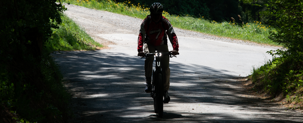

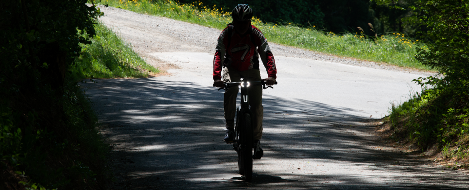

Question to ST5 owners, my ST5 lights are on all the time, I can switch to high beam but I can’t turn off the lights and there doesn’t seem to be a mode with just the running lights on (I’m not referring to the U light on the frame) Is this how yours operates as well?
In Europe, every motorcyclist switches on the light before driving. To be seen is very important for their own safety. As fast electric bicycles have often the same type of lighting as the slow ones, they might be misunderstood as slow ones - with horrible consequences. But not a Stromer ST2s or ST5! These bikes have a signature lighting which tells the car drivers: pay attention, a fast vehicle is approaching.
In what circumstances are you riding your ST5 that you would skip this safety feature?
Thanks for your response, im fine with the light being on while I’m riding but sometimes I’ll stop somewhere like a park for example and because the light is so bright and blinding everyone I wish I could just turn off the light with the button instead of having to turn off the bike.
