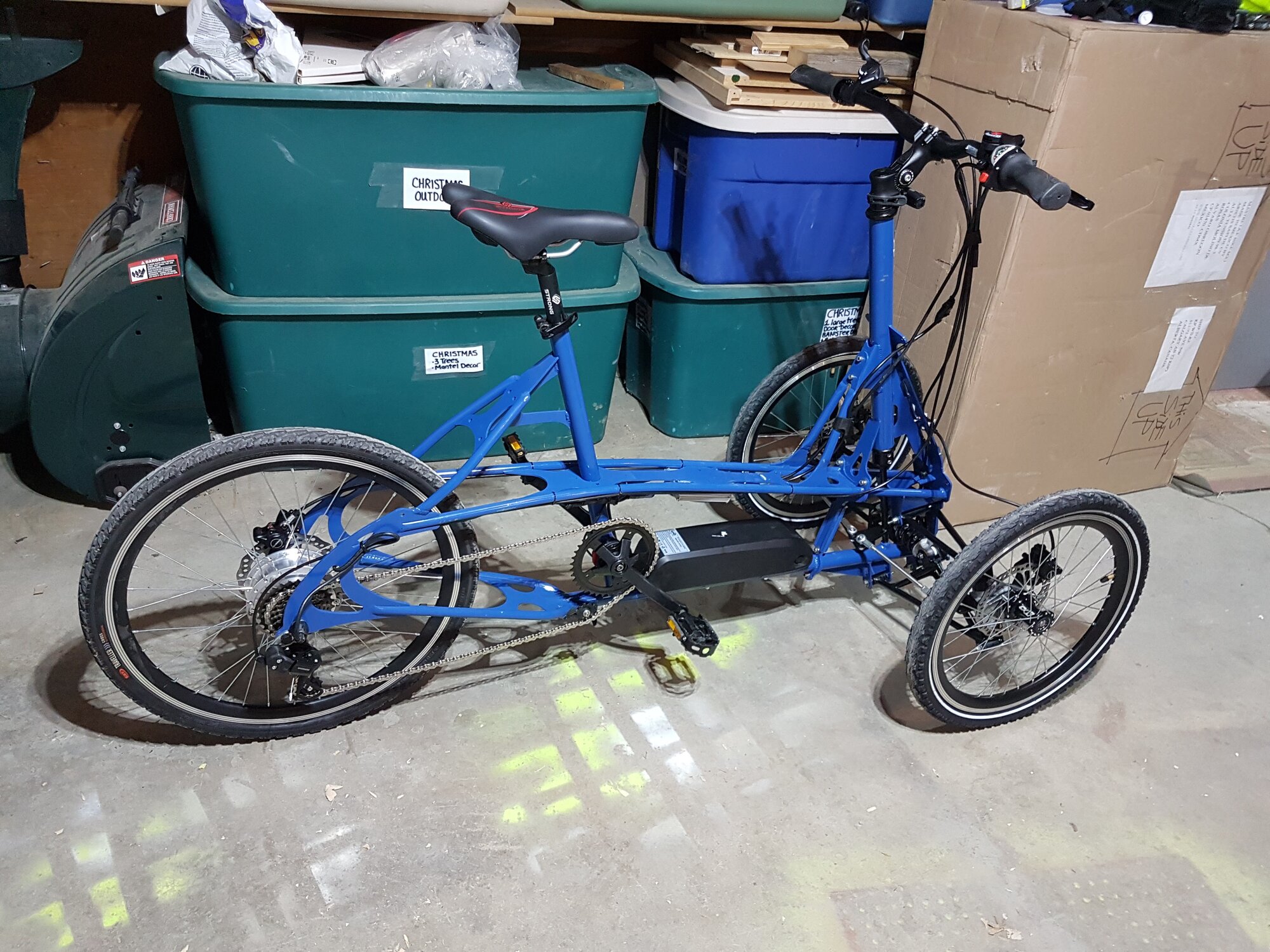

Thats a cool looking buy Randall, do you have any information on it so we can try them out?
Click on the word Webpage in my post above - it will take you to the manufacturer.
Price is around $2700 USD. I will be posting more in the "Ebiking With Disabilities" sub forum in the near future.
The thread "The Joys of MS" will have more build pictures and hopefully more info about putting it together etc...
This is my wife's - she has MS and her balance no longer allows for a normal e-bike.
She used to ride a BionX Hub driven Townie.
