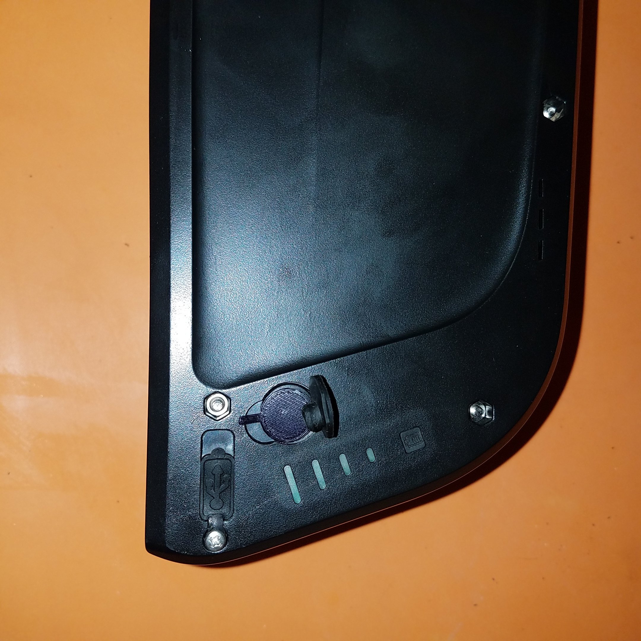

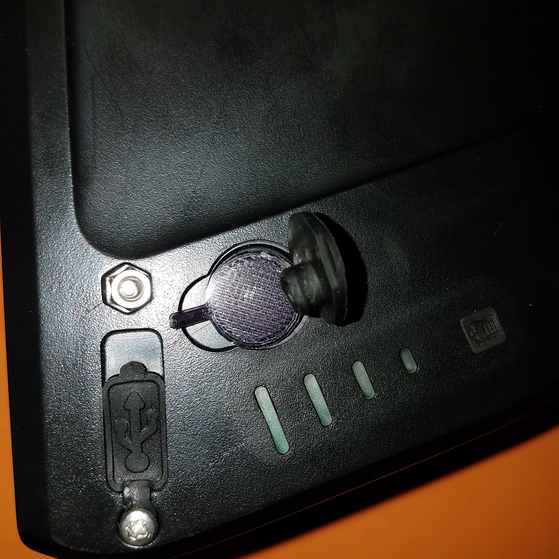

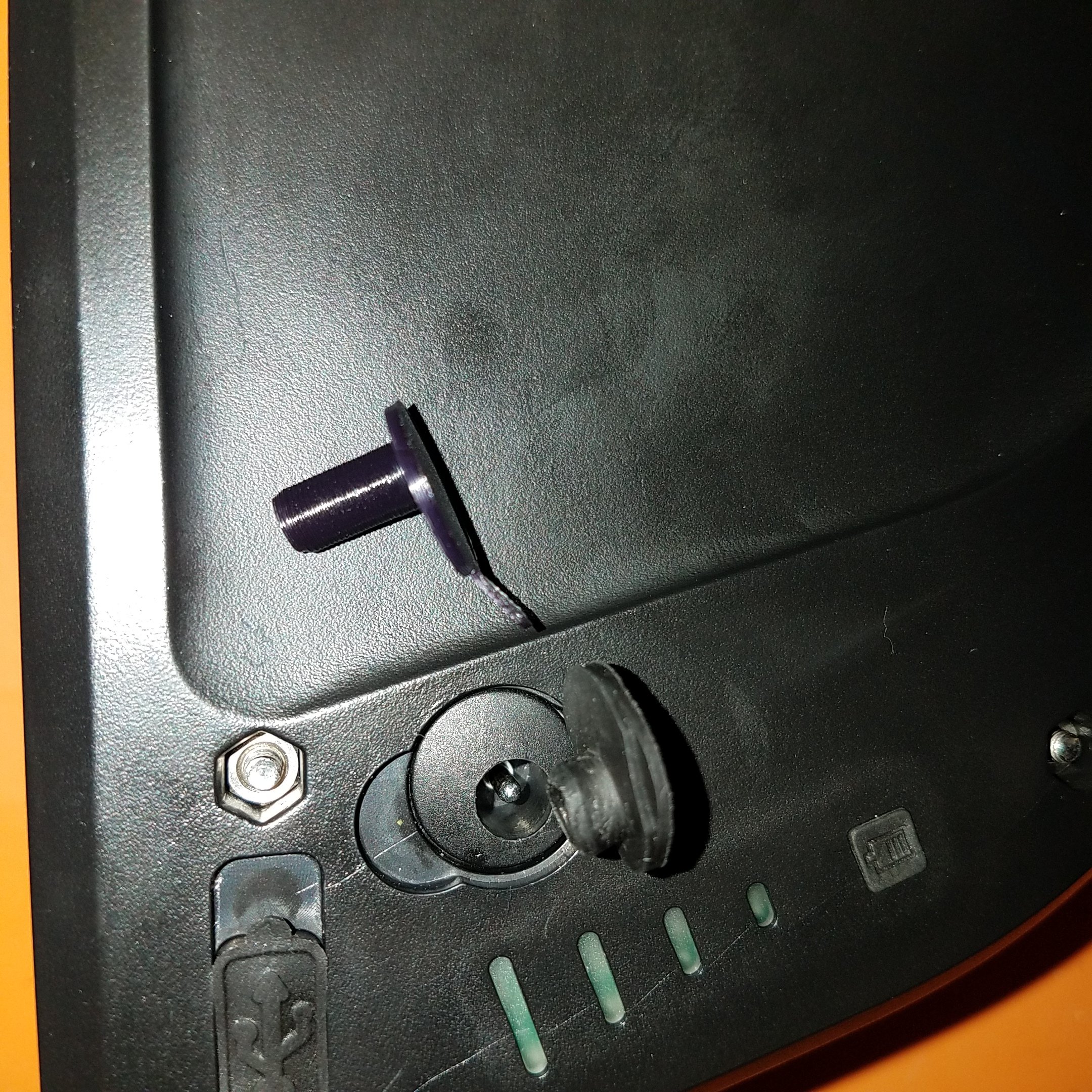

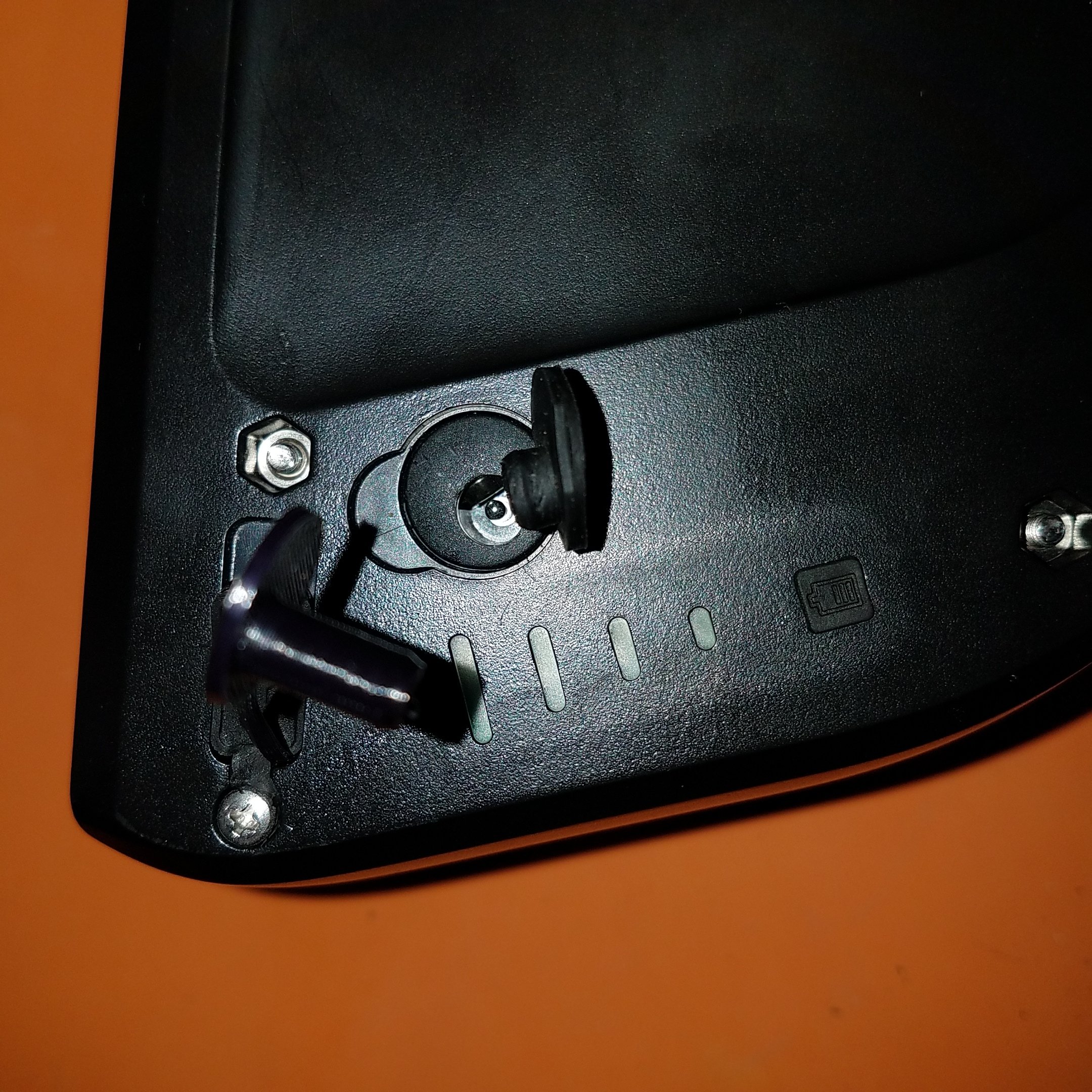

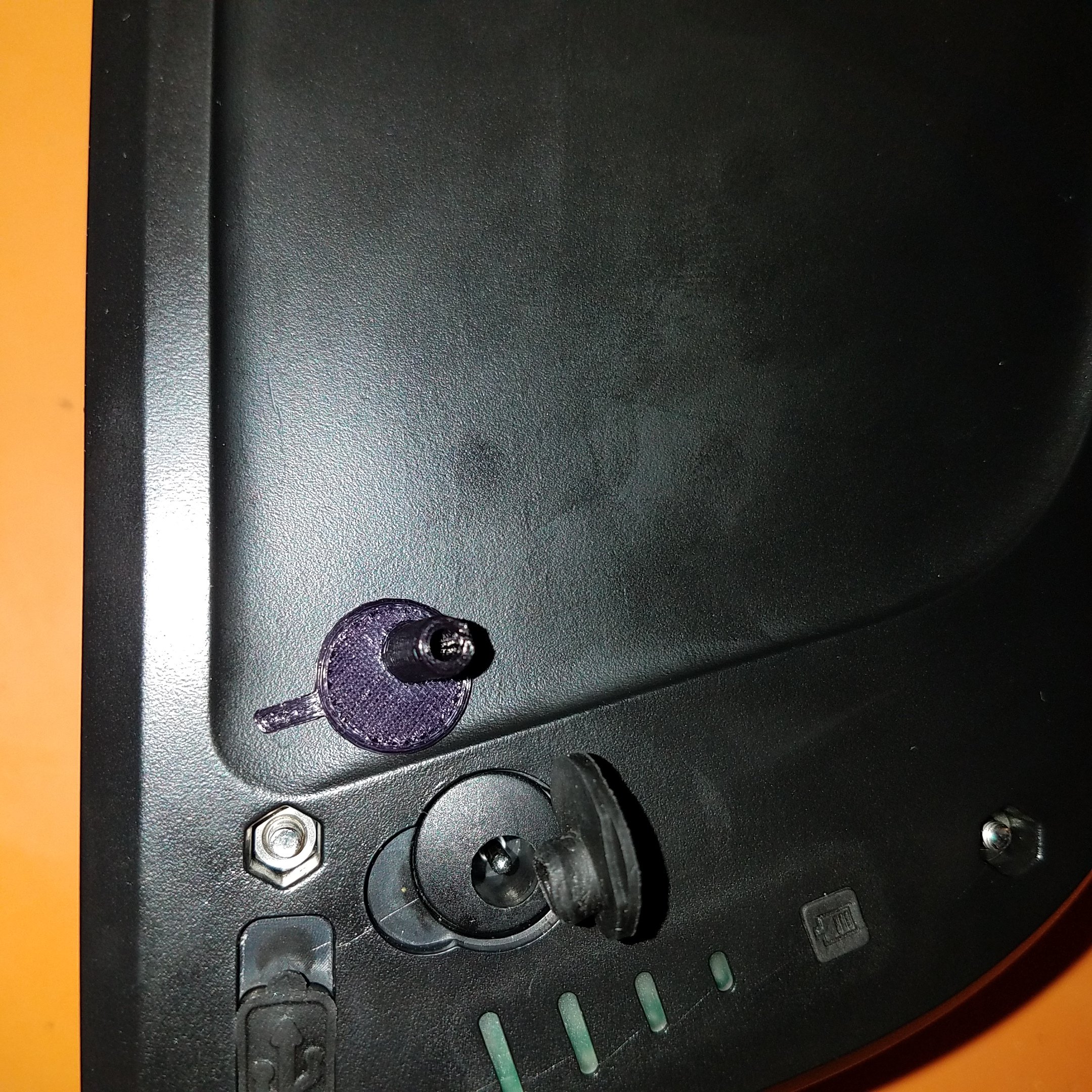

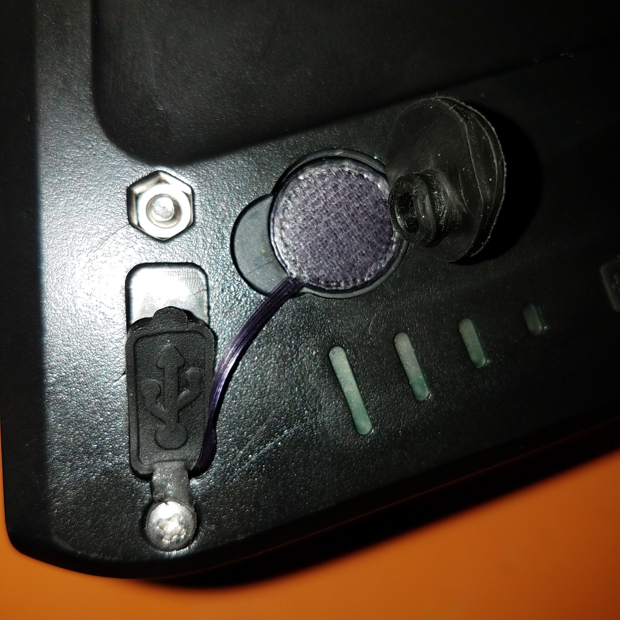

Anyway my very first attempt was a complete success! I even beveled the tip to make it easier to put in.
Works and fits perfect!
I printed it in black PETG and it is very strong. I am printing it in Nylon for the final.
I am refining it a bit now, adding a small tail so you can grab it easier etc..
I wish there was a screw next to the power port holding it in like the USB one has.
EDIT: Okay done with it, I created a short tail version and a long tail one that can be tucked under the USB cover. I tried to get it under that screw that the USB cover is being held on by but it would not come out enough. I may try later but this works fine. Just wanted it to hang while charging.
