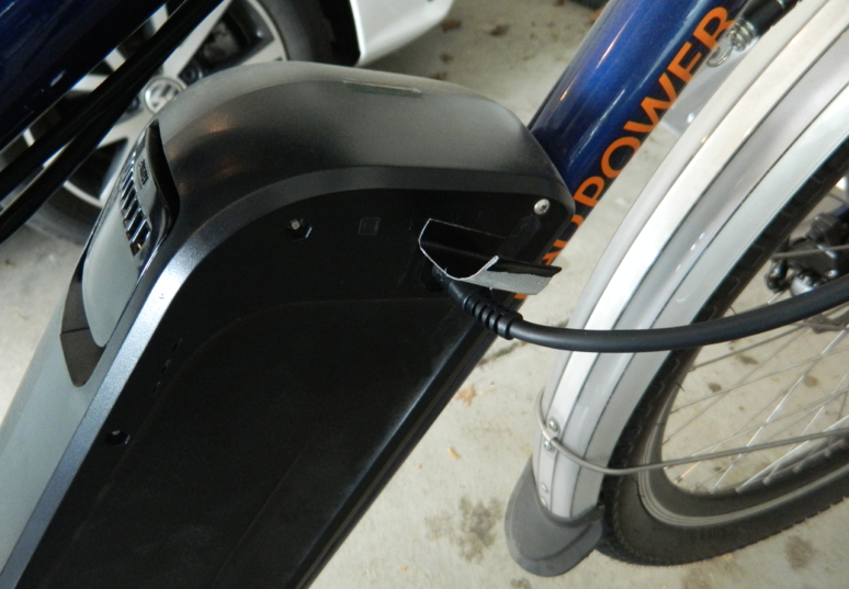

That pesky battery rubber charge port cover.

I tried to trim the rubber flap that keeps popping open on the battery charge port multiple times and once in awhile I could get it to stay plugged in but not always. I finally just cut it off and looked for other solutions such as a screw cap cover but could not find any glue strong enough to hold it to the battery case.

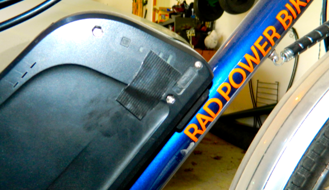

(Link Removed - Attachment No Longer Exists)View attachment 16821 View attachment 16822
I finally hit on a simple solution. Gorilla Tape. Just a piece of tape with one end folded over to give a sort of grip handle. Seems to be holding up fine and if ever the tape becomes worn, new tape. If anyone has found another good solution please let me know.
