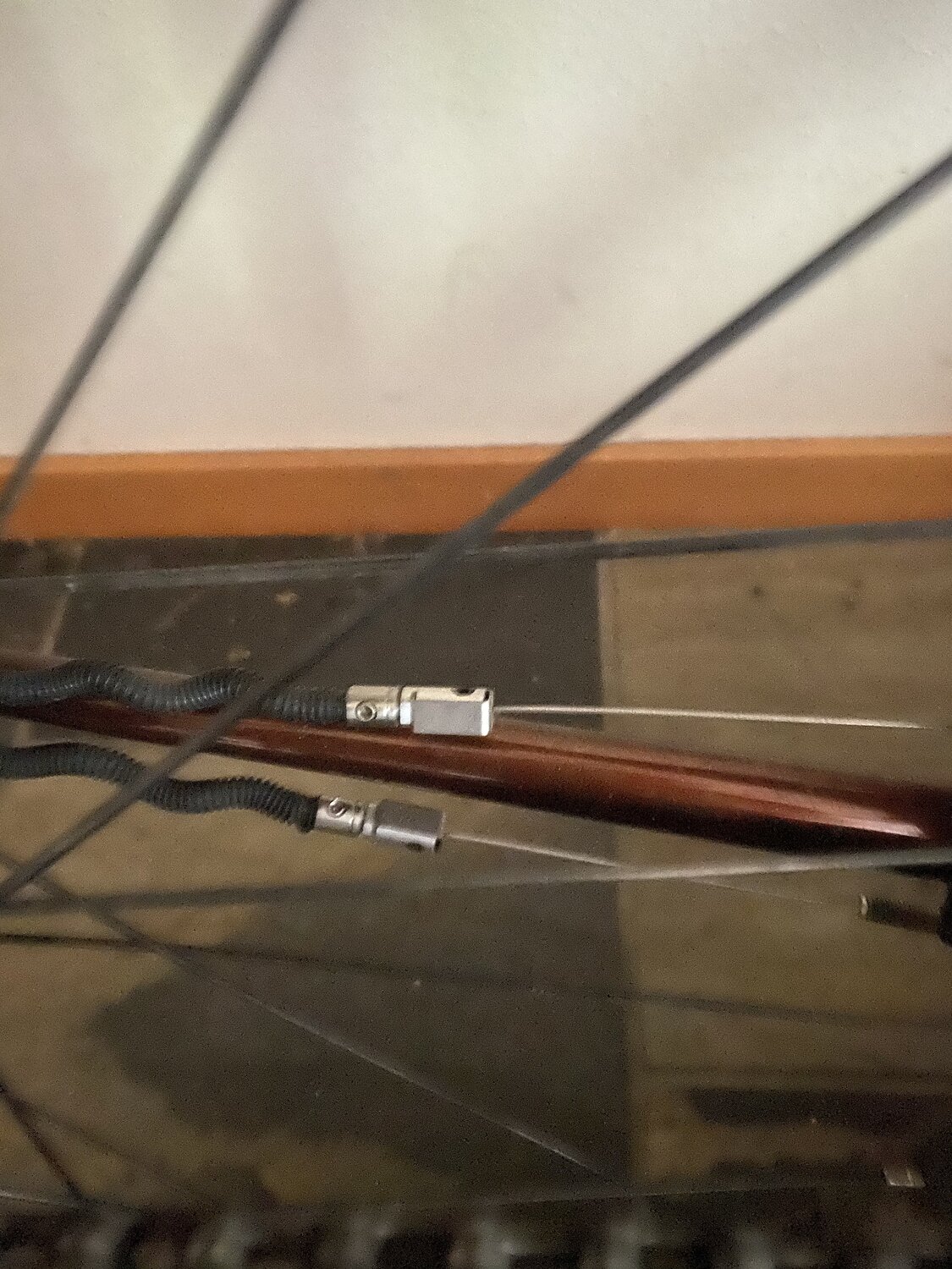

I just wanted to add that in regards to r&r of Rohloff there are quick connect options for cables so you do not need the screwdriver. The R&E bike shop here in Seattle built my Rohloff with them on all cables for a travel bike. rohloff.quick.connect.jpg

I just wanted to add that in regards to r&r of Rohloff there are quick connect options for cables so you do not need the screwdriver. The R&E bike shop here in Seattle built my Rohloff with them on all cables for a travel bike. View attachment 56774
That looks like a Rohloff Internal Gear Mech which is not compatible with Disc Brake versions. I think most ebike versions are using the external gear mech.
