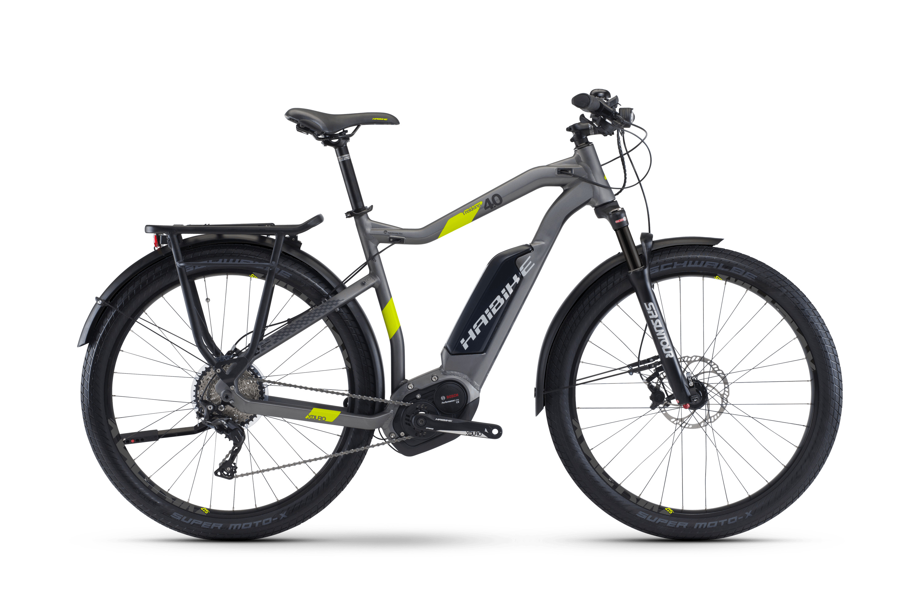

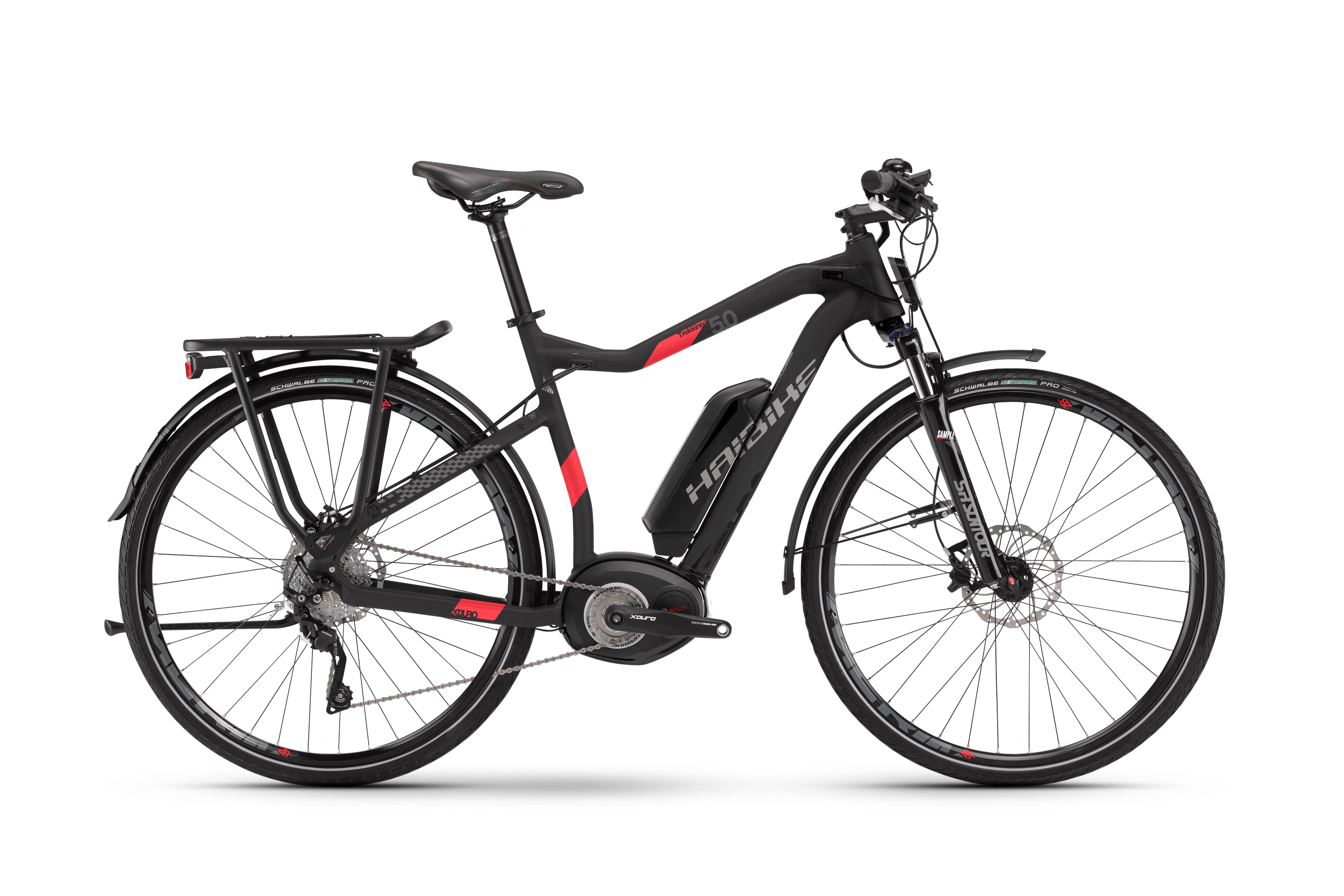

Love the wider Alexrims MD35 rims with the Schwalbe Super Moto X, 62-584 (27.5 x 2.4") tires on the 2017 XDURO Trekking 4.0, but want the Bosch speed performance line 350w motor on the Trekking 5.0 S. The 5.0 S has the Alexrims MD21 with Schwalbe Energizer Pro (28" x 1.5") tires and was wondering if anyone knows about any clearance issues with swapping out the 28" MD21's for the 27.5" MD35's. Has anyone put a little wider rim/tire on their Haibike Trekking?
View attachment 16571 View attachment 16572 Love the wider Alexrims MD35 rims with the Schwalbe Super Moto X, 62-584 (27.5 x 2.4") tires on the 2017 XDURO Trekking 4.0, but want the Bosch speed performance line 350w motor on the Trekking 5.0 S. The 5.0 S has the Alexrims MD21 with Schwalbe Energizer Pro (28" x 1.5") tires and was wondering if anyone knows about any clearance issues with swapping out the 28" MD21's for the 27.5" MD35's. Has anyone put a little wider rim/tire on their Haibike Trekking?
I commute on Haibike Trekking S Rx (28mph, 2016 model).
I can take upto 2" wide tires with the same fenders but you can go upto 2.2 by changing the fenders. Uses the std 28" / 700C wheels.
The new Trekking 4.0 you linked uses the 20mph, CX motor but comes with 27.5" wheels and because they spec'd 2.4" tires, they are using MD35 rims. They are heavier and using them on a Trekking S 5.0 means that you have to use a new hub because the Speed version uses QC whereas the Trekking 4.0 Bosch CX version uses thru-axle. Also, you will have to lace the wheel with new spokes, find a new hub etc. Just too much work.
I know the 2017 5.o has 15x100 thru axle at the fork but was not aware the rear hub was QC, I just assumed the rear XLC EVO hub was 12x148 thru axle as well. Thanks for the great information. I like to have assist up to 28 mph but its not crucial ( and of course there are several methods to defeat the speed limiter), but I am more interested in having a 350w motor vs. 250w CX, even though it has more torque and a higher top assist %.
