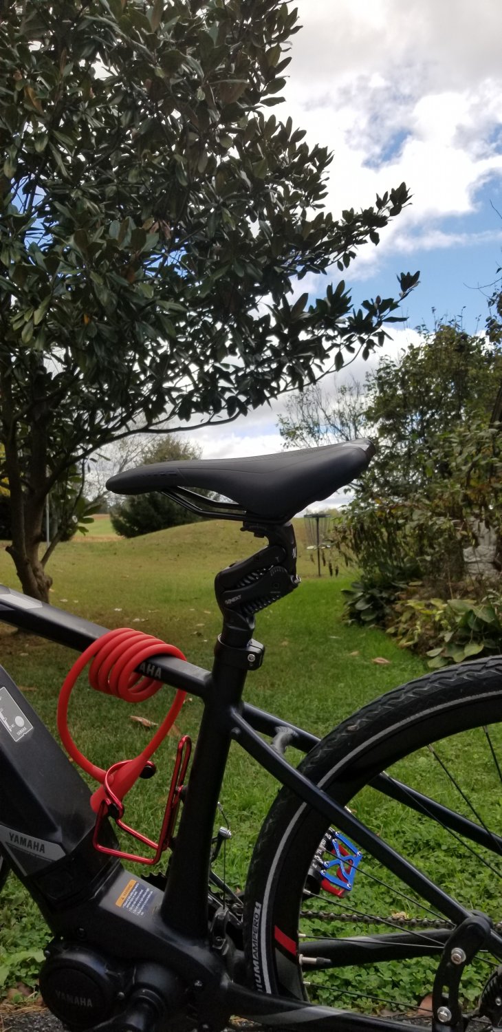

Well, I bit the bullet and bought the Kinect for my newest bike. Just like the Thudbuster short travel I added to another bike, I had to cut 2 inches off the bottom of the post to make it workable for a shorty.
I am used to riding a full suspension bike and this no suspension was killing me!
Looks good! Let us know how it works for you once you've put a few miles on it.

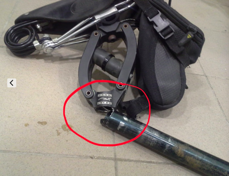

I have several seat post fail photos and have been looking for them all week... Here's one, one other is identical.
