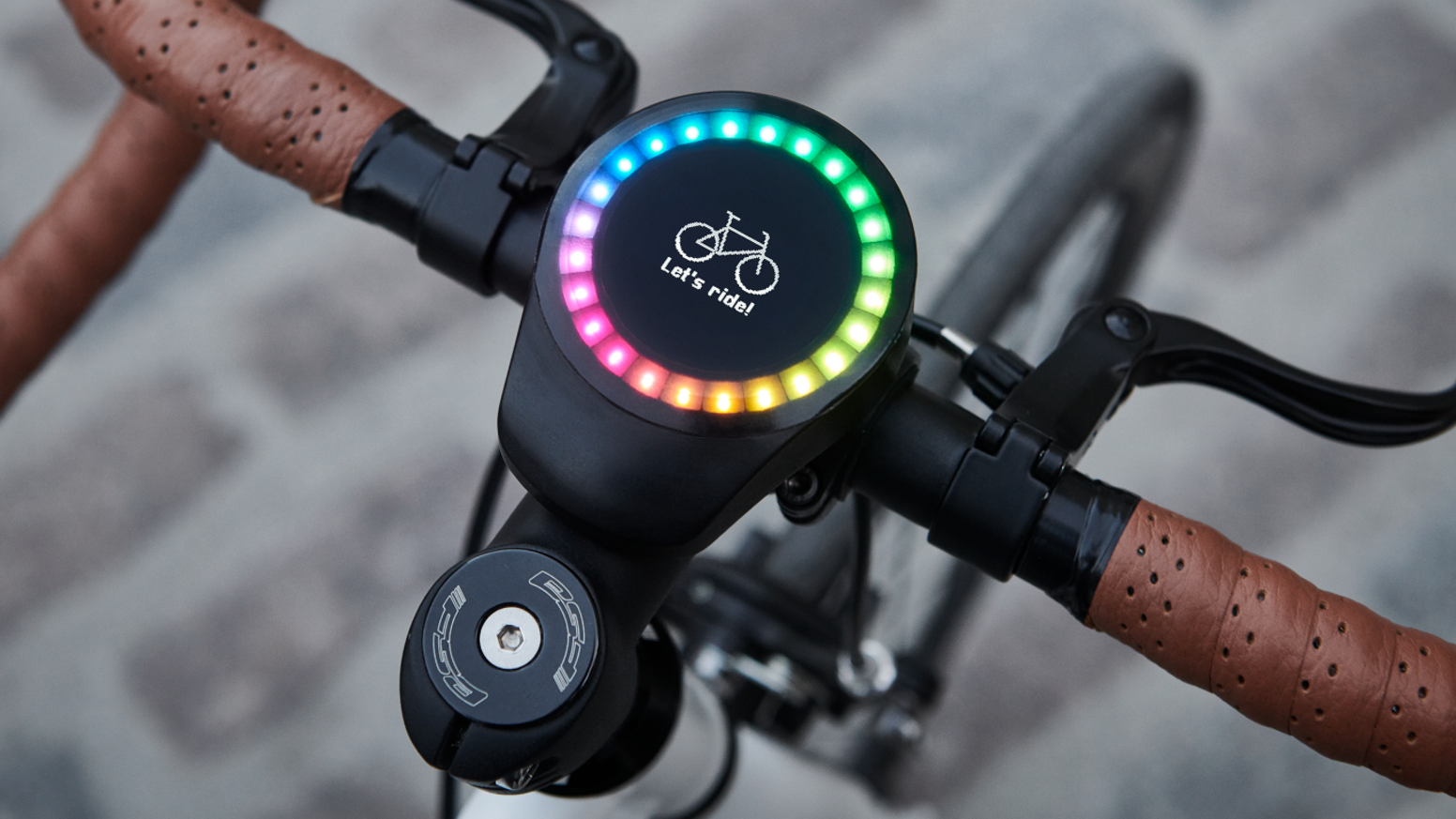

Last month the same site was offering the new Halo 2 for $34.95... not yet available on Kickstarter for $149 :)
SmartHalo 2 - Make Your Bike Smarter × 1
