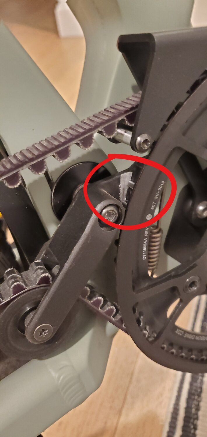

Here's a perfect example, see image attached, circled is where the chainring is currently wearing away at the tensioner flange. This was originally replaced months ago shortly after purchasing the bike, with no explanation of what was wrong and why this happened. As you can see, the new part is also rubbing against the chainring and wearing away. This is just one of the many things driving my meticulous butt crazy. I admit I'm a stickler but this is unreasonable for the price I paid and more importantly potentially unsafe for a 30mph, 70 pound behemoth. In the pic you can also see the shape of my Gates belt. While riding very slow (think Sunday stroll) maybe 2 months after purchase, the belt partially came off the back sprocket and went around a few times in this state and the sprocket chewed up the edges. My bike store simply said "we moved the wheel back to increase tension" and that's it! No explanation of how this could have happened, why the other mechanisms (belt center-slot and small "slack bearing assembly" by the rear sprocket) didn't work to keep the belt on or insisting that the belt be replaced. Is this another safety hazard waiting to happen, I don't know, and I hate that feeling having spent so much for "the best"

I would write R&M and explain that the part has already been replaced once, and you are requesting an explanation of why this is happening again, and what the remedy will be. I would keep it short. The German users complain as much as we do about how much these bikes cost and the consensus view is that R&M just doesn’t care. I’d cc: the tech who did the swap the first time; perhaps give him a heads-up that it’s time to get more information and a better solution.

I was just comparing my bike to yours re: the sprocket hitting the tensioner. Mine has quite a bit of clearance between them, about 2-3 mm just eyeballing it. I wonder if your losing the belt and this problem are related ie: an alignment issue. Assuming the tensioner was manufactured to spec, there isn't much in the mounting configuration that would place it in danger of hitting the sprocket so that leads me to wonder if the sprocket/motor assembly is mounted incorrectly or heaven forbid, there is a problem in the mount built into the frame. This needs to get fixed! If you're dealing with Propel then maybe give a call to his ace tech, Kyle in Long Beach ext. 999. He really knows his stuff and maybe can give a heads-up to the Brooklyn guys.

Had this thought too, all the Delites/Superdelites on our floor have plenty of clearance. Makes me wonder if the bike has the right Rohloff-corrected chainring spider.

how do I rectify this? My LBS has already swapped the tensioner based on R&M's instructions, @JVBulman what indicates i have the correct spider?
Here is a picture of my spider. Other than Rev it looks to be the same. I don't know what that B is that is on yours. Mine doesn't have it. Just curious if you checked the motor mounting bolts. Maybe the motor has shifted? Don't even know if that's possible.

Here is a picture of my spider. Other than Rev it looks to be the same. Just curious if you checked the motor mounting bolts. Maybe the motor has shifted? Don't even know if that's possible.
Marc
That's a picture of your chainring; the spider is the 5-arm piece the chainring is bolted to and it mounts to the splines on the drive unit spindle that the crank arms are mounted to.
The drive unit fits very snuggly in the frame, it's not really possible for it to shift laterally in that way.
