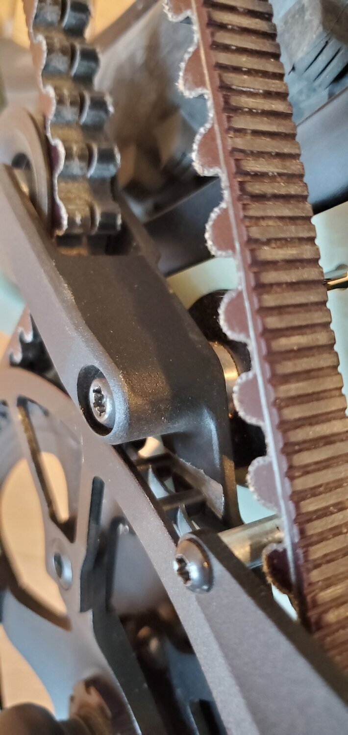

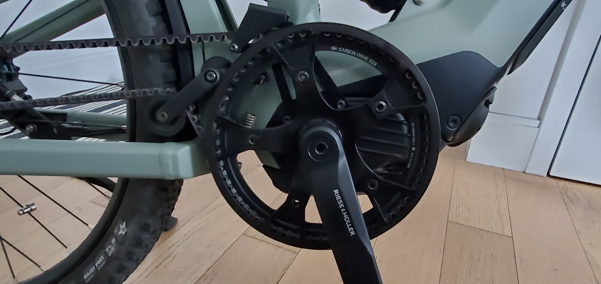

here are some additional pictures
1) Notice the frayed edges of the belt and the distinct line down the middle of the left half of the belt, where the rear sprocket tried to carve a new center line when the belt hopped off. You can also see how close (touching) the chainring is to the tensioner flange. Again, Propel gave it to me like this twice
2) View of the spider
3) Tensioner and chainring, notice also, how close the chainring guard is to the tensioner pivot.
Please let me know if there are better angles that can help us diagnose, thanks all for your help thus far!!!
2) View of the spiderView attachment 77676
3) Tensioner and chainring, notice also, how close the chainring guard is to the tensioner pivot. View attachment 77677

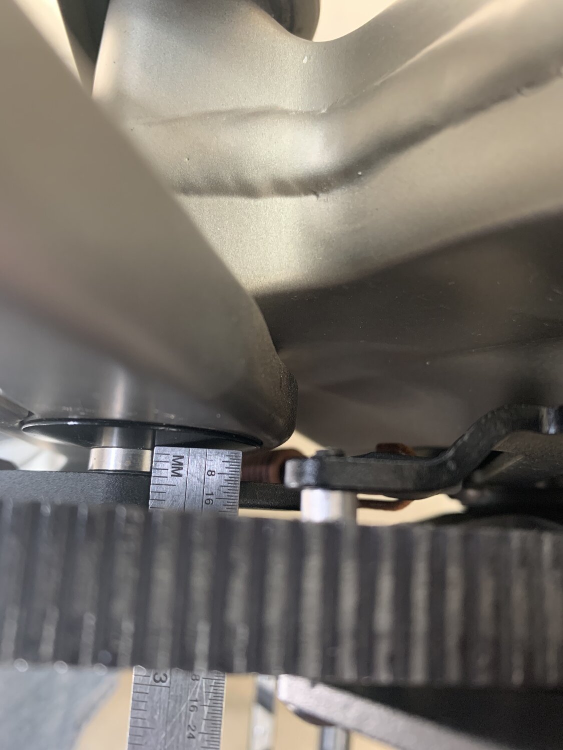

-Steven
Mine is the same, maybe 1-2 mm clearance. Is it possible to take a picture from above showing the backside of the spider and the shaft where it enters the motor? I measured from the edge of the belt to the frame at the spot in the photo and it is exactly 10 mm. Can you measure yours?

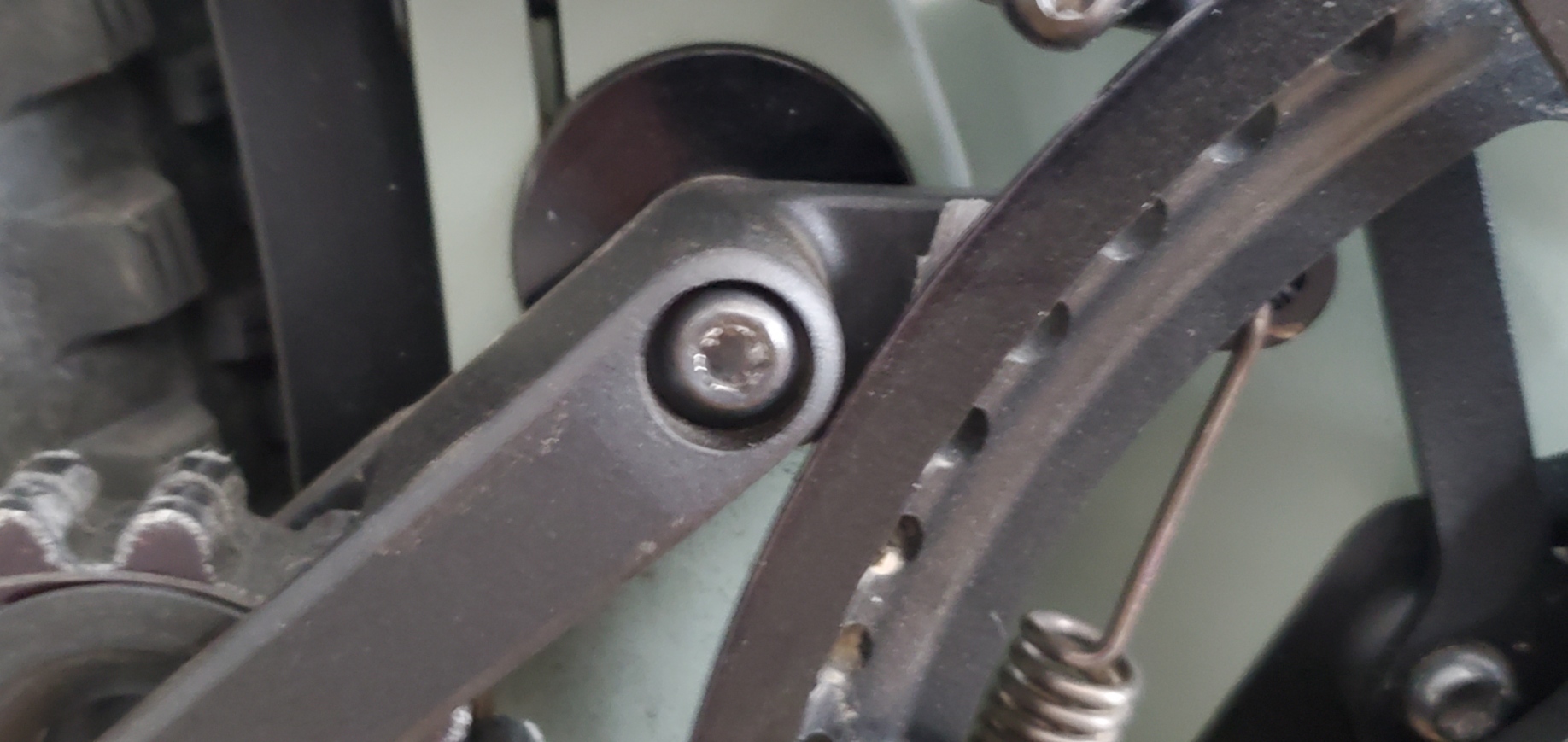

Here's that angle, mine is also about 10mm from the frame.
and the tensioner axel, note the silver bushing on the frame side, this is pushing the tensioner assembly rightward against the chainring.
So I measured the distance between the tensioner and the black convex piece. It is about 3.5 mm. And yours?
