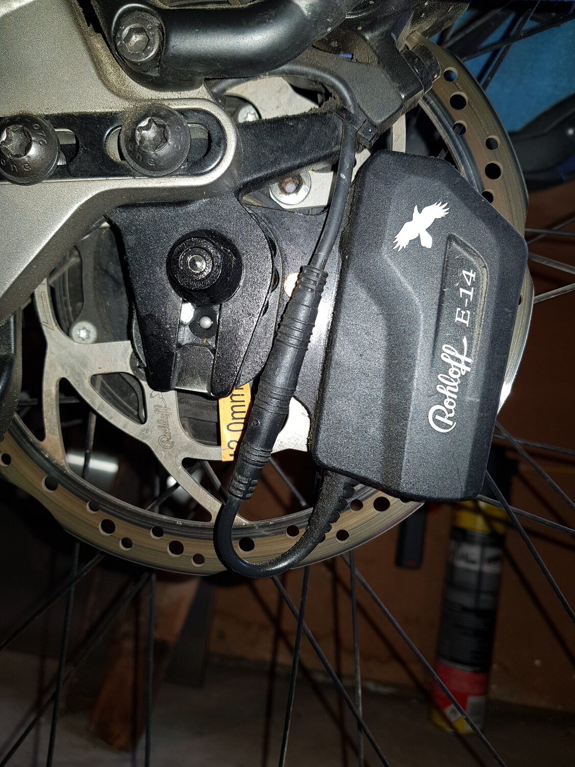

However, it seems to me that the E14 shift activator box attached to the left side of the rear axle may prevent a trailer hitch being attached. Is this the case?

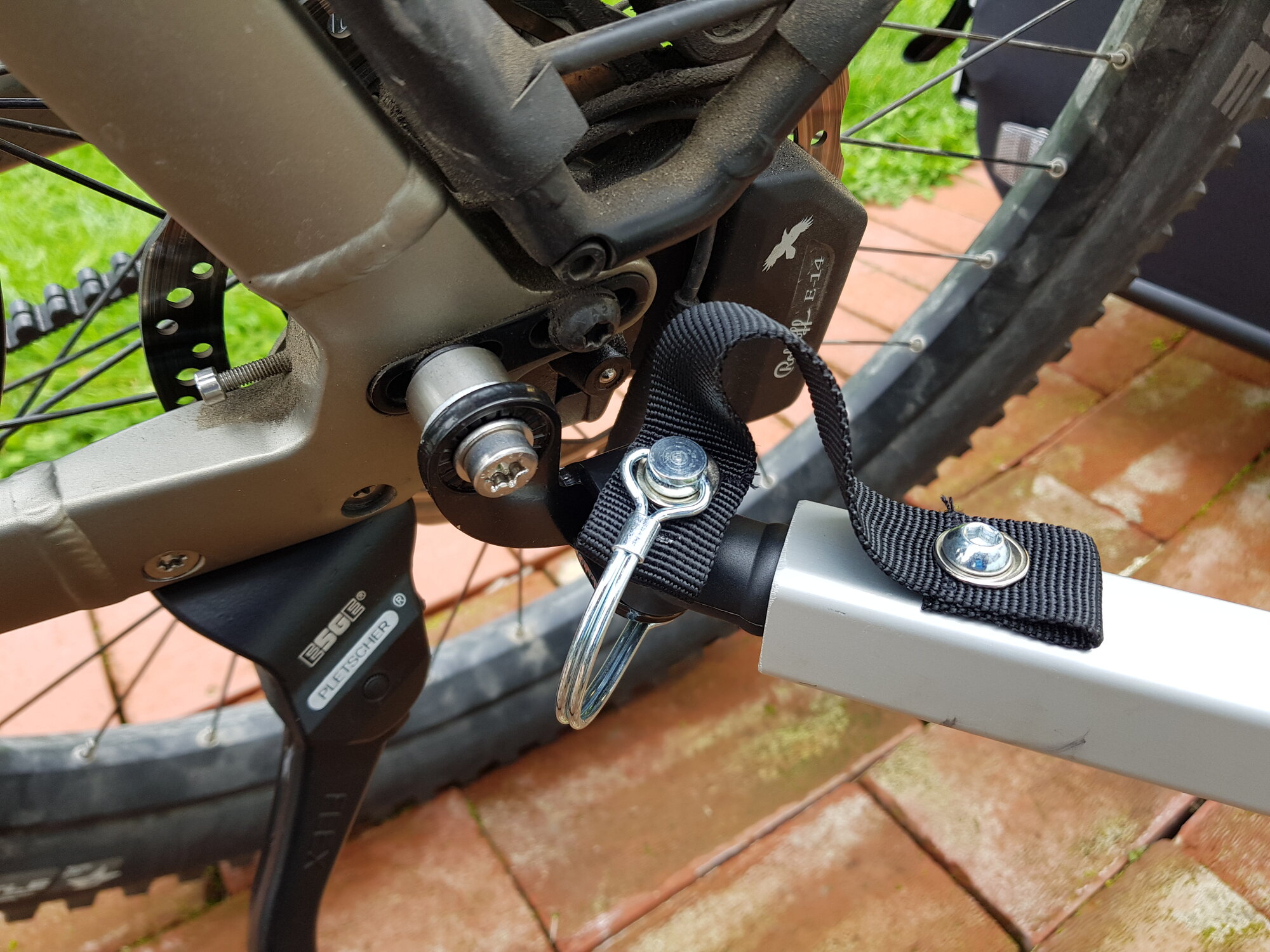

Rohloff Is unlikely to warranty an E14 shifter unit that has collided with a tow bar. I saw a post on their Instagram account to this effect. Riese&Mueller sells an adapter kit to prevent the interference:
it worked fine on my bike. I picked the right size bolt to replace a sliding dropout bolt + allow for the hitch. I assume you can order this through your dealer or, less ideally, fashion a solution after a visit to the hardware store.
One annoyance: the new bolt requires a Torx45. I hate bringing that along on longer tours.

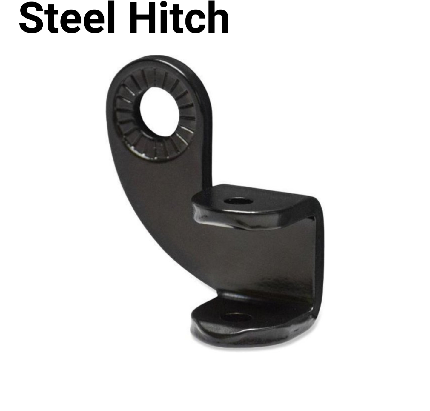

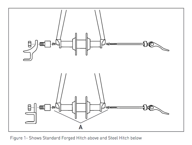

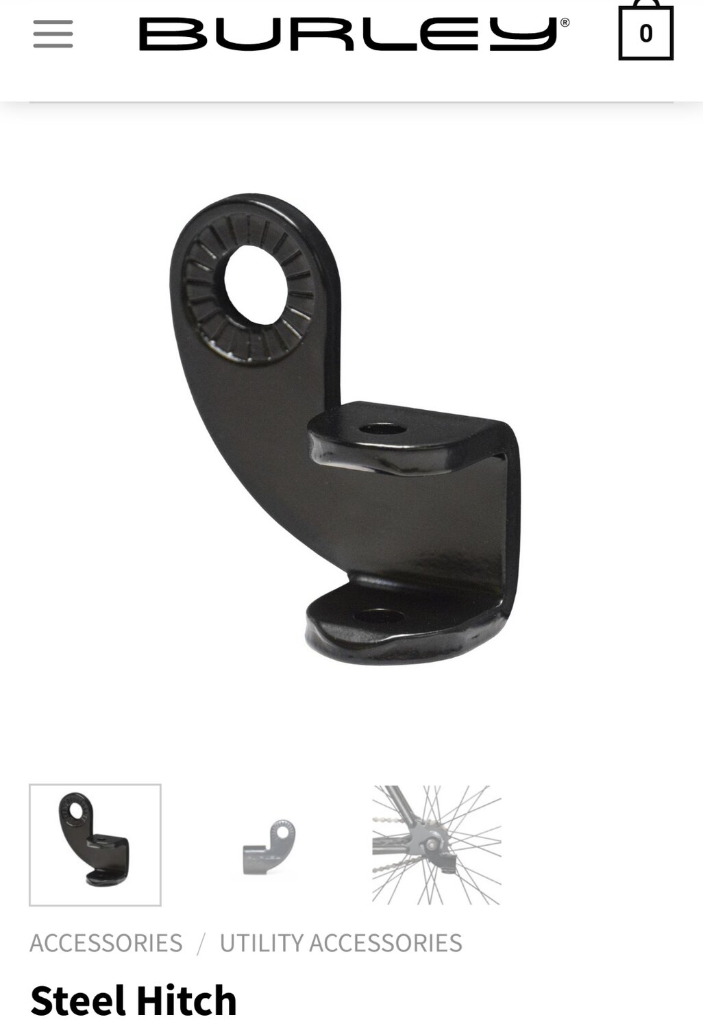

Subsequent to my original post, and considering Burley trailers, I found on the Burley site that their latest standard "Steel Hitch" for their trailers (eg the Nomad and Flatbed models) is offset slightly to the rear and not to the left like the original "Standard Forged Hitch". This would make the problem worse compared to the original hitch and simply wouldn't fit because of the E14 shifter location.
So possibly a right side hitch? A simpler solution and there's plenty of room there. The hitch would need to be a mirror image of the left side hitch ..... or use dblhelix's RM solution.
Cheers

I can confirm that the hitchpost that comes with the Nomad (purchased 6/21) will work with the R&M adapter w/o interfering with the E14 shifter (which is what I have). This was using a Nevo, which should be similar to your setup as they are both hardtails.
I see seatpost recommendations — I believe this is unsupported by R&M. The single-wheel trailers are not supported for Control Technology (suspension) or step models like the Nevo.

That's encouraging confirmation. Some further questions:
- In case there are different versions, what is the RM part number of the adapter you used?
- Which type of hitch (see attachments) came with your trailer?
- Does the rear left view of my SC2 shown in the photograph look similar to that of your Nevo?

sure,
hitch type: Burley Steel Hitch (first picture, black)
R&M part nr: VBK0017
i have a friend with a 2021 SC2 who has attached the hitch adapter/hitch w/o issue and has taken a few trial runs with his trailer. I can take pictures of mine this weekend if you’d like.

Your friend's SC2 ... does it have a Rohloff E14? With the information you've given, a photo of your Nevo axle configuration would probably be less informative but an interesting comparison nevertheless (if convenient).
