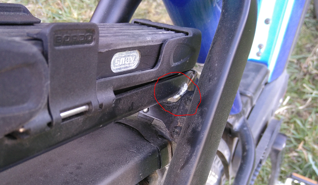

Does anyone have any experience with the Splined Carrier (CDX Lock Ring?)  and rear rack problems described in this lengthy German forum?
https://www.pedelecforum.de/forum/index.php?threads/riese-müller-charger-supercharger-erfahrungsaustausch.52958/
It's the way the Gates CDX cog is held onto the Rohloff Hub, something about vibrations and excessive wear of CDX parts??
And the rear rack cracking and completely breaking in several places with several iterations from R&M to try and fix it.
Mine is vibrating under certain conditions and has a single? crack sound from the rear at the start of rear braking and when starting off from stand still, my T40 belt tension adjustment lock screws are tight and brakes are not loose in any way.
Apparently not everyone's GX is affected, in that they may have these older design parts in place but is not a problem for them.
