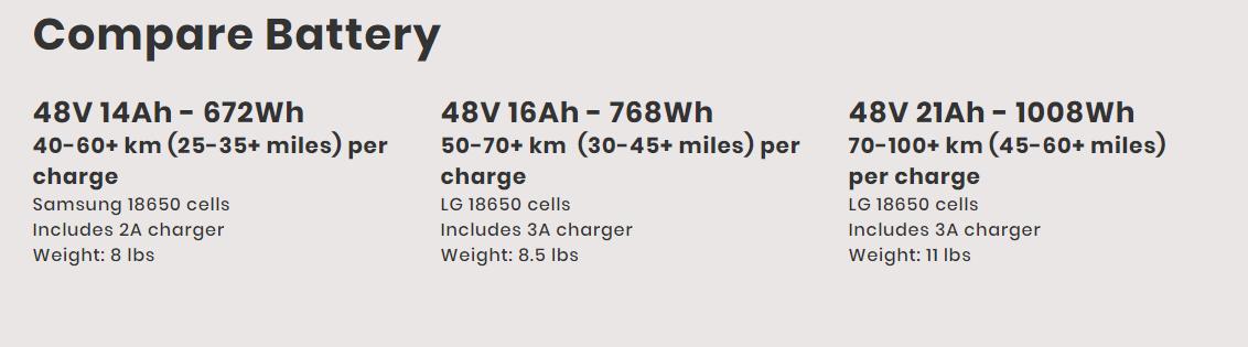

The Juggernaut has a 1008Whr battery that weighs 11 lbs with estimated 70-100 km per charge (estimated recharging of 80% in 2 hours). I would like to travel Edmonton to Calgary (about 300 km). With the Juggernaut, this trip could potentially be done with 2 batteries and 2 chargers with one stop halfway.
What is the weight of your 880Whr battery and what is the weight of your 1260Whr battery?
Thanks for the information.
9lbs
11lbs
Your bike comes with 3A charger. I am curious to know how can it charge in 2 hours?
3A charger puts out 3Ah every hour, so if your battery is 21Ah, it would take more than 5 hours. Please educate me here....! :oops:

I am reading from the website, "Our batteries charge up to 80% in just 2 hours. This means less time charging and more time riding!" This must be referring to the 11.6Ah battery. Sorry for the confusion I have created.
