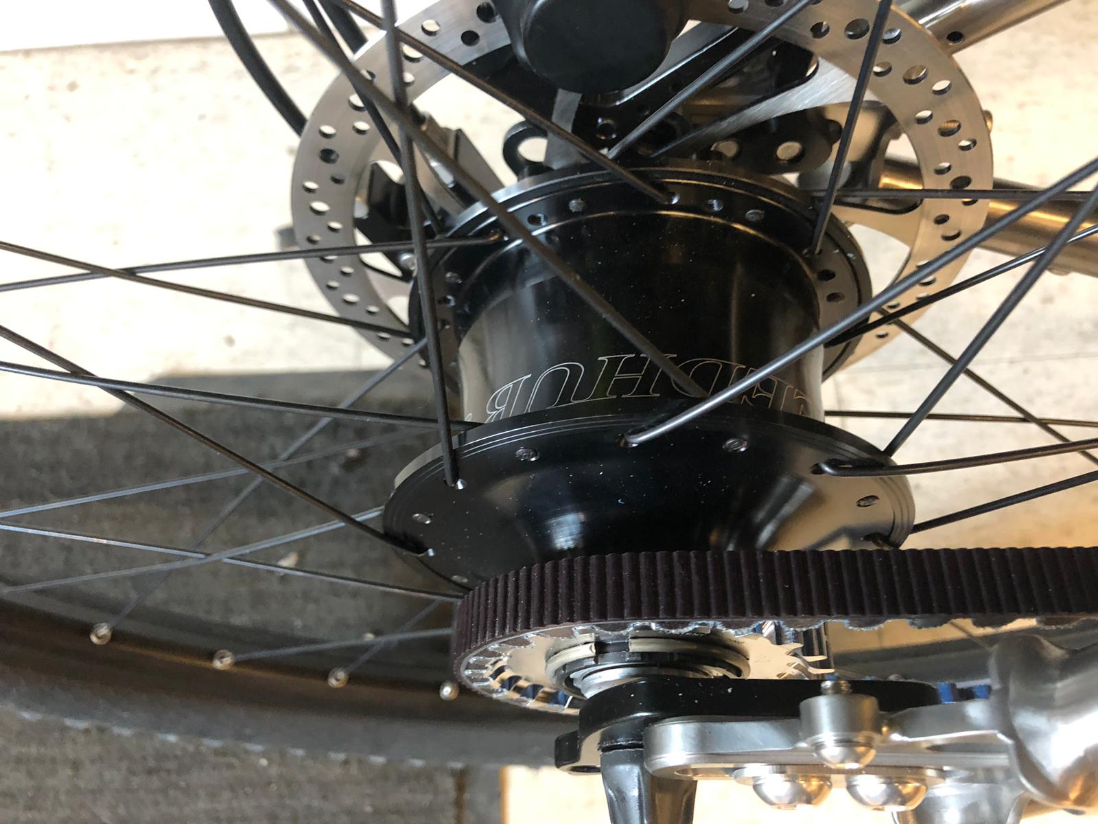

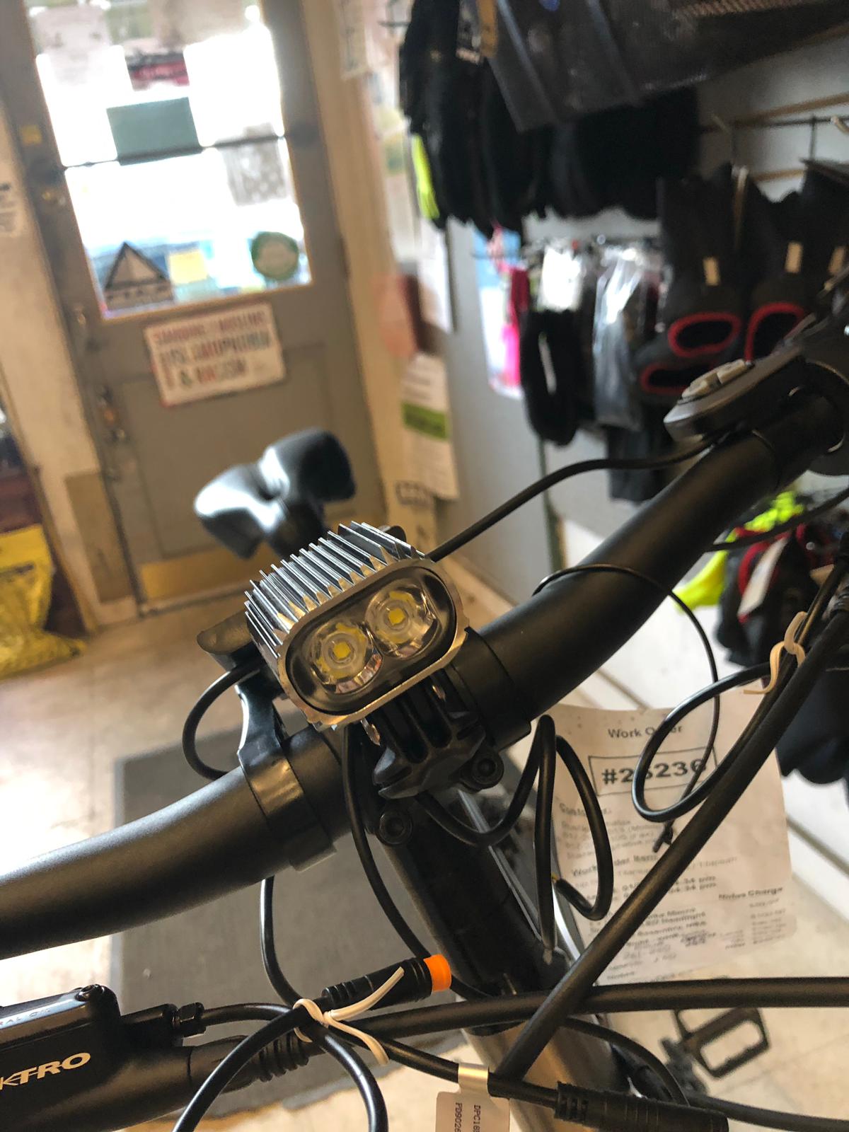

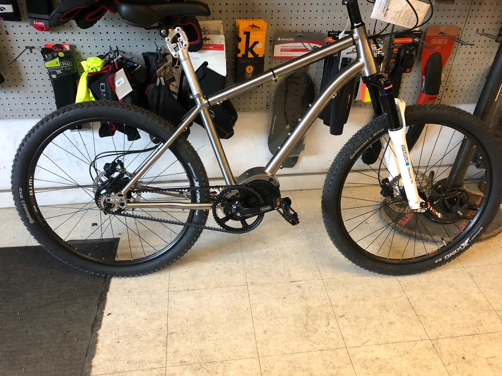

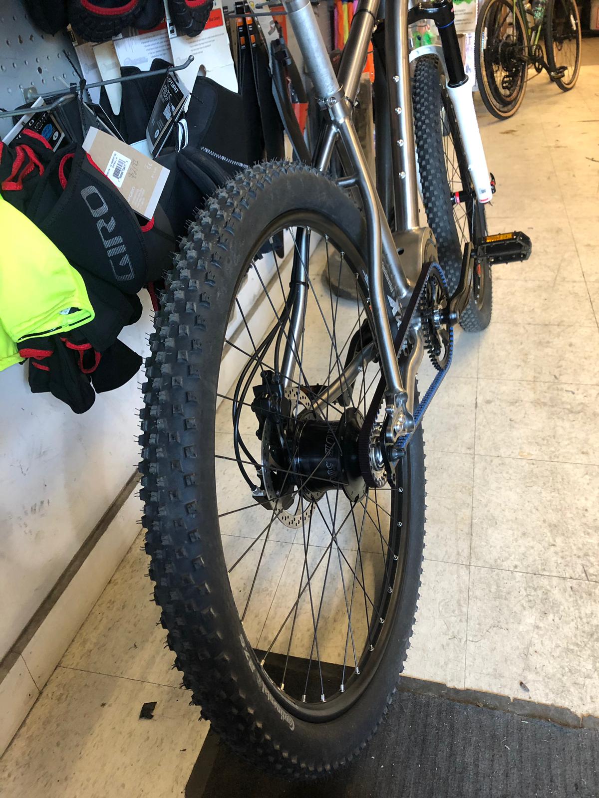

The start-up company team has been testing some prototype bikes that are well thought-out and extremely capable.
The first prototype is aimed at producing very capable, low-maintenance commuter. The picture shows a bike with Gates+Rohloff combo but wheels, brakes, tires are not what we want it to be.
Some highlights:
Clean Ti frame, with internal routing.
Bafang-ultra limited to 750W federal limit and 28mph in PAS.
[We had to sign an agreement with Bafang to tweak the firmware, get the light output to 12V instead of 6V.]
Rohloff hub - not the E-14, just the manual
Gates carbon drive
1250 Whr custom battery by EM3ev with 2 yr warranty and smart BMS, Bluetooth app for measuring the state of charge (Base model will come with 850Whr battery that is similar to the EM3ev Jumo shark pack)
Programmable Cycle satiator charger - 8A fast charging
Tubus racks
Front and rear E-bike specific lights - Lezyne 1000 lumens
Schwalbe Supermoto-X tires - 2.4" tires
30mm wide tubeless ready rims.
SR Suntour AIR fork with 100mm travel.
Tektro 4-piston brakes
Kinekt/ Body float seatpost
Price of the decked out bike = $5800
By replacing the Rohloff with Nuvinci, Ti frame to Al, price will go down significantly.
Before sending the final version to the production run, I thought I would share it here so I could get your feedback on the product design and features.

The written specs sound great. I've never seen the jumbo, how well will the battery fit on the frame? I would love the range! Motor power is perfect, I commend you keeping it legal. Looking at the first picture, the headtube looks too tall for that fork. In the picture it gives the impression the frame is raised at the front. Hard to tell if that's the case from a photo though.
Do you plan on adding any upper seat stay braze ons for a rack? Have you gotten the battery yet to get a final weight? Will the battery take an 8A charge rate, I guess that is a stupid question considering your credentials but I thought that the largest 18650 cells weren't up to that much?
Looking good though and seems like for the fit and finish the pricing is in the ball park. I have always been a fan of Ti and it is not that prevalent in the eBike market place.
I like everything about it ! Are you sure the Nuvinci can handle the torque of the Ultra ?
Good point. Since the motor is restricted to 750W, the cargo edition of Enviolo 380Se (the one used in TERN GSD S00) should handle the torque. Team reprogrammed the motor for a smooth ramp up of power so people don't get blindsided by sudden burst of power. With great power comes great responsibility ;).
Thank you JR. The Jumbo pack kinda sticks out like Bosch or Yamaha battery but that's the only way to keep the price down without modifying the frame.
It's 52V, 17Ah pack with Samsung 3500mAh cells. The frame has decent rake and trail. Nothing too aggressive but I will check them again.
Ti frame with 1000+whr battery will weigh about 55lbs and the Al frame will be little more (both the Bafang Ultra and Rohloff add weight).
The production frames have internal routing and rear rack braze ons :)
Good point re: charging. Even at 8A, it's only 0.45C charging rate because the pack is quite big. I will check with Em3ev to make sure there are safety features to avoid any inadvertent problems that may arise with 8A charging. There are not many chargers that can suuply 8A at 58V but it may be better to restrict to 7A max.
This has most of the things I had in mind for a great commuting ebike. You custom built with TI and Rohloff, 1250wh battery 8a charger and still it is close to Supercommuter's price while being far superior. That is how overpriced some of these big brand commuting ebikes are.
I wouldn't touch rohloff btw, cvt's are very inefficient.
Edit: Want to correct a misunderstanding, the statement should be read as "don't change rohloff with a nuvinci because nuvinci is a cvt and inefficient". You are talking about switching to a nuvinci to take the price down but I simply would not do it, yes rohloff is expensive but for a bike at this price I think it is a must have, it seems to be very durable , 14 gears have a very wide range and I would not think about changing it with something else especially a Nuvinci which is cvt (its average efficiency seems to be around %83 which in my opinion is quite low) not to mention its range is quite limited.
Nice looking bike with a fine spec sheet. Given the Rohloff, gates etc. I would suggest going with Shimano xt 8000 or Shimano Saint brakes I would also suggest going with a wider rim such as the Alexrim MD40. A front suspension upgrade option to Fox would be nice and optional fenders as well. Another good brake option would be the new magura mt5-e four piston version with brake light switching for the rear lights
