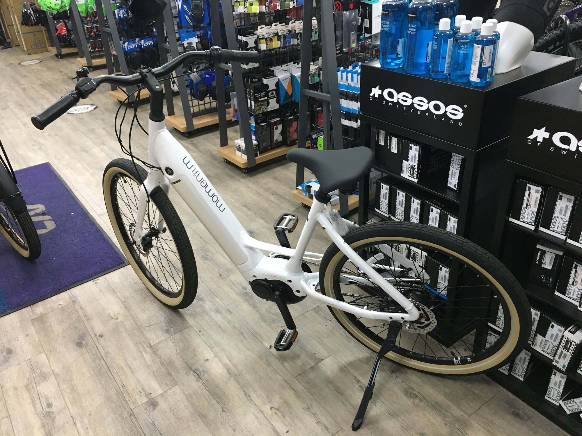

Here’s the beauty that I’m about to get!
Interesting that they keep the cost down by using a smaller battery, 375 wh. That could be reasonable if your rides are like mine. I have a 625 wh battery, but the most I've ever used is about 40% of it! I haven't done any marathon rides yet. My longest was about 18 miles. We live in a hilly area, but I don't go for speed - I only use power for getting up the steeper hills.
Nice looking bike, enjoy it. Me and the wife have e bikes, hers is a medium and mine a large. She is tall enough I she can ride mine and I can get the seat high enough I can ride hers. When I ride hers I mostly notice the handlebars being closer to me.

I got my 2020 Momentum Transend E+ almost two years ago. It has a 375w battery and I typically ride 20-25 miles and only use about 50% of the battery capacity riding at 12-15mph average speed in a very hilly area. Momentum changed the battery on the Transend from 375w to 500w in 2021. We bought a 2020 Momentum Vida E+ from our LBS last spring for my wife, we got $200 off since it was last year's model. She never rides more than 15 miles at a time, so it's plenty of battery for her needs.
