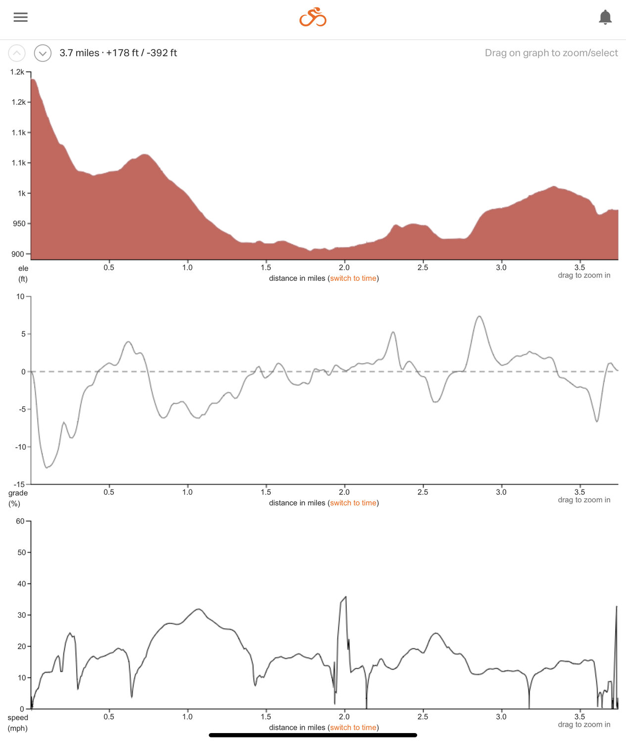

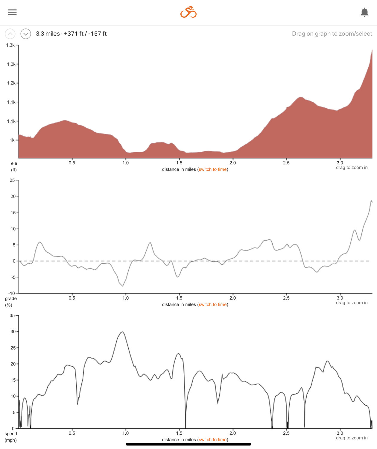

Got the 38T installed on the front chainring and here are before and after rides. The first was to the shop and the second back home. I had to stop at the end as the grade became too hard for me on my driveway. Good news is that I made it half-way up the driveway. I’ll do a few more rides with this new gearing before deciding on the rear gearing.

Got the 38T installed on the front chainring and here are before and after rides. The first was to the shop and the second back home. I had to stop at the end as the grade became too hard for me on my driveway. Good news is that I made it half-way up the driveway. I’ll do a few more rides with this new gearing before deciding on the rear gearing.View attachment 117637

Not yet. I’ve been riding it with the 38T so far and can take 10% grade hills pretty well. Getting up my driveway is possible but still difficult. I may just give up on that as I’m not sure any changes would make that other than me losing weight and building muscle. I’ll try this out for a bit longer before any more changes.
