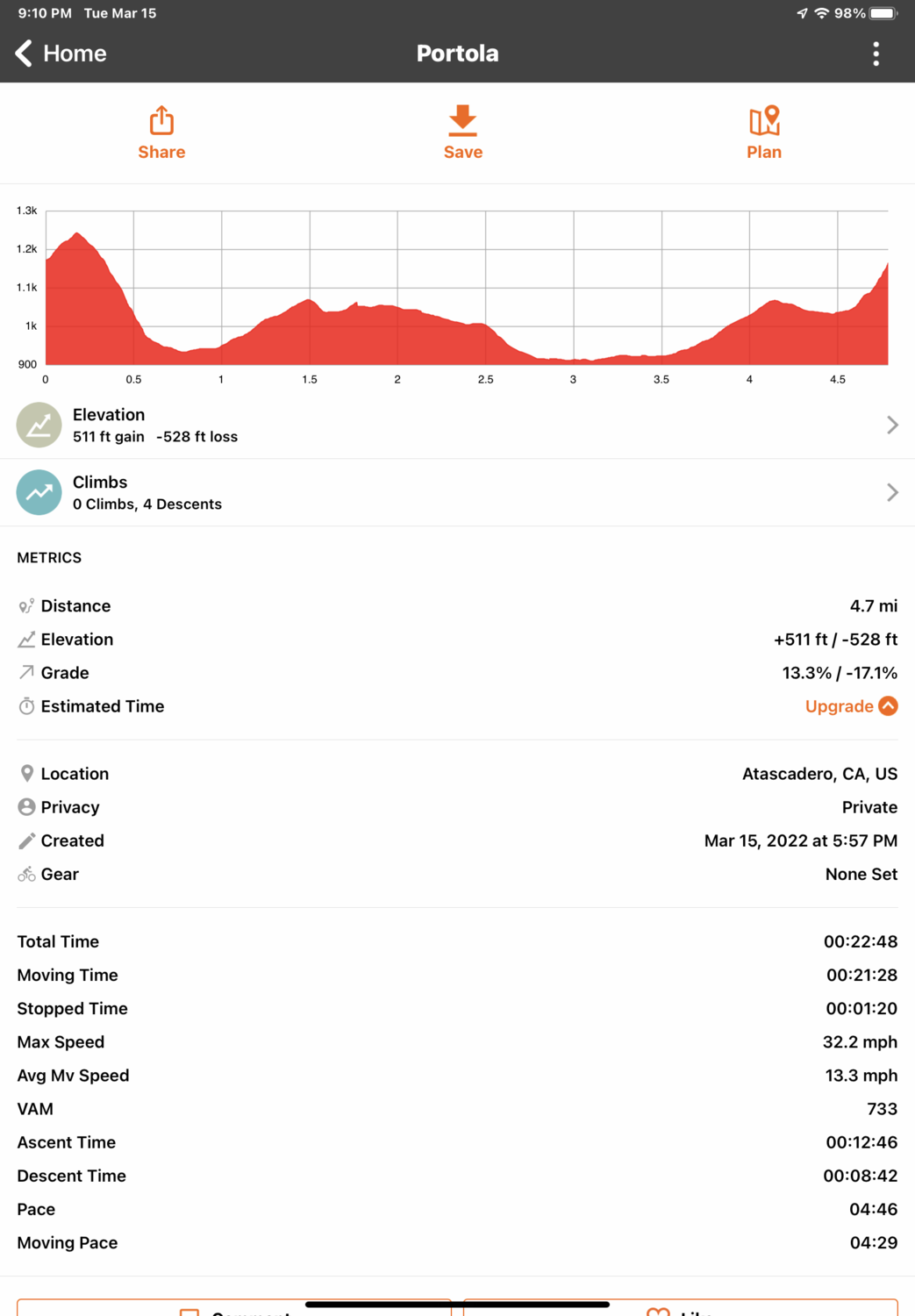

Took a couple more rides in the neighborhood and used Ride with GPS. It indicated that the grades were ranging up to 15-16% briefly and hit at or above 10% for about ¼ mile. And a bit of up and down in the grades too. I hope the gearing change and me slowly building up my physical abilities will make these hills easier to climb. Not sure that will work as well for my wife. Thinking about what bike would work for her, perhaps one with a throttle (which likely means a rear hub) with at least 750W power and some good torque would work. She’s quite a bit lighter than me at under 120 lbs but doesn’t have as much muscle either.

Took a 4.8 mile ride wi5h some climbs and did pretty well. I avoided going up my driveway as it is pretty steep and doubly hard to finish with. Hopefully I can make it up the driveway too once the gearing is changed on the bike.
13%...17%...No wonder you have been having issues. Any reduction in gearing is going to help. My bike has up to 85nM available and is specifically geared for steep grades. While I would be able to climb your hills it would take extra effort, even with the extreme low gearing and torque.

What sort of speed are you able to maintain going up the steepest grades?
You sure are blessed to live in such a magnificently scenic part of our great country!
You are so right - this area is gorgeous and we are so fortunate to live here now. My speed is around 4-5 mph at the steepest grades of around 13%. The effort required for even steeper grades is too much for me to handle right now. Even at 13%, I don’t last very long. I’m trying to build myself up slowly to manage these hills. Some neighbors who walk around quite a bit have suggested several routes around that aren’t so steep so I will try those. The area right around the house is steep so I have to conserve energy for those runs.
