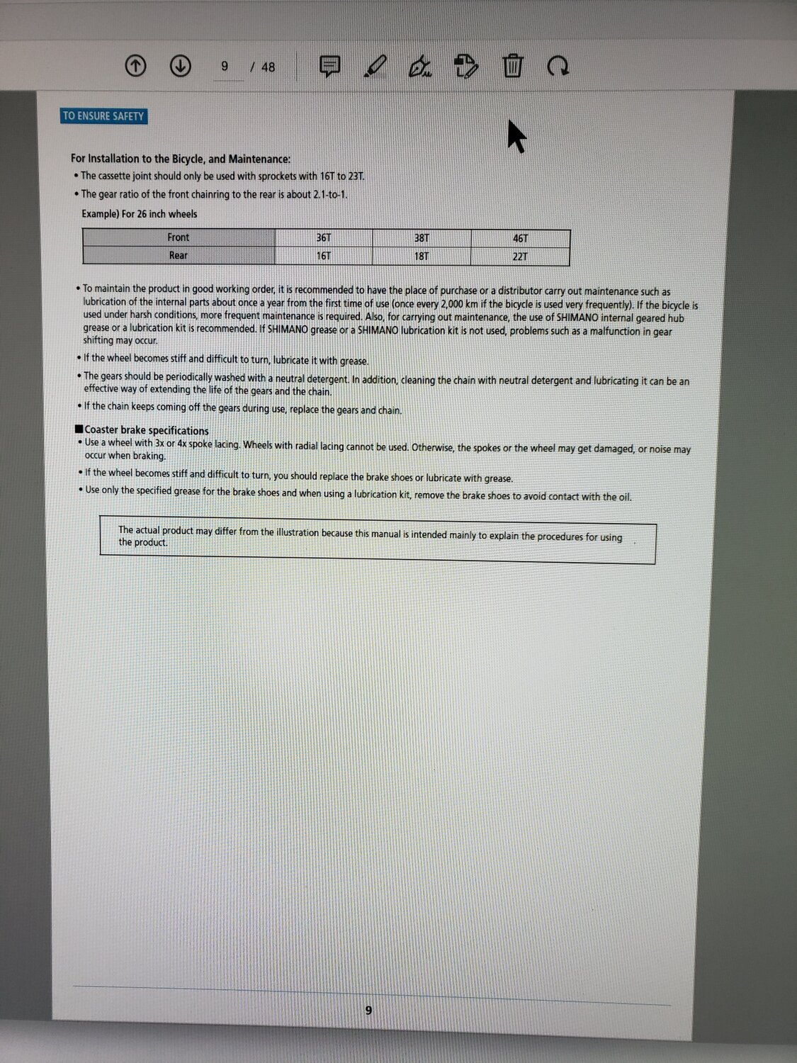

Judging from your comments that you had great difficulties climbing some of the grades, you may want to consider changing the gearing to gain more of a mechanical advantage. I believe your rear cassette has 18 teeth. The specifications for your 7-speed Shimano system indicate that a 22 tooth cassette is available. The Momentum website does not show what type of crankset gearing is standard. You can go as small as a 36 tooth crankset on the front.

I would have a conversation with your dealer about the possibility of changing your gearing to help with hill climbing and your driveway. Shimano documents says it is possible. See attached example of the availability of different gearing.
I know little how these re-gearing techniques apply to an internally geared hub system. Your dealer should be able to help you with this.

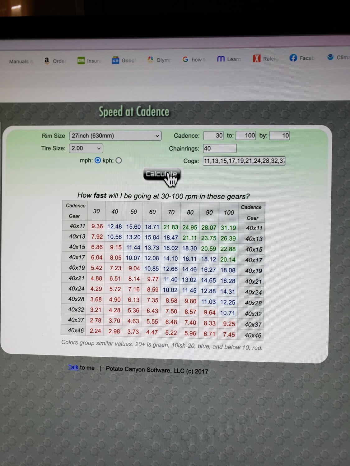

For your application with an internally geared hub you need to use this type of calculator......https://www.sheldonbrown.com/gear-calc.html
I have re-geared all my bikes over the last 15 years in this manner to reduce the stress on my worn out knees. I also am able to achieve a reasonable moving speed average while having the ability to climb steep grades.
The attached example of a gearing calculator shows some of the calculations you can make. Note: this calculator is for conventionally geared bicycles.

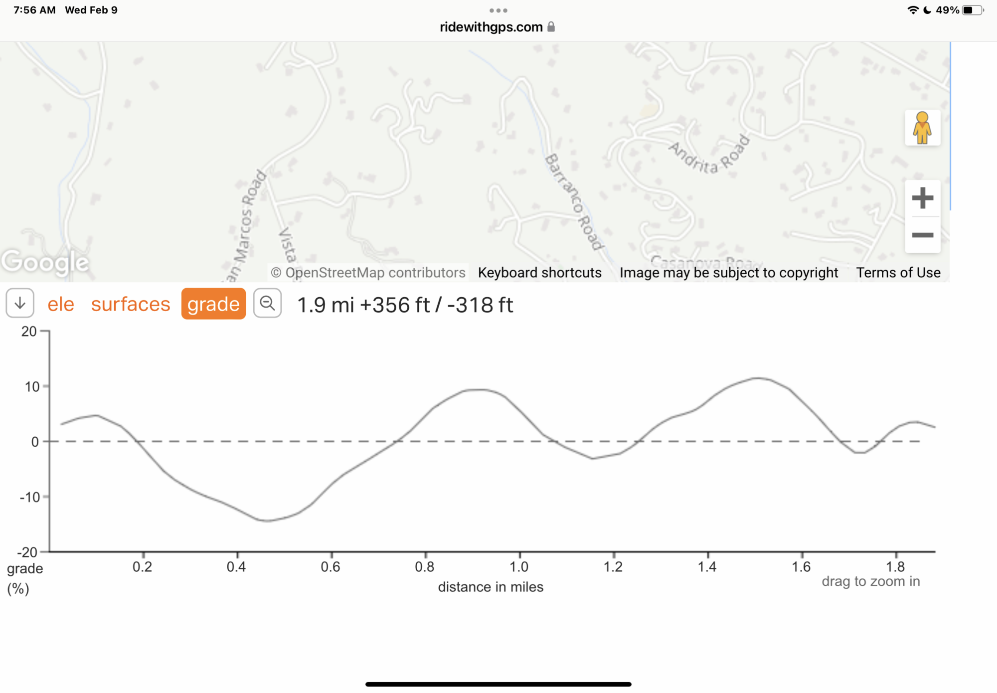

Looked at my route on RidewithGPS and got this grade map:
Looks like you have some climbs that approach 10%. That is a substantial grade to overcome if your gearing is too high. Think what would happen if your were stopped at the bottom of a hill in your car and attempted to accelerate up the hill from a standing start in third gear (out of maybe four) with a standard shift. Your motor would stall and most likely cause damage to your clutch. Same principle with a bicycle. You need the appropriate gearing to start climbing the hill and maintain enough speed so you do not tip over (around 3 m.p.h.) If you are geared too high, you run the risk of putting too much torque on your knees and causing damage. If your bike is geared properly, you should have no issues with climbing a 10% grade using the wattage of the motor and also the wattage your body can add to produce the sufficient wattage to successfully climb the grade while protecting your knees from damage.
