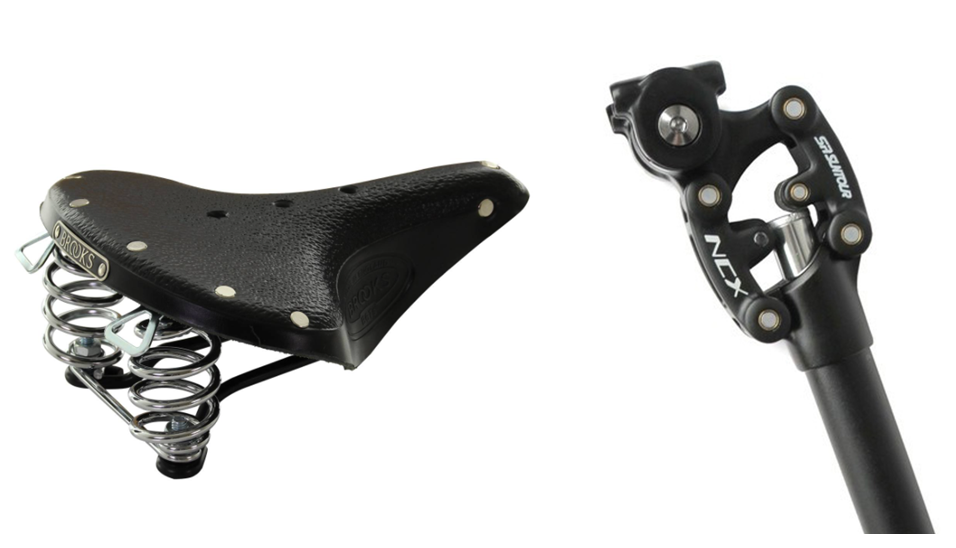

I'm curious if anyone has done a comparison between springs seats (e.g. Brooks, Velo, etc. ) vs suspension posts (e.g. Suntour, Kinekt, etc.).
Having been an avid mountain biker for years, I understand and have enjoyed a fully suspended bike. However those days are now over, and now I'm more into just riding a 20" un-suspended folding eBike for pleasure and limiting my routes to streets, bike paths and the occasional gravel road.
With the amount of travel a suspension post offers, I'm thinking this may be a bit of an over kill for the road surfaces I plan to ride on.
On the other hand, is a spring seat really effective in taking some of the shocks and bumps out of rough pavement, farm or gravel roads?
At the end of the day, I just want to minimize butt and back pain. I'd appreciate any links or information about the pros and cons of each system or any head-to-head comparisons of both.

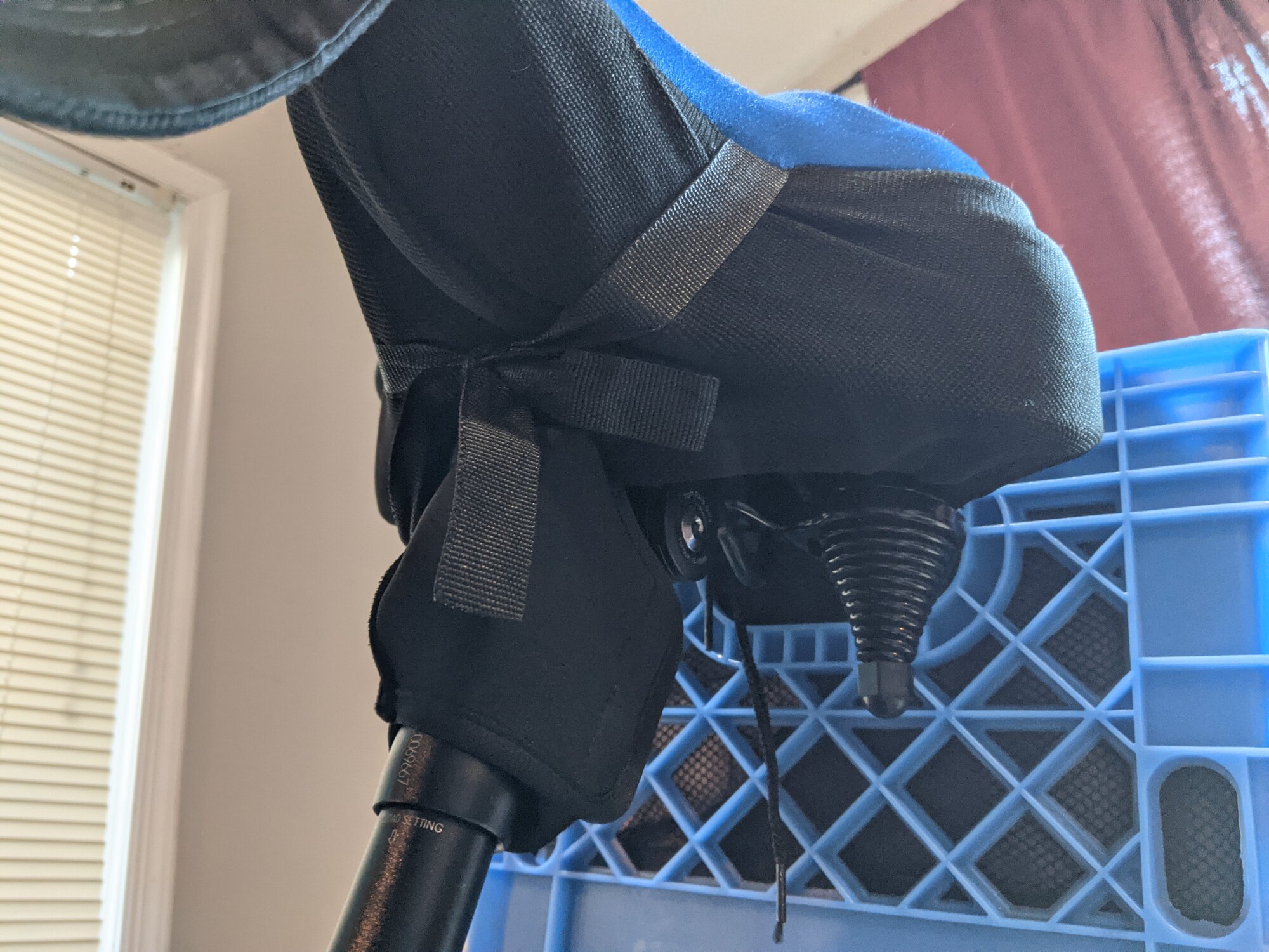

All of mine are used with the Lycra covered Cloud 9 seat.

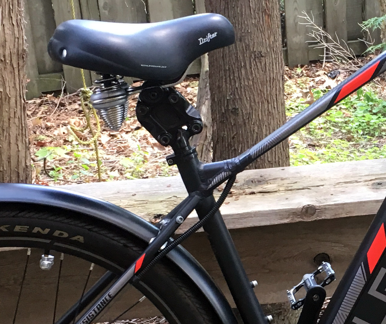

This is how I roll on my daily commute. Some road,
some dirt trail.
it's like riding my couch to work. Awesome.

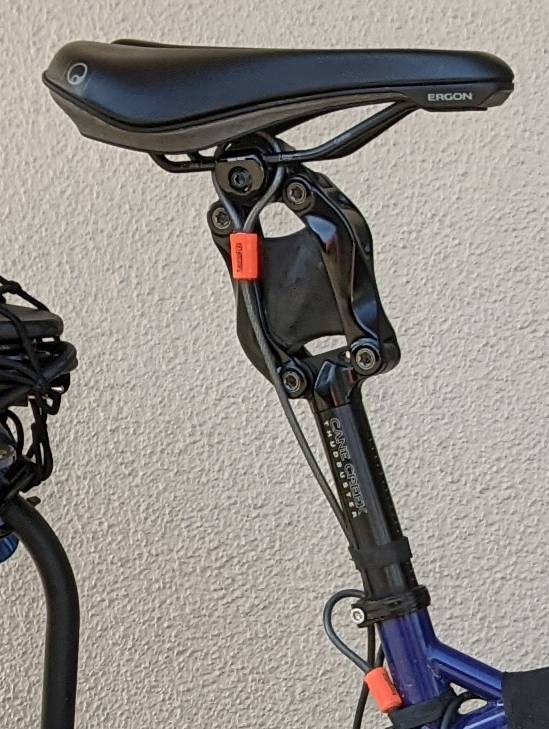

My current setup is a Redshift ShockStop suspension post and a regular saddle (Ergon), and it works well enough that I don't feel saddle sore after a 60km ride (about 70% asphalt/30% gravel-dirt / 2km of cobblestone).
Conversely the (admittedly cheaper) spring seats I've used never smoothed out the bumps in the same way, and I could start feeling the saddle soreness kick in well before the end of a day trip. Some of that could be because such seats were a bit wide for my tastes as well.

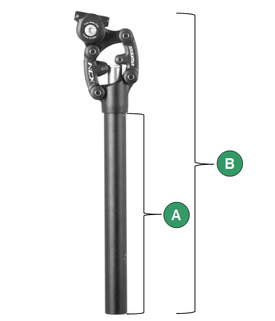

Sorry for a stupid question, but the SR Suntour SP12-NCX suspension seat post specifications call out a seat post diameter of 31.6 mm and a 400mm length.
Is the 400mm length for dimension "A" (just the post) or dimension "B" - overall length? I'm guessing they mean "A" but would appreciate confirmation.
As noted previously, my current fixed seat post is 500mm, so I hoping a 400mm post would be adequate to ensure it's long enough to be well anchored in the seat tube.

  • Seat tube length in 350mm and 400mm
I believe it is dimension “A” from the Japanese description which translated to “Seat tube length in 350mm and 400mm”.

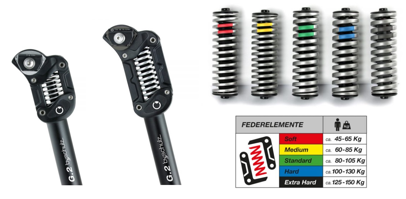

Here in Europe, there's another brand you may not be aware of which is also a parallelogram-style suspension post. The company is called BySchultz and is located in Saarbrucken, Germany (https://byschulz.com). Their seat posts are available in two different suspension travel lengths, five spring ratings and configurations (fixed vs. drop post) and is comparable in price to others you mentioned. The two models shown below have 30mm (G.2 ST) and 50mm (G.2 LT) of suspension travel. I've attached their product guide for anyone who might be interested.
From what I have read, the elastomer dampening seats can be less effective in colder weather, but at what temperature does that really come into being an issue? Personally, I don't see myself out in anything below 10°C so I don't think it's really a major concern. Of course spring vs. elastomer is just one more topic for debate. 🤪
Just curious if anyone has any experience with BySchultz seat posts?
