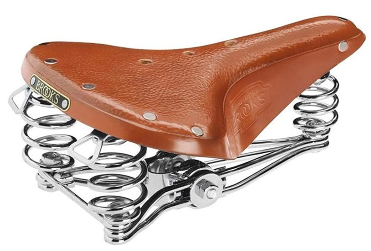

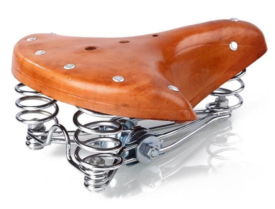

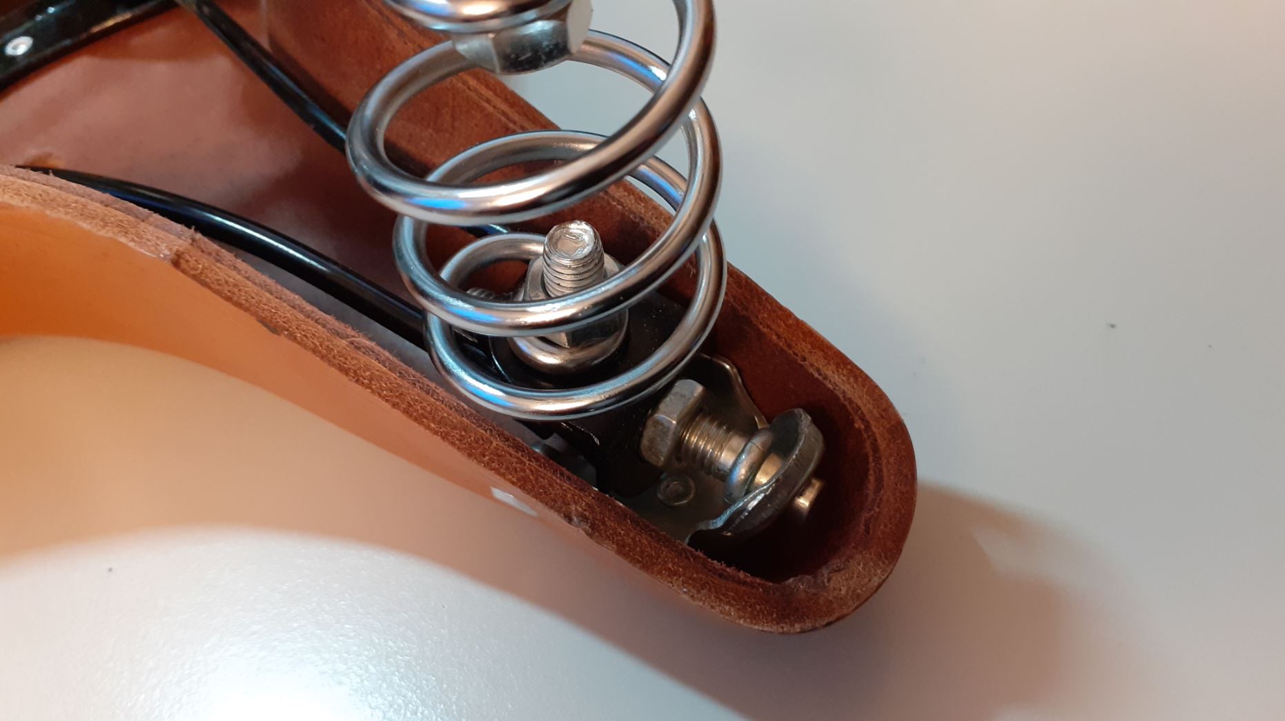

I ordered a Brooks B73 knock-off saddle from Amazon just to try it out. For 30-Euro I can get a feel for how a spring seat performs and won't feel bad for tossing it if it doesn't work out.
I have the B67 like that missing the front spring. There can be noticeable movement side to side, be interesting to see how that front spring works. Should make the front end happy.

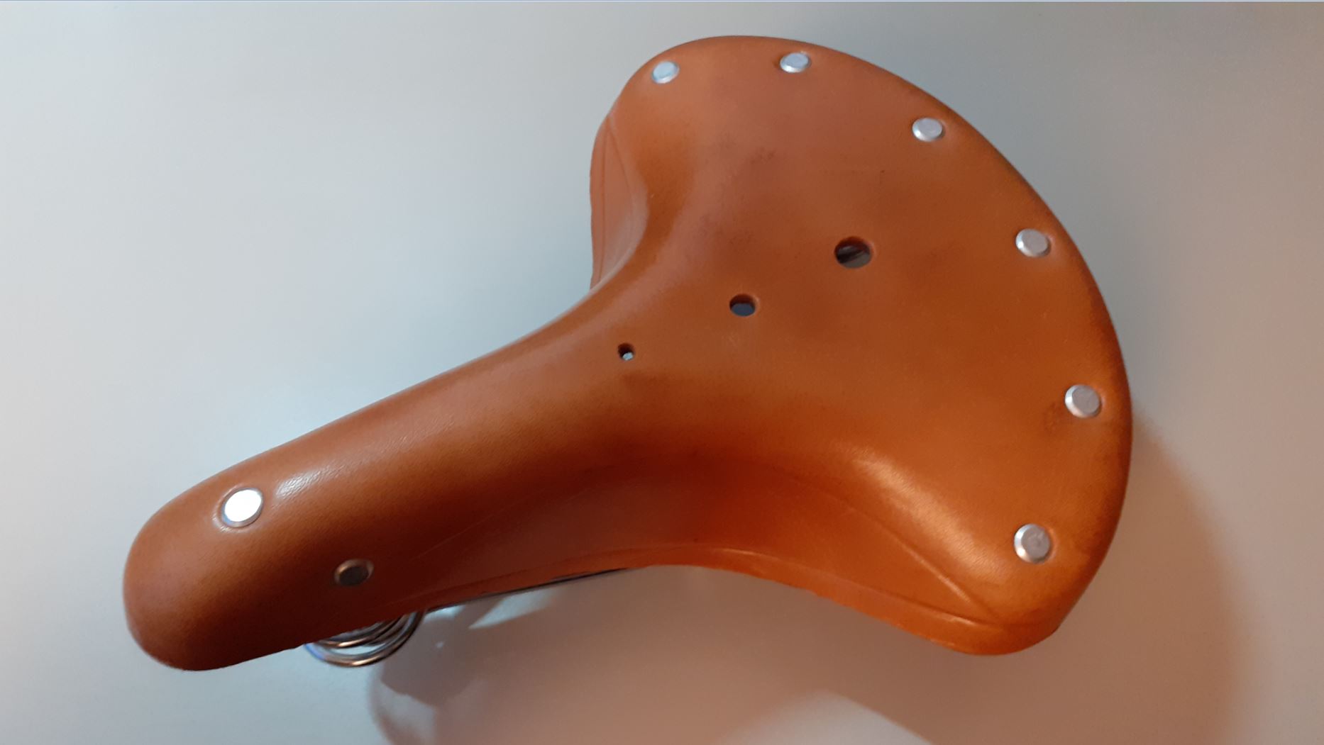

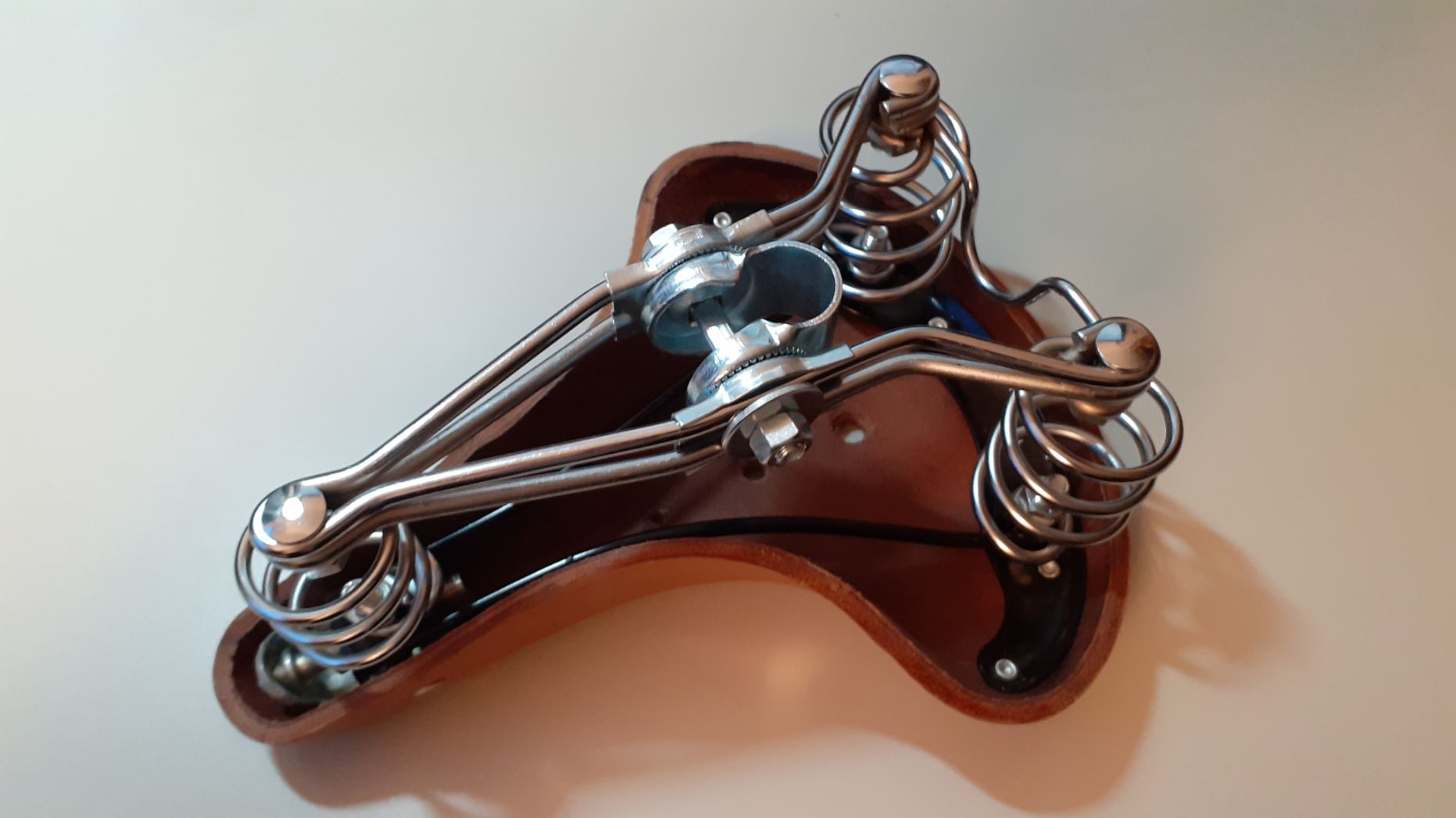

My new seat arrived today. It's actually not too bad given my low expectations for a no-name brand Chinese made saddle.
At least it's actually leather and not pressed cardboard as I saw with some others at this price range.
It's clearly no where near a Brooks B73 saddle for quality or craftsmanship. But let's see how this works out once the rain quits -

As the metal work on this saddle has a bright finish, I'm considering painting over it so it matches my bike which is matte black. The challenge is the springs which would probably cause normal paint to crack under use, therefore a rubberized paint might be the better option.
Does anyone have experience with these paints, or another brand, which might be more suitable for this application?
• Dupli-Color Custom Wrap
• Mibenco Liquid Rubber Spray
• Plasti Dip spray
Regarding painting the bright work, my focus would be on proper prep (clean, no leftover oil from production!), including a light scuff with scotch brite pad or similar, and an attempt at keeping the paint as thin as possible. First coat should be just a misting, with no attempt at full coverage. Second coat, applied when the first doesn't come off on your finger, but not fully dried, should just cover. Rustoleum should be fine....
I personally think you will have trouble getting paint to stick. When it flex’s I think the paint will want to flake off. Plasti dip would work the best.

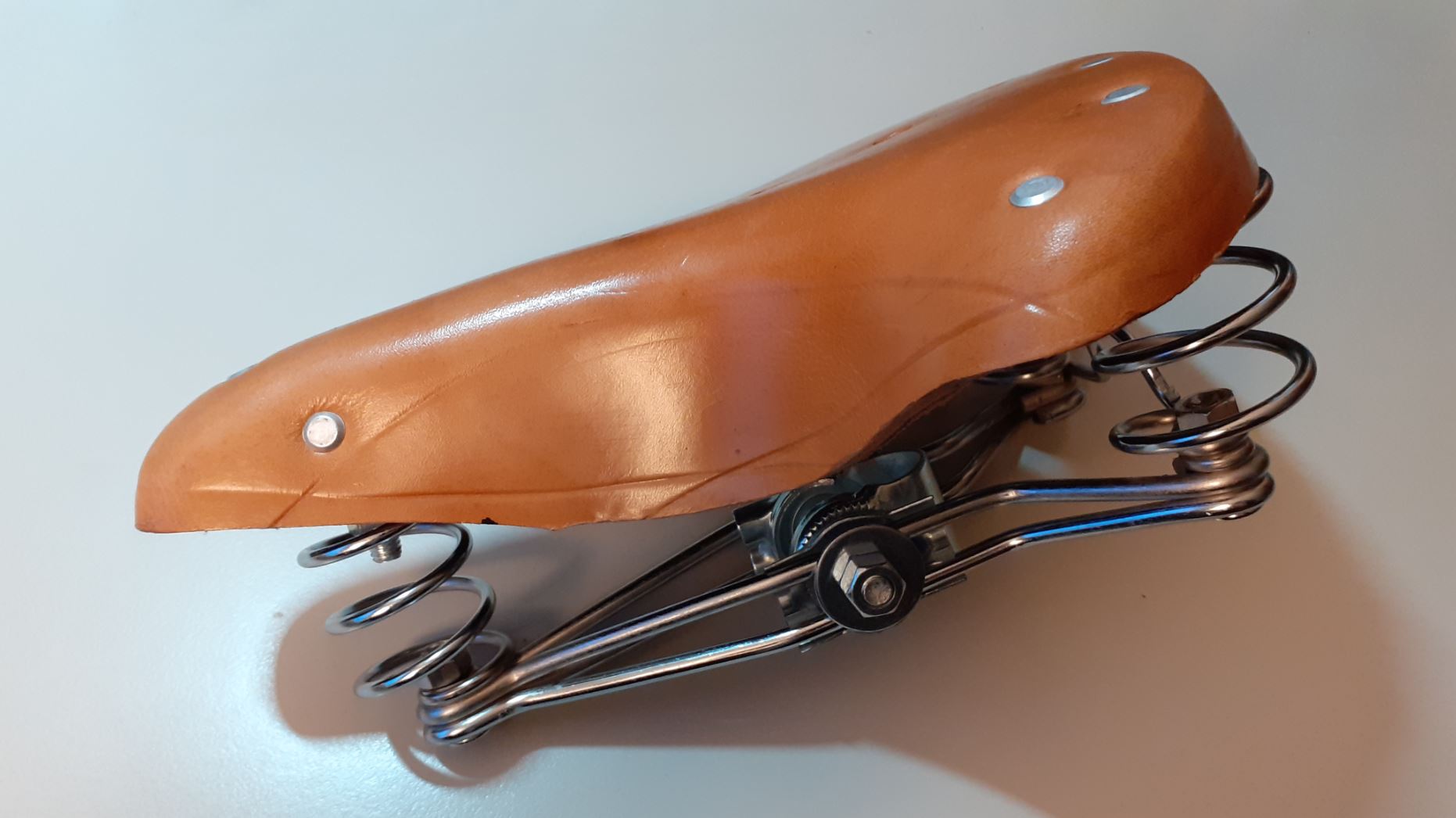

Well after a brief 10-km run on road, farm road and gravel roads, this saddle did not disappoint. I weigh 93kg and the spring suspension was definitely adequate for my needs without being a trampoline or squirming about under my weight. It was completely silent and after a few stops to readjust the fore-aft position and sort out the height, I'm not unhappy with it at all. The leather is quite hard, but from everything I've read this is not uncommon until its "broken in" a bit. When this wears out or fails, I will seriously consider an upgrade to a real Brooks B73. But for the moment, this is a suitable alternative to a saddle at nearly 5x the price.
I'd leave the seat alone re paint. Try it and see if it bothers you that much. That is chromed and might end up looking worse than you started. That bull hide will never 'break in' unless you sweat on it or put something else like the neatsfoot oil. Course, if it doesn't break in, your ass might.
