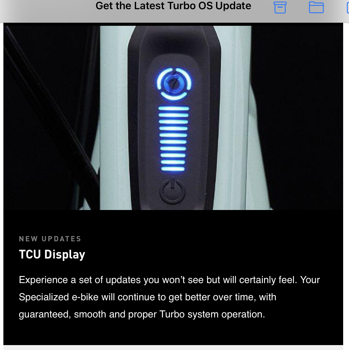

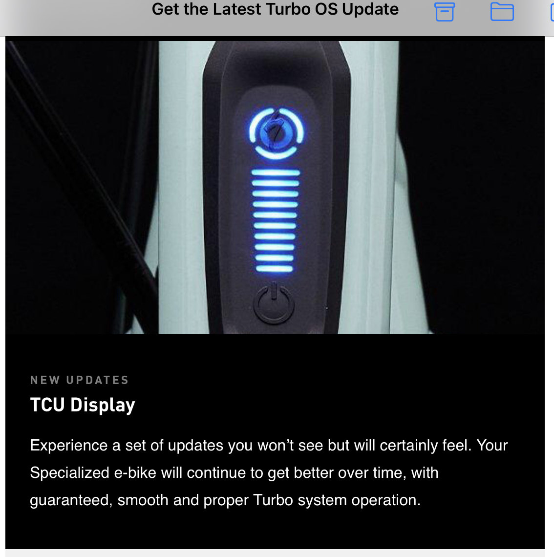

Did everyone get an email from Specialized about updates to Turbo e-bikes?
The email is very vague about the effect of the update for TCU-equipped models.
Has anyone done the update and noticed any differences, good or bad?
No idea. I didn't get any e-mail, and my Vado SL needs no updates. That is, "Display" needs an update but what does "Display" actually mean? The TCU or TCD?
I got the email. If you watch the video it is clear they are referring to the Mastermind TCU that now comes with the 2022 Vado Sl 5.0 and the standard i.e. non SL new bikes. One hopes they will make this TCU available for older bikes so one can update firmware over the air, and most importantly get the added benefit of theft protection via a personal pin.

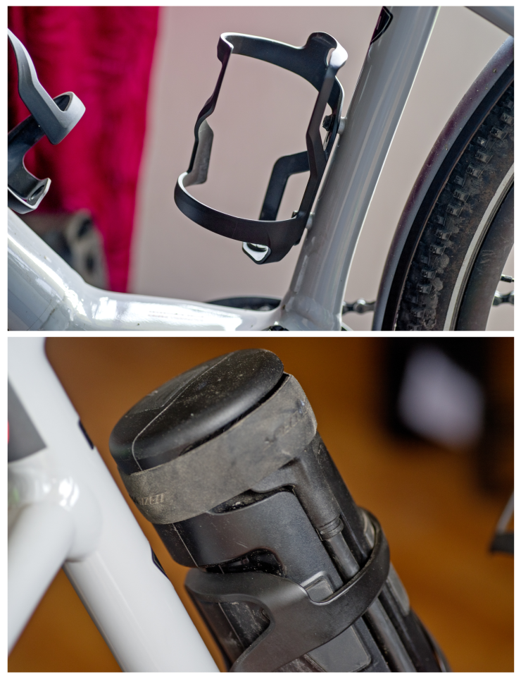

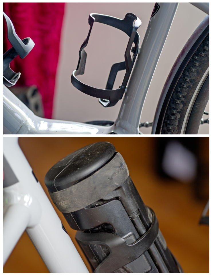

By the way (maybe Stefan knows this), if you get a range extender, where does it mount? Both the bottle cage mounting points that I see are farther away from the plug-in than on a non-step-thru frame. Do they make an extra long cable?
Stefan: It is not saying the display will get an update. It is saying that bikes equipped with the original TCU display will also benefit from the updates to the underlying control system, and that the effects of the update will be felt rather than seen. It does not give any details of what aspects have been altered, but I get the impression it is more like minor tweaking rather than major changes.
Richard could be right. Here are the instructions that came with the email ( I'm not at my home where my bike is to see if there really is an update for the older TCU) but anyone can give it a try and report back:
Get the Update​
  1. Download Mission Control. Already have it? Skip to step four.
  2. Open the app and create an account or log in with your Specialized account.
  3. Turn on your bike and connect it to the app.
  4. Tap the Diagnose icon on the home screen.
  5. Watch the tutorial video for additional support.
My TCU display (Vado SL 5.0 EQ) was updated today. All troublefree. I now appear to have a PIN/lock option which I didn't have before (or had never seen?). I think the other three changes are; 1) an indicator on the screen that a ride is being recorded, 2) an indication of the gear you're in if you have one of the fancy SRAM changers (doesn't apply to me) and 3) something to do with microtuning.
Did your bike come with the Mastermind TCU or the older TCU that just shows battery level? And are the indicators and pin function on mission control so you would need to ride with your phone?
The Specialized Zee Cage II (LEFT) and a rubber band come together with the Range Extender. The cage has to be installed to the cage mounting points on the seat tube. The 220 mm Road SL Cable is to be bought separately. Everything fits as good as a dream!
Top: Left view; Bottom: Right view.
Mastermind TCU (it's a 2022 model Vado SL 5.0) ... both the indicator and PIN function display on the TCU screen.
The step through does not have mounting points on the seat tube like the regular Vado Sl. It does have two sets of mounting points so one set is likely meant for the range extender. Hard to believe they wouldn't have a cable long enough to reach.
I'm sure it is doable to fit the 220 mm Road RE cable for the ST. It is clear to me that the distance from the top tube is sufficient. Note how rearwards the cage mounting points are! The cage will hold the top of the RE in the rearwards direction. A notch in the RE makes the thing resting immovable in the cage. The cable would have a short distance to the charging socket.
It still looks like it would take a longer cable, plus it would not route as cleanly due to the curve it would have to take. But maybe we should just wait and see if someone with a ST will get one and report back.
Doug... I don't think Specialized could made that grave design mistake :) SL is a very well organized system.
160 mm MTB RE Cable:
  • Levo SL
  • Kenevo SL
220 mm Road RE Cable:
  • Creo
  • Vado SL
  • Como SL
