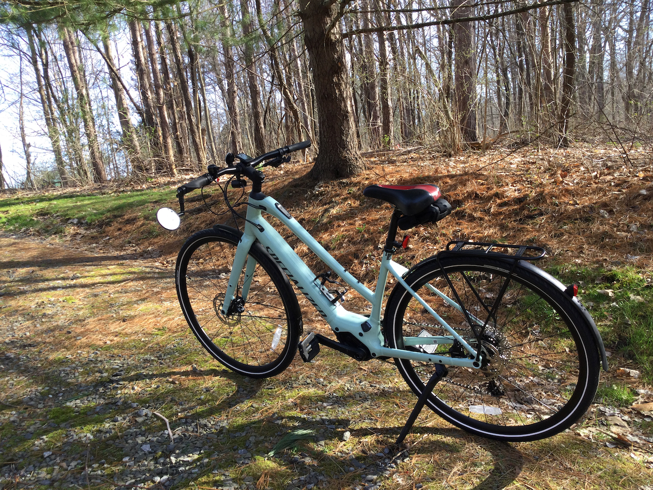

EQ vs non-EQ. Step-Over vs. Step-Through
For the Poland's condition, the EQ version is the must, although one could think of fitting MTB mudguards, and the rear rack is not really necessary for fitness rides (because Vado SL is indeed a fitness e-bike). I would just feel better with proper fenders and a rack. If one plans no swapping the seat-post for a suspension one, the tail-light placement under the saddle in non-EQ is smart, and the tail-light of the non-EQ is indeed not bad!
The exciting news is the Step-Through Vado SL shall appear in our market sometime in August. I'm strongly interested in buying Vado SL 4.0 EQ ST size M, White Sage colour!
