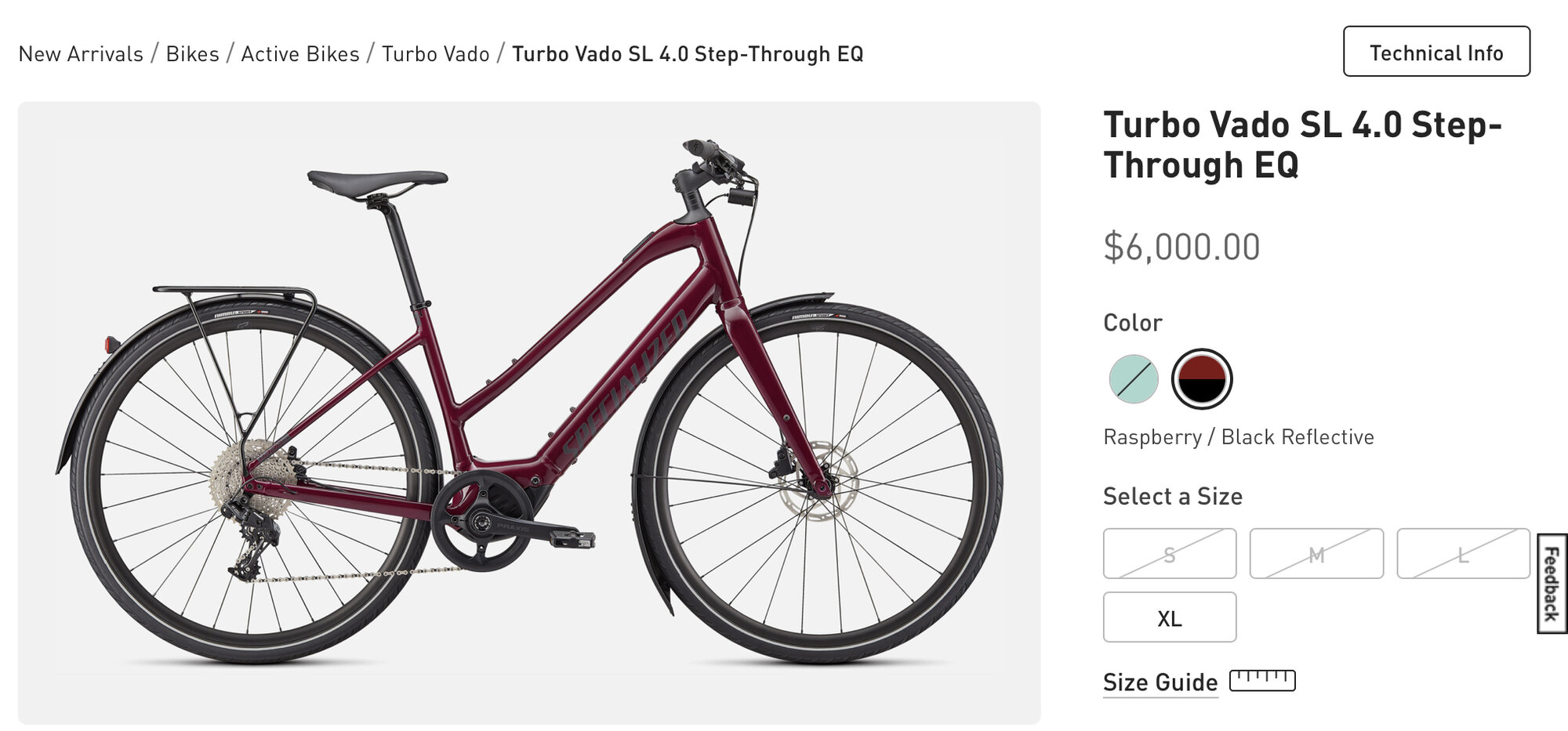

My sister walked into a LBS in Calgary last week and purchased a new Vado 5 SL EQ. It was quite a shock to her that they actually had any stock left. Mind you it was a step through which she had her mind set on already.
This seems to be the only Vado SL available in Australia. It is an unusual combo - step-through in XL. When I bought mine last September, there were only 2 listed (non step-through) both size L, which was what I wanted. I don’t think any new ones have arrived in Australia in the last 6 months.
