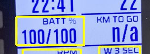

The 120 screen configurations do not appear to include the separate display of internal and RE battery ... at least, it's not an option I'm offered via Mission Control. I suppose it's possible that the option might appear if I had a range extender battery, but I suspect not.
I think the integrated value such as 150% that would appear in the display.
MC reports 150% in the main screen, and it shows individual levels under Diagnosis.
There is no separate level display for the RE. The "120 screen configs" is just a gimmick using combinatorics: there are several choices of screen layout selecting the number of fields and relative sizes, then for each field there are X different parameters that can be displayed and they just multiply them out. 120 is mildly impressive, but if you did the same for a Garmin Edge, I would think that the result would be several thousand!
