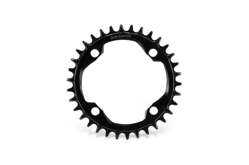

I don't think I've seen a 40t chainring around, I'd like to not buy some noname stuff and ruin the chain or something, and the often referenced RaceFace chainrings only go up to 38 it seems so I picked that.
Look up the brand name of Garbaruk. They make everything, and at high quality. In the EU.

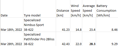

Let me give a comparison between the performance of two similar rides on two different tyre sets. Almost the same distance. Flat terrain. 100% Turbo mode. The intention to complete the ride as fast as possible. In both cases, it was a loop ride with the wind effect cancelled by the loop.
What could improve the average speed that much if not the tyres?
subtlety of the wind conditions, battery consumption, your own energy level or riding position, the distribution of higher and lower speeds... there is simply no way supported by physics that tires (of the same size no less) make a bike 17% faster! winds on loops also don't alway cancel, because it takes so much more power to ride fast than slow, there are crosswind effects, trees or hills or buildings shield the wind from some directions, but not others, etc. you consumed 10% more battery on the faster ride, which probably means you also pedaled slightly harder.
as a reference, the rolling resistance (at 28.8km/h) of the 42-622 pathfinder pro at 36psi documented as 24.1 watts. the worst gravel tire they ever documented at a similar size is at 33.9, and the very very worst mountain bike tire they ever tested was at 38.5. fat bike tires, at 12psi (!) are in the 30-45 watt range per tire.
being very optimistic, the rolling resistance of a pair of nimbus sports might be 25-30 watts more, assuming they're as slow as the worst mountain bike tire BRR has ever tested. might be enough to go from 26 to 28kph. to truly compare, ride the bike in a flat loop a few times with one set, then change them and try it again. the difference in feel might be enormous - i agree that the right tires can TOTALLY transform the feel of a bike! - but the difference in actual performance is much, much less.
I'm sorry to dissapoint you but I ride my Vado SL every day and I have never been able to achieve such high speeds before :) The e-bike was like stuck at 25-26 km/h, with the maximum speed of 34 km/h. Now, I ride at 31 km/h easily, and my maximum speed (wind assisted) has been 46.8 km/h (the bike is derestricted). My Vado SL was a snail before...
