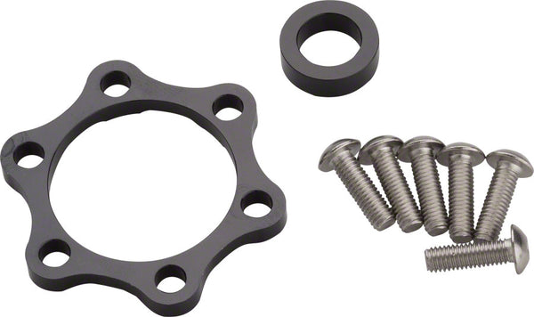

Hi All,
After testing the Vado 4 and the Vado S L4, I purchased the SL non-eq last weekend.
As I have a spare wheelset from my normal racing road bike, I was wondering if I could install it on the Vado SL.
The wheels are DT Swiss E1800 spline with 28mm tyres (real width on rim is 30mm).
Specialized specs I found:
Front Hub: 12x110mm, 24 Hole, Rear Hub: 12x148mm, 28 Hole
DT Swiss specs:
12x110mm and 12x142mm
So looks like the back hub is too narrow to fit.. I don't suppose you can compensate for that?
yeah - “road boost” wheel sizing. you can get an adapter, i’m not sure it’s something you’d want to frequently change, as this notes the wheel needs to be re-dished by 3mm.
