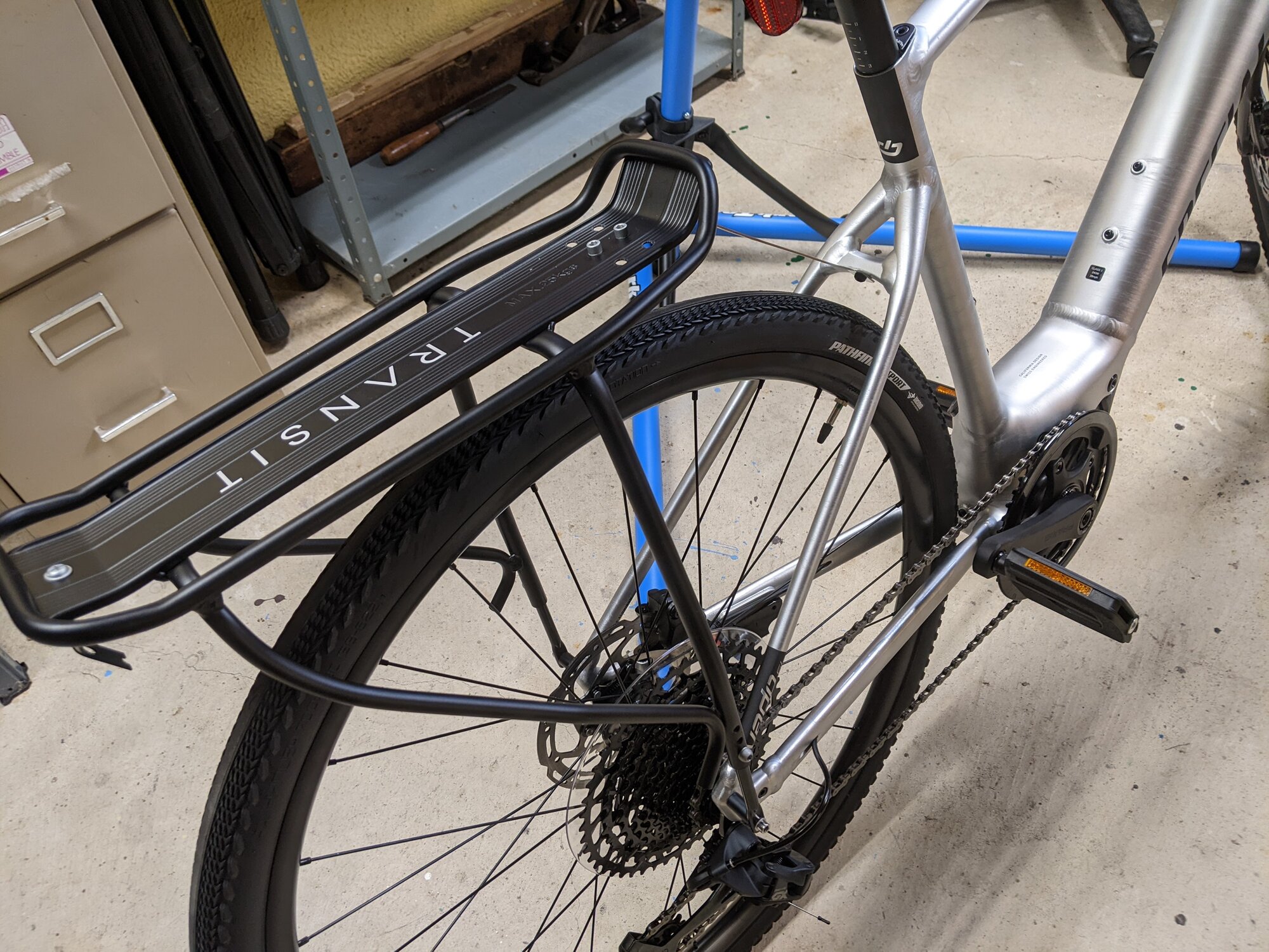

I did my first work on my new SL this morning, wherein I learned that I've lost a lot of mechanical dexterity over the years, but no problems in the end. The trickiest item to install was going to be the rack, so I did that first. This is the third bike that I've used this same model rack on since it's very light and "minimal", and the solid decking does pretty well as a rudimentary fender to keep mud off my back. Since the SL doesn't have the usual mounts on the seat stays, the tricky part was to mount it with a single, center-mounted strap using the existing screw on the seat stay bridge that I assume is for the fender on an EQ model. This required removing the rear wheel and gave me an appreciation for the design of that extra-long-cage 12-speed SRAM derailleur that has a really heavy spring to overcome when getting the wheel off. However, it went more smoothly than I expected and made for an overall nice installation.
In the photo below the support strap is viewed edge-on so you can't see it that well, but you can get the idea. By the way, that's a brand new Park 10.3 workstand that will be great for working on my e-bikes; way more stable than the old one that I had been trying to use.
That's the mounting point the shop used to mount my rack on my Creo.

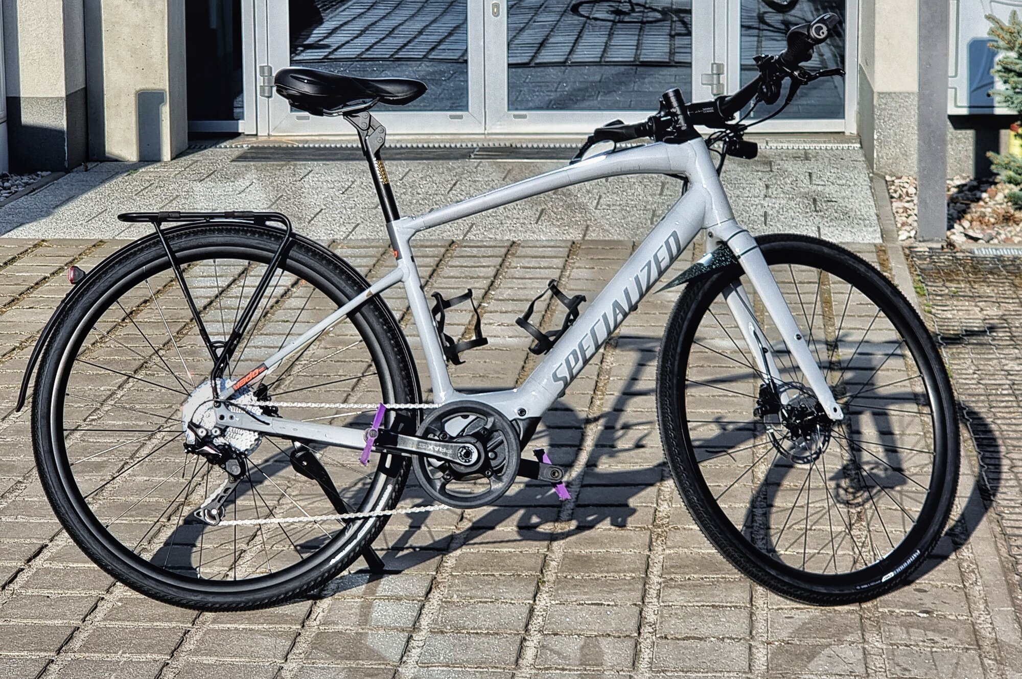

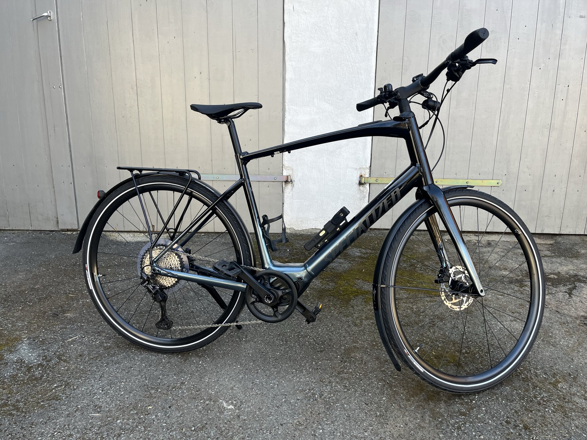

Snagged a quick pic in a short home-office break; it's pretty much stock so far with the range extender cage and a lock installed.
I do have a racktime Odin to snap on, bought a Garmin Edge Explore from a friend, and from there we will see. Thinking about nicer pedals, the stock ones are pretty boring for a beauty like this.
I like the fade colors.

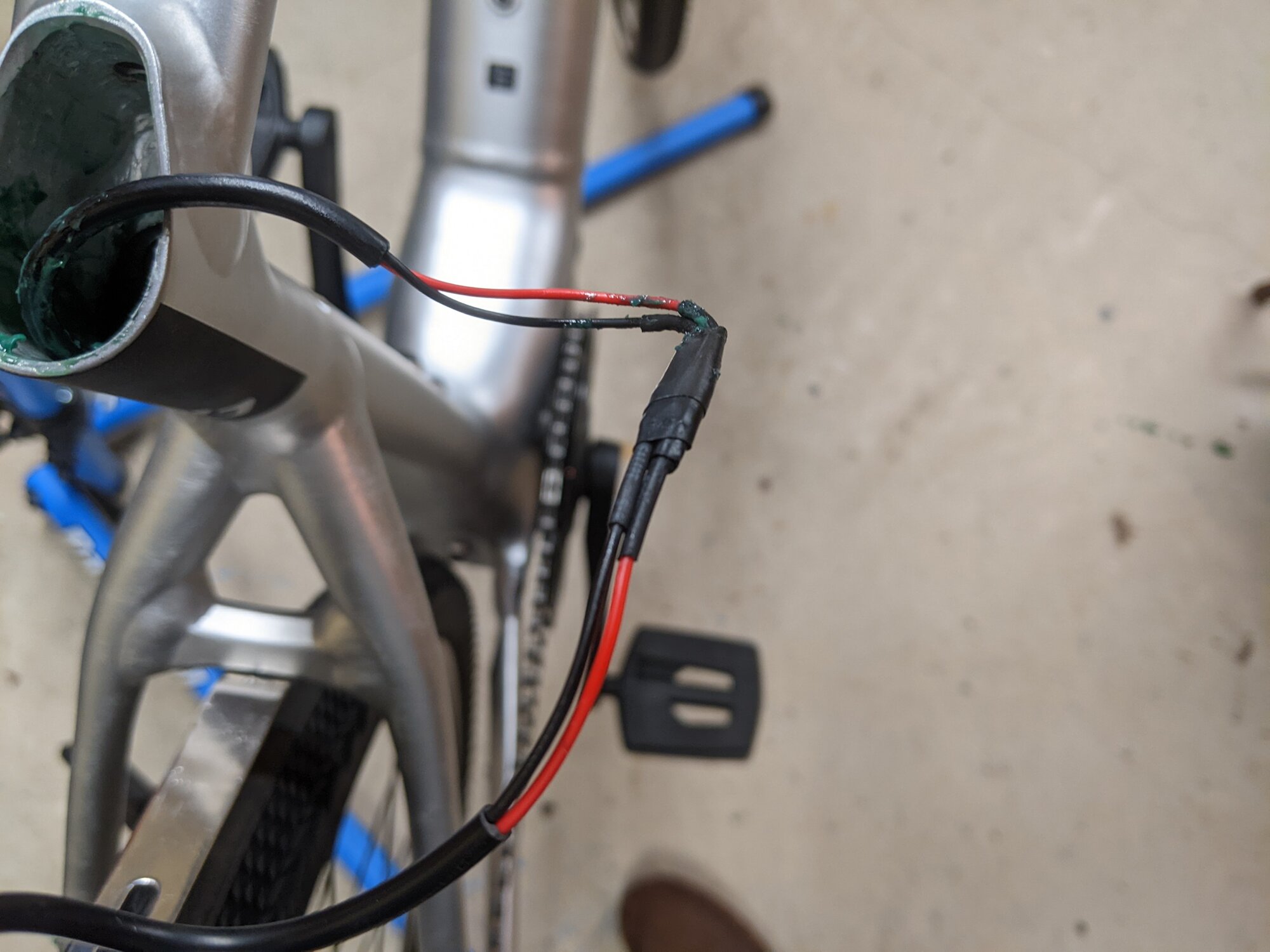

FYI, this is the information I was looking for about disconnecting the taillight on my 5.0. I was tipped off after talking to the mechanic at the LBS, although I'm sure I would have discovered it myself (glad I didn't just snip the cable higher up). I was able to take it apart at this point and used a couple short lengths of shrink wrap to protect the ends of the wires before taping them and pushing them back down in to the tubes. Mission accomplished.

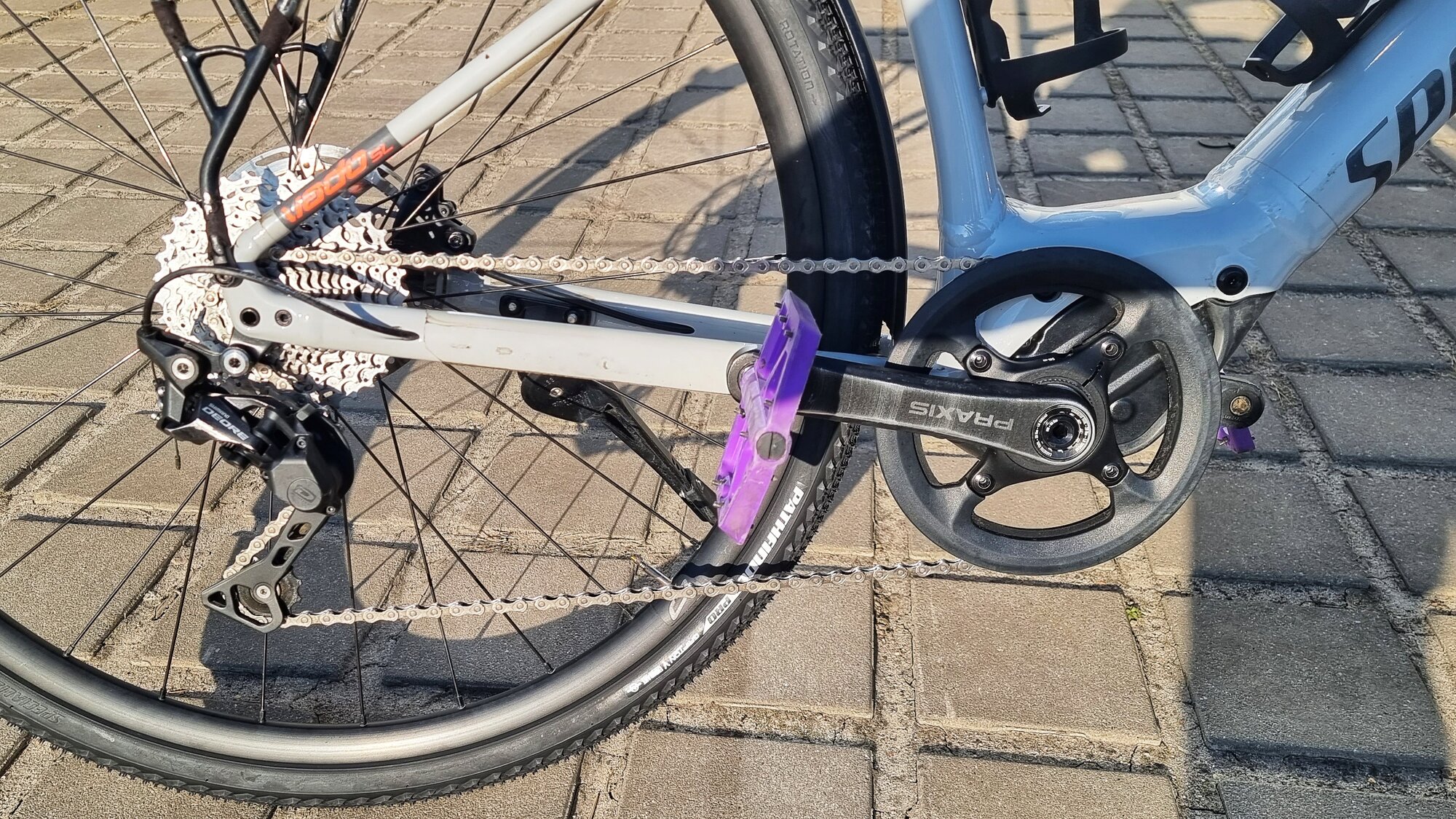

My Vado SL aka "HMS Fearless"...
Washed by Specialized Warsaw...
The drivetrain looks like new...

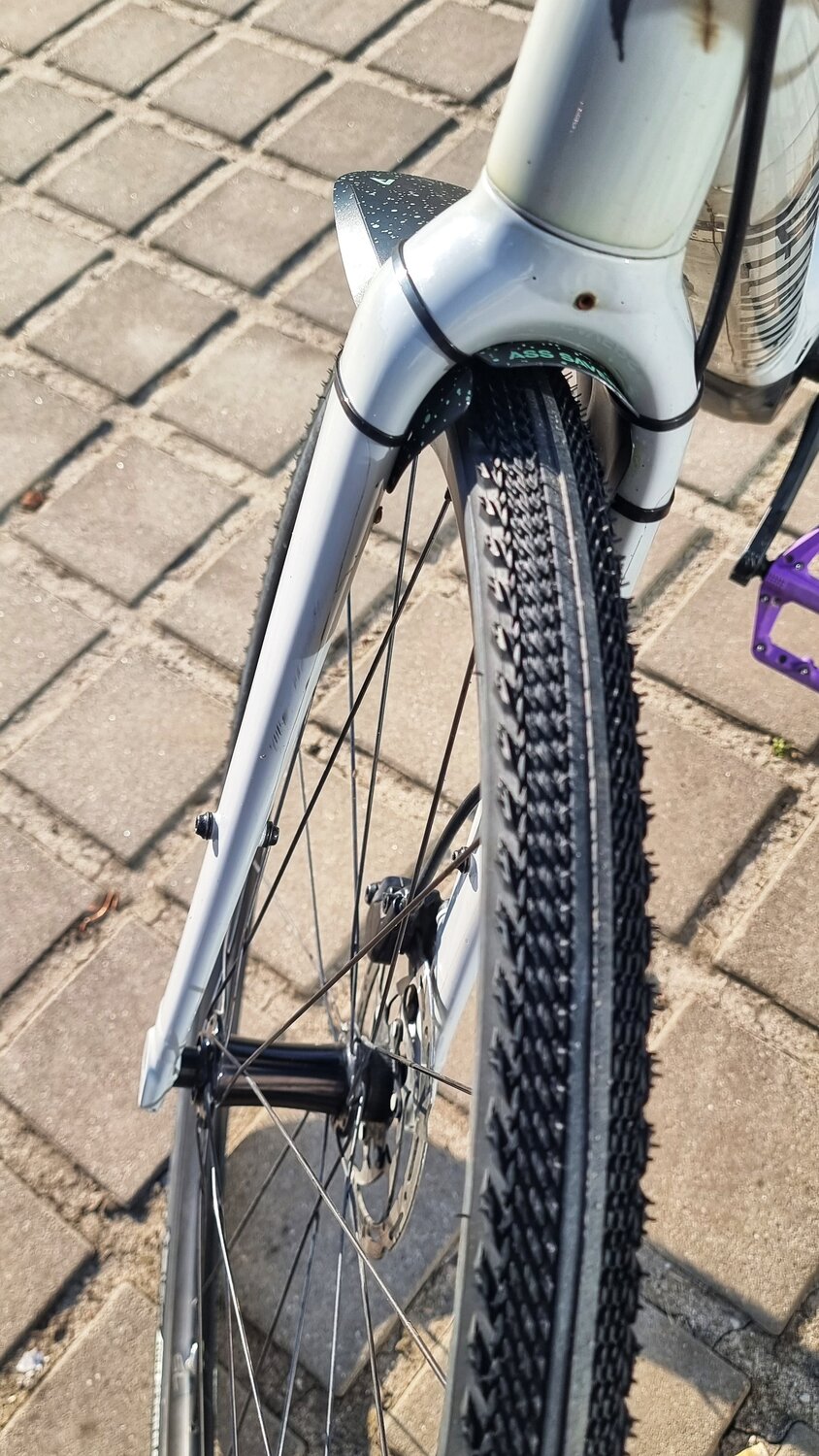

Front mudguard removed for the warm season and replaced with an Ass Saver. New set of Pathfinder Pro 2Bliss 38-622 tyres.
Is that a size M? One thing about my size L is that I have cage mounts on the underside of the top tube as well, so I can have two water bottles and the range extender connected. I might have to look into that Ass Saver, since the shield I was planning on using comes with straps that aren't long enough to go around the large SL downtube.
