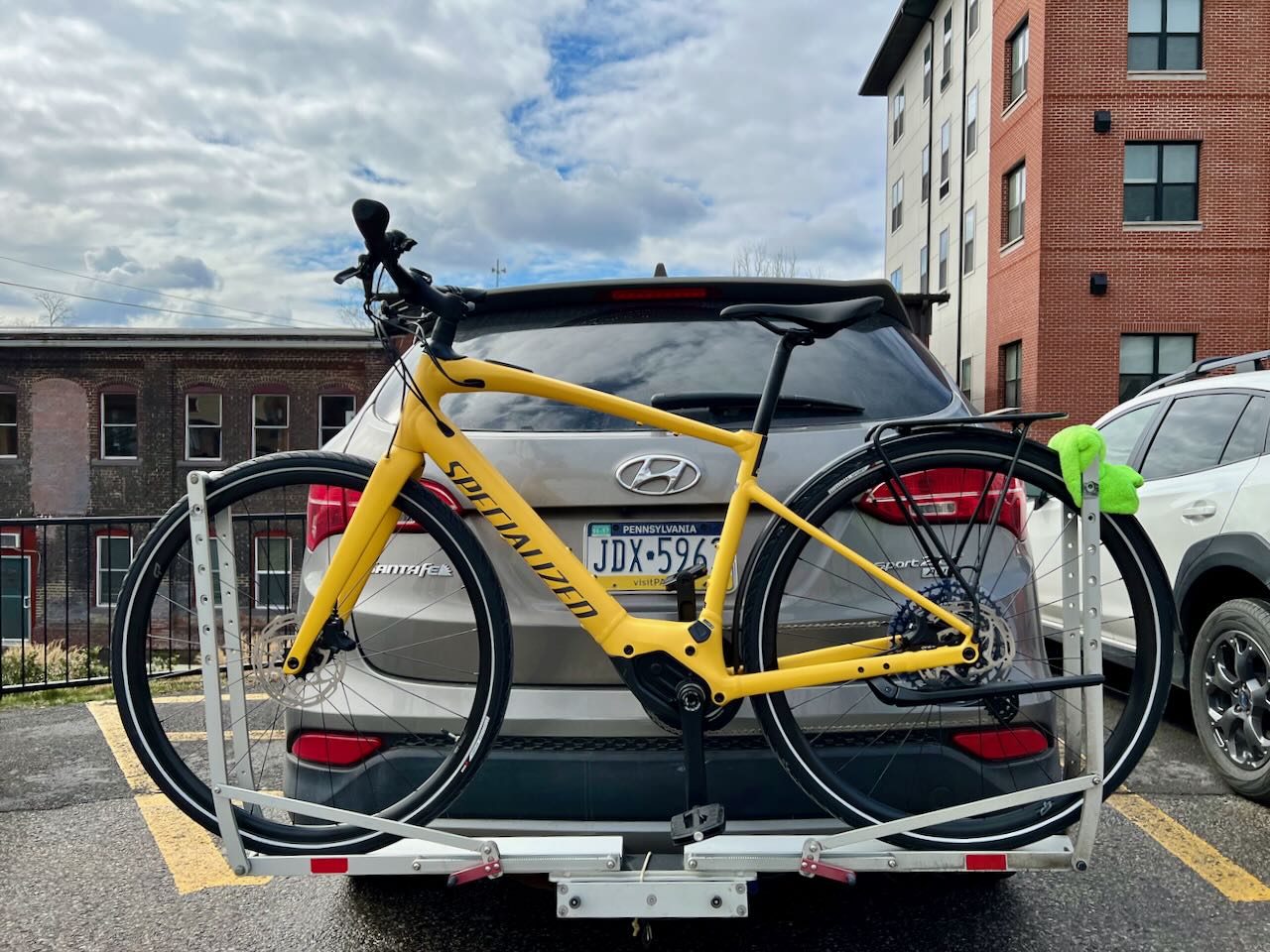

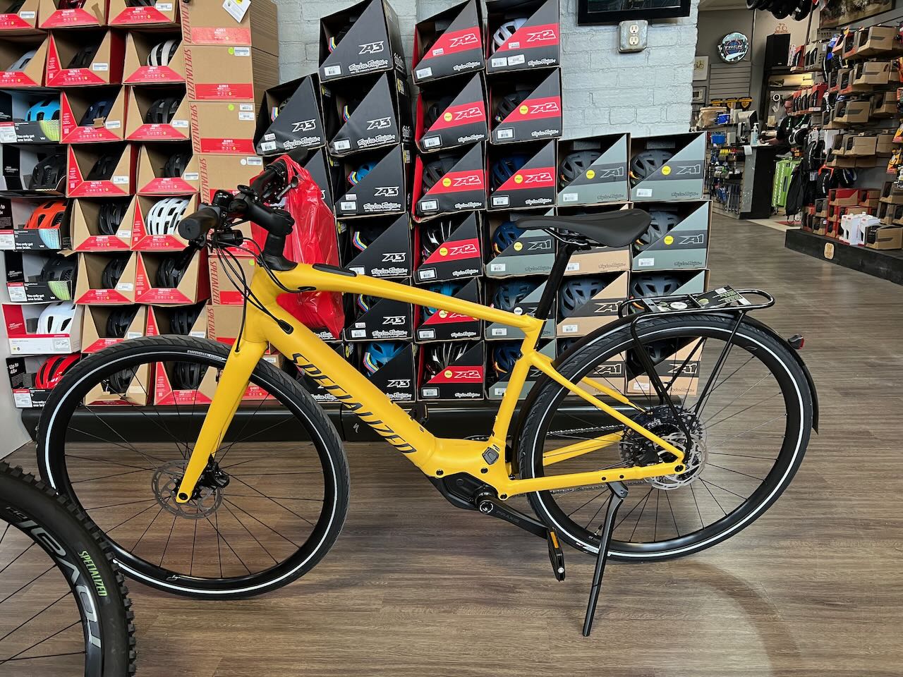

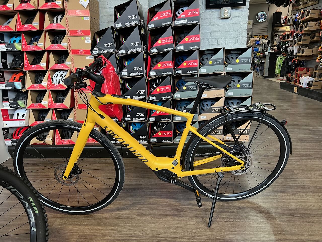

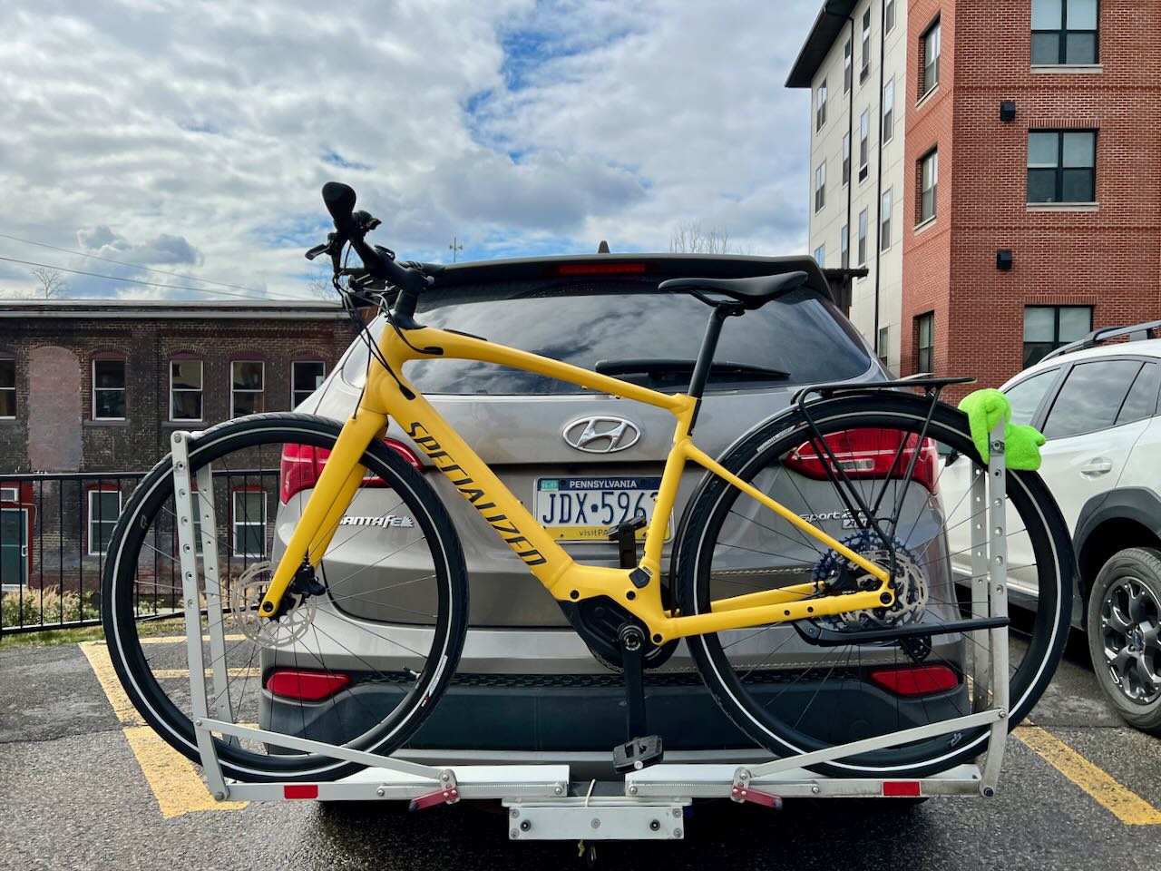

I have joined the club! 🍻
Called my LBS and asked for an ETA, they said the soonest would be August. Seen my size and color were available online, so I placed my order from the Specialized website on 3.8.22, it arrived on 3.11.22 and was available to be picked up on 3.15.22. I have some spare parts laying around to swap over to it and some I plan to purchase. But I'm hoping to actually get to take it out for a spin today to see how it fits, etc.
2022 Specialized Vado SL 5.0 EQ (37.46 lbs Medium, with pedals, both fenders, rack, fidlock bottle cage mounts)
Congratulations AdmChr :)
I dig the colour.
It's you only yellow, right ?
Congratulations on the bike! At least you get to ride yours where my new 5.0 will be sitting in my shop for another 8 weeks (doctor's orders) :mad:
I have to say that's the smallest front fender I've ever seen -- so small that it's invisible :). I assume you had taken it off (or it was never installed) to make it easier to carry on the type of rack you have. Thanks also for the weight figure; I'll be anxious to compare after I get mine loaded up, although I find myself to be turning into some sort of "weight weenie" lately (which is not very logical for an e-bike).
My non-EQ is only available in the brushed aluminum. It's nice, but I would sort of preferred a painted finish like yours. I am also installing a sidestand since most bikes I've ever owned had one -- including my old aluminum road bike. To me, not having one is a real PITA, especially as I often go on rides where we stop at a cafe for coffee, or even when I have to move it around the garage or do minor maintenance without putting it on a workstand. And probably due to my many years riding motorcycles, I have a visceral reaction to laying a bike down flat on the ground! :oops:

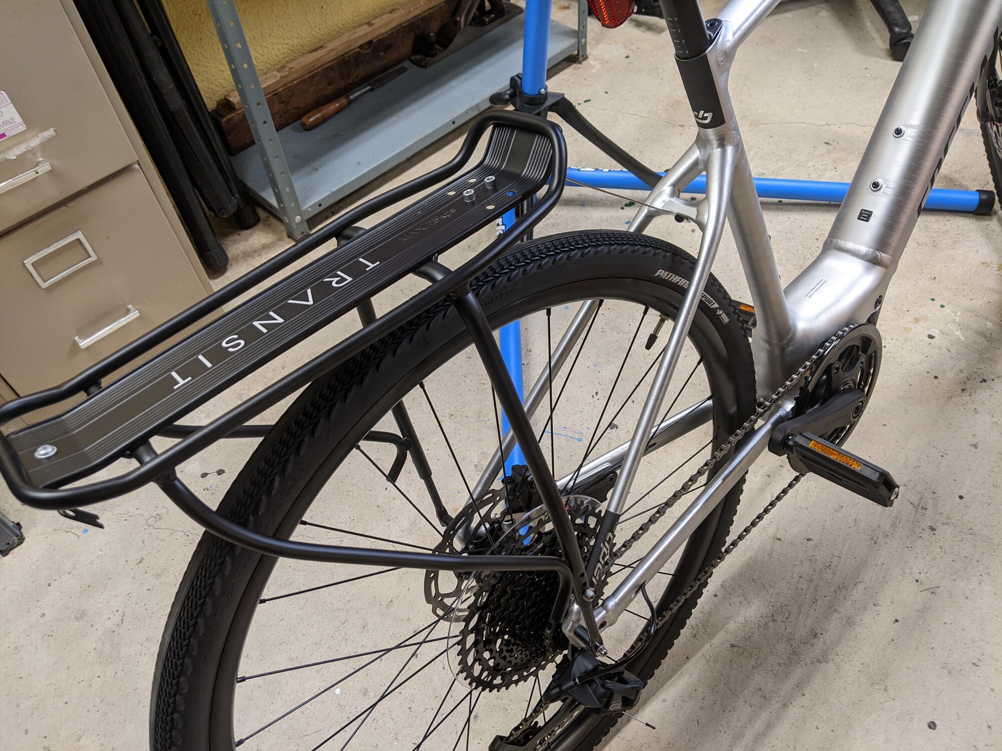

I did my first work on my new SL this morning, wherein I learned that I've lost a lot of mechanical dexterity over the years, but no problems in the end. The trickiest item to install was going to be the rack, so I did that first. This is the third bike that I've used this same model rack on since it's very light and "minimal", and the solid decking does pretty well as a rudimentary fender to keep mud off my back. Since the SL doesn't have the usual mounts on the seat stays, the tricky part was to mount it with a single, center-mounted strap using the existing screw on the seat stay bridge that I assume is for the fender on an EQ model. This required removing the rear wheel and gave me an appreciation for the design of that extra-long-cage 12-speed SRAM derailleur that has a really heavy spring to overcome when getting the wheel off. However, it went more smoothly than I expected and made for an overall nice installation.
In the photo below the support strap is viewed edge-on so you can't see it that well, but you can get the idea. By the way, that's a brand new Park 10.3 workstand that will be great for working on my e-bikes; way more stable than the old one that I had been trying to use.
