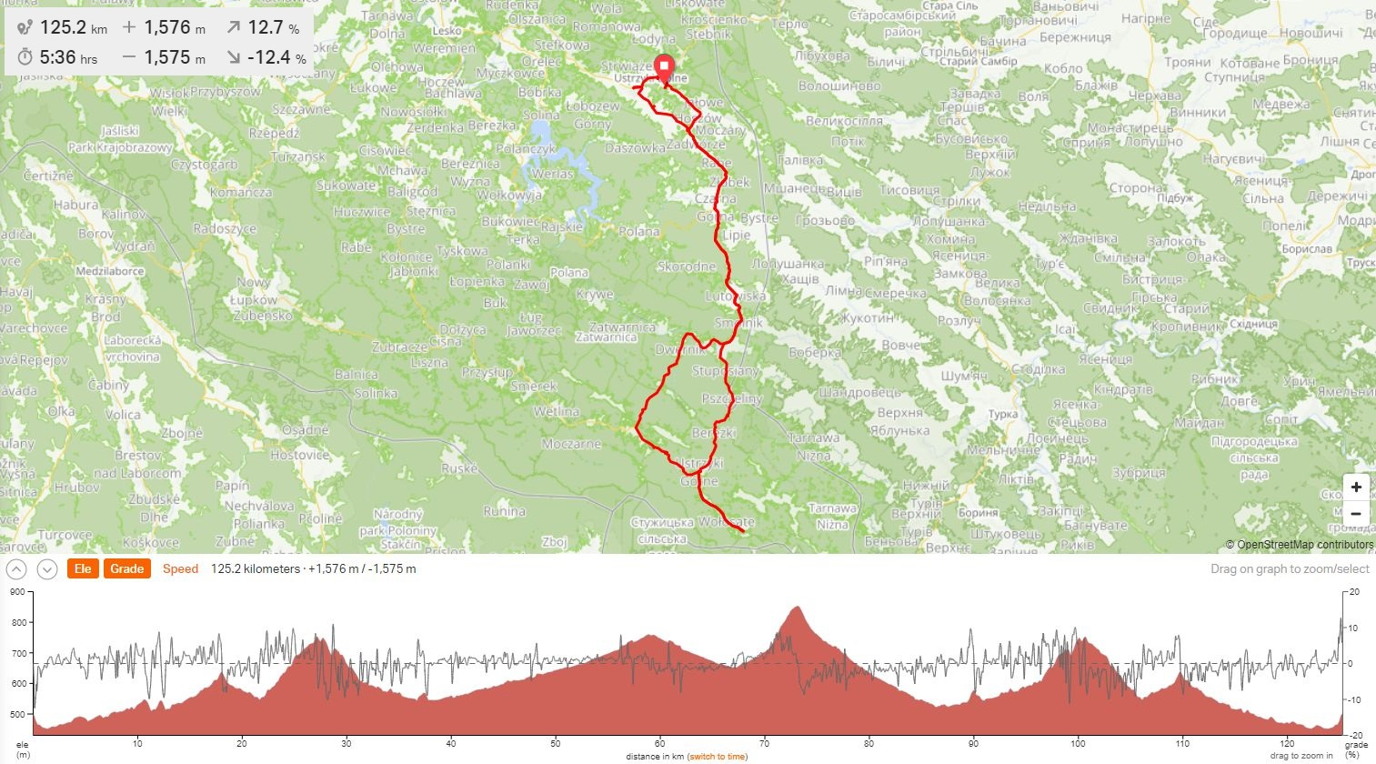

Let me tell you how all that looks like with a full power, 90 Nm/520 W Specialized motor and mountain-wise gearing (38-46T). You are on a very steep & long climb, and you have discovered you are in the granny gear and 100% Turbo. You crazily spin the crank and are feeling like a toddler on a kid bike. Your mouth gets dry, and your hands get numb. Still, you are riding but wish you were never born :)
Now, fancy the battery gets flat and you need to stop to replace it :D
