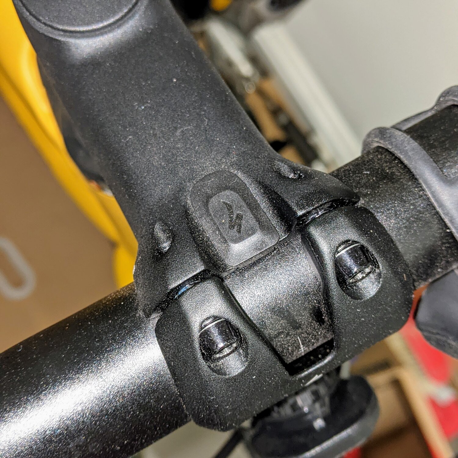

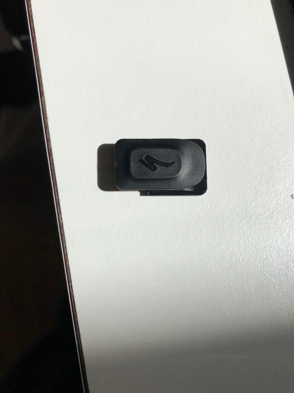

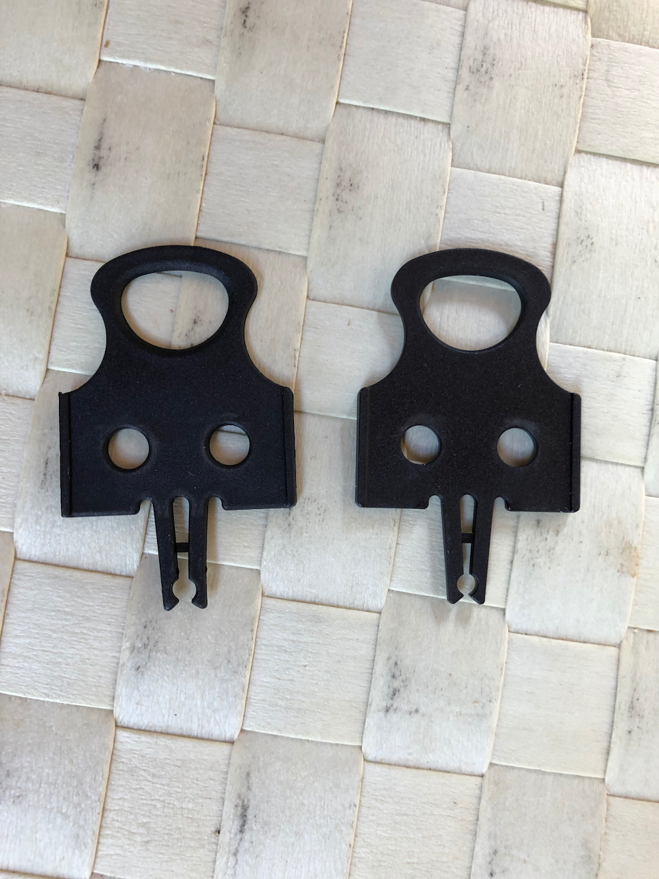

When I got my 4.0 Vado SL step-through a couple of weeks ago there were 3 black plastic objects included with the documentation. Two were identical and I figured out they are for protecting the brake pads from inadvertently closing when a wheel is taken off. Don't know what the 3rd object is or is for. Can anyone help? I've attached photos.
The third object is a blanking plate to be slotted into the stem in place of the bracket that holds the TCU (or whatever it's called on the Vado SL 4). I've got a SL 5.0 and it came with the bracket, but has the TCU in the frame, so I removed the bracket and used this blanking plate.

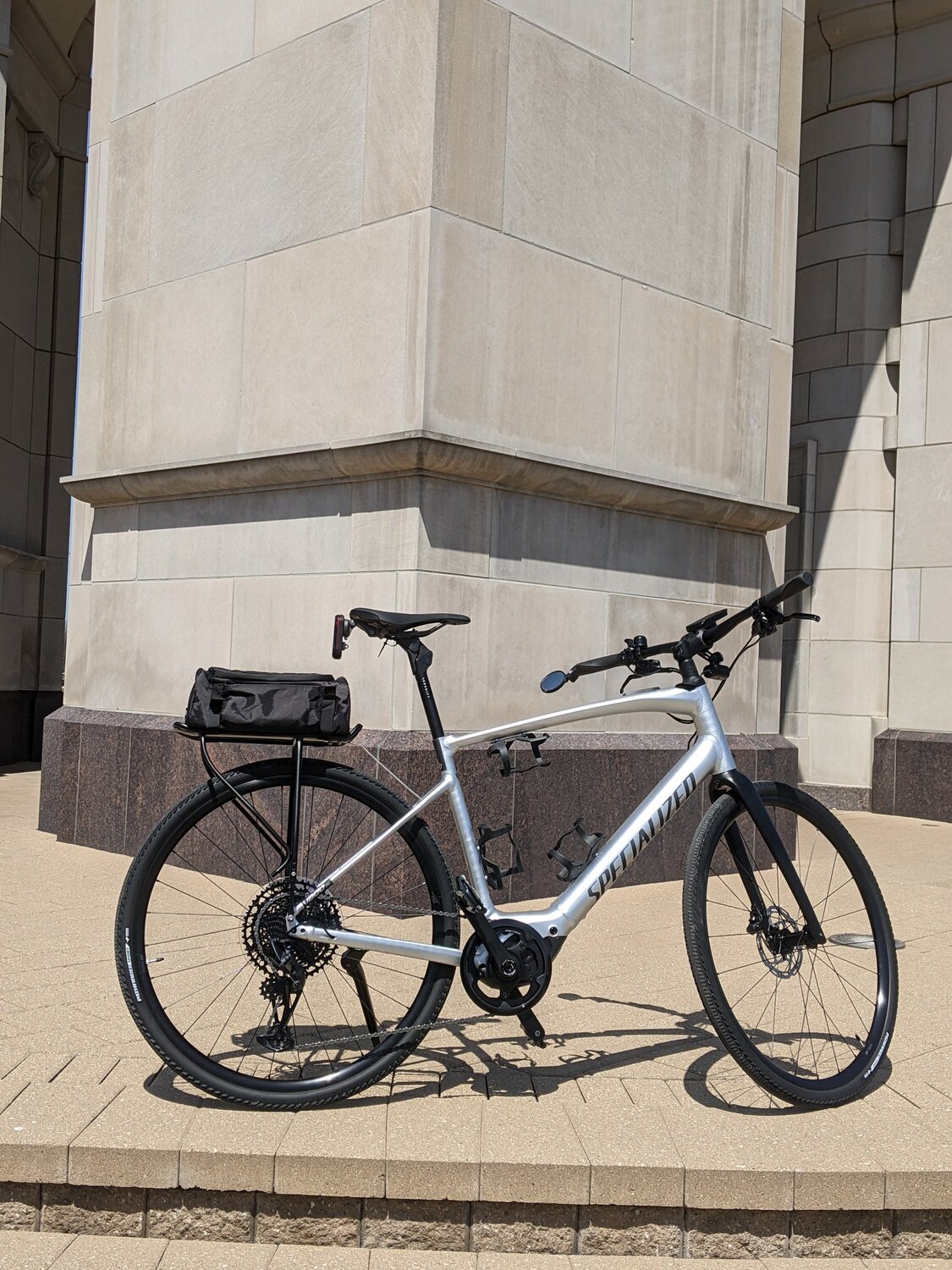

Sorry for the long post, but I’ve been waiting to get my SL 5.0 for literally two years, and then after I finally got it I had to wait a month before I was medically cleared to ride it. So after my first couple of rides I wanted to give my first impressions and analysis of what I’ve learned about it already. I also don’t want to sound like I’m dumping on the Vado 4.0 that I owned for those two years, but my feelings on that bike have always been colored by the “buyer’s remorse” that set in immediately when the SL bikes were announced a month or two after I’d bought it.

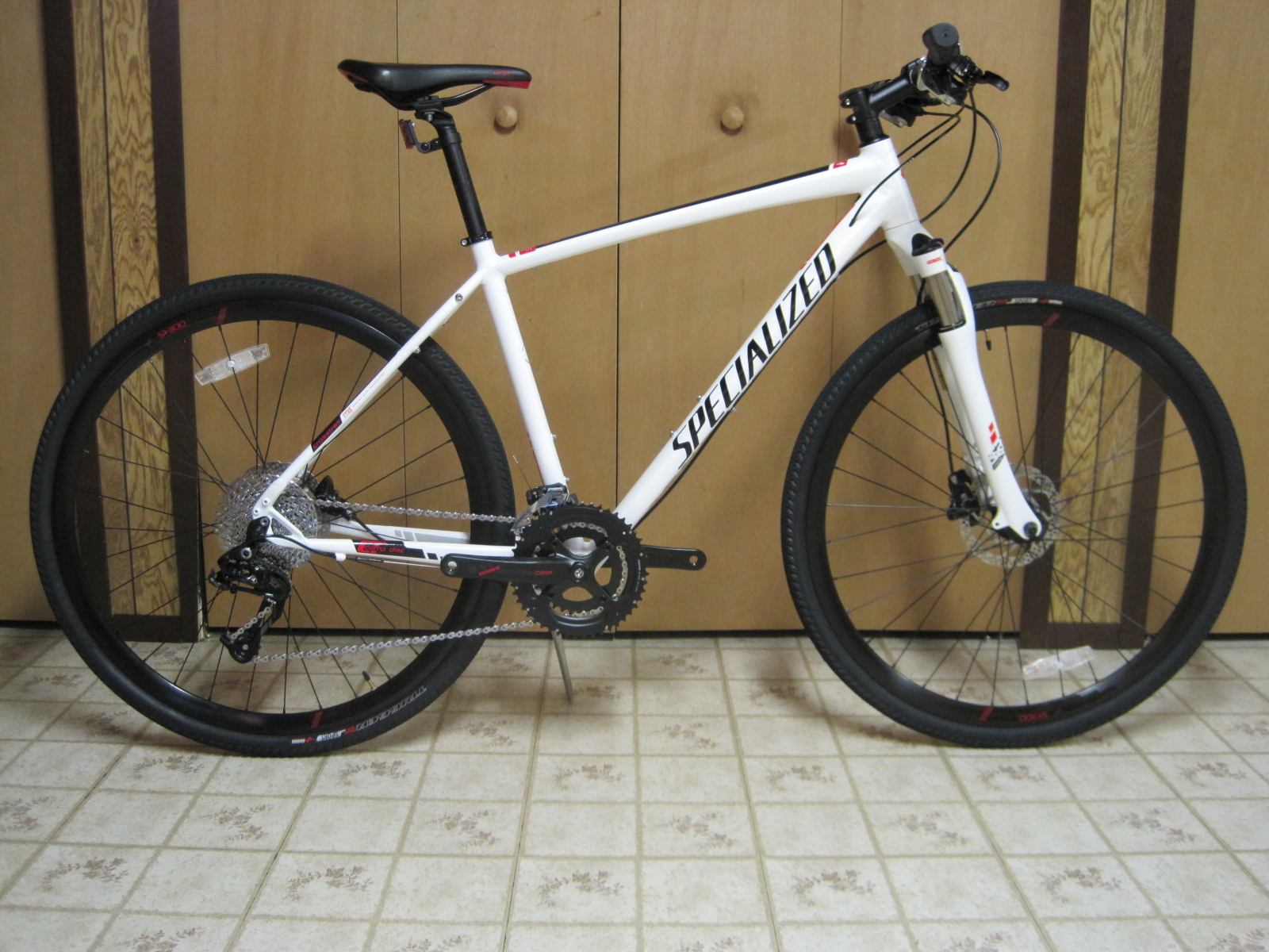

Before I got into e-bikes, my favorite go-to bike has been my 2013 Specialized Crosstrail “hybrid” (above) that has been 100% reliable with everything I’ve thrown at it. That includes riding across Missouri on the Katy Trail, riding from Pittsburgh to Washington D.C. on the Great Allegheny Passage/C&O Canal trails, and many miles on trails locally and around my state. So when I first started thinking about e-bikes, my mental picture was of my Crosstrail with a motor, and in fact I even considered doing a self-conversion with a Bfang kit or whatever. But the Vado had also caught my eye and a couple of times the bike shop people said that its geometry was “based on the Crosstrail”, so that’s what I bought in March 2020 just a couple weeks before the initial pandemic shutdown, and it carried through many outings that year and last year.
However, other than the riding position it was no Crosstrail, and a closer look at the specs reveals why, besides the considerable additional weight, that is the case. Mainly, comparing the geometry specs it’s apparent that the Vado has a noticeably longer wheelbase and also more trail. Both of these characteristics have the effect of “slowing down” the steering response, making the bike more stable in a straight line. That’s great for a commuter bike, especially operating at speed, but on a bike where you might want to change direction quickly – “flickability” if you will – it’s not the best design, and I certainly experienced that on a couple of occasions where I had to ride on rough trails trying to avoid roots and rocks, or through the loose stuff.
My first rides on the SL 5.0 have already made me forget all that stuff. This bike rides and handles like the bike that I was used to, while also giving me the added power for anything steep or for when I’m tired and just want to get home quickly. And I honestly don’t feel like it’s noticeably heavier than the Crosstrail, whereas I was always aware the the old Vado was a heavyweight. I’ve only had the SL on a trail section once as shown below. There’s some loose gravel at the bottom of this that was always a bit of a white-knuckler on the Vado, but I went right through it on the SL due to better tires and much better maneuverability.
Based on a discussion in this forum I had preset my assistance levels to 25/45, 45/70. 70/100, and felt no need to change them yet. On the old bike I had Eco at 15/30 and rode in that mode almost all the time. During the initial ride I went into Trail mode once but have yet to try Turbo. And just to get a feel for no-boost riding, I turned it off for the last mile or so – which included a short stretch at 5% grade – and found that the bike had enough gearing to go right up it (at about 260W rider power), which is a good sign especially considering that I’m not in my best condition after three months of not riding.
So my first impression is that this bike is exactly what I had always pictured as my ideal e-bike and can well serve as my every-day bike as well. I’ll hate to see the Crosstrail go after all we’ve been through together, but there’s probably no practical reason to keep it around much longer (and I could do with one less bike to clean and maintain!).
