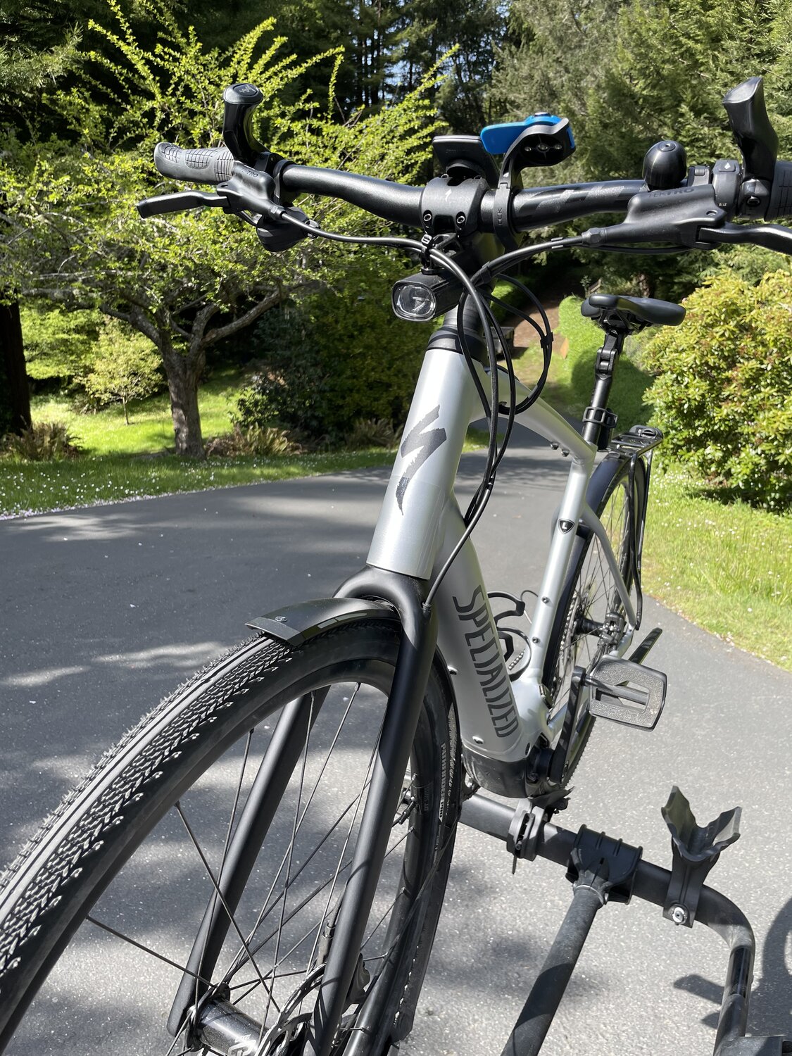

I had a set of Specialized Pathfinder Pro 2Bliss 38-622 installed today. On my initial ride I was very impressed. Quiet, comfortable, steady, and noticeably lighter than the Nimbus that came with my bike. Stefan, thank you for your recommendation!

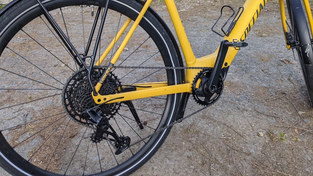

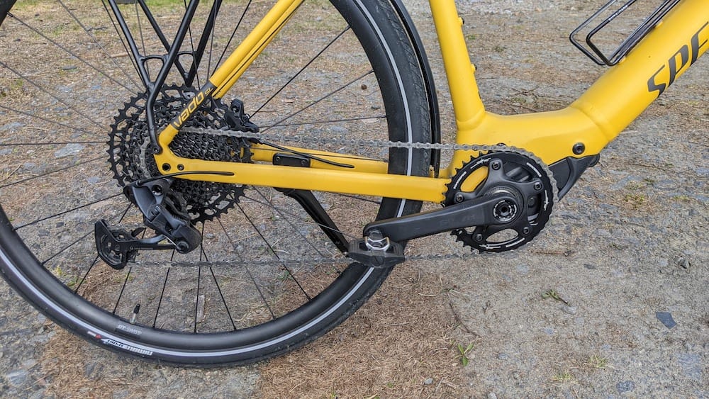

I'm also in the process of swapping the stock chainring for a 38T one, largely so I can use the middle of the block rather than only the cogs on the left. After a chat with @Rás Cnoic I purchased the Raceface 38T ring and fitted it. The chain is now too long ... I can't remember the last time I ever shortened a chain (but am pretty sure I've still got a link splitter somewhere).

Ah ok so that's interesting - on my SL 4 I didn't need to shorten the chain, but then looking at your dinner plate sized largest cog there the reason becomes clear! On the SL 4 largest cog is a 42T, what's that 46T, 50T?
38T & 46T you'll be zooming up Ben Nevis!
Is there any guidance of how much to remove, or is it trial and error?
If your original ring was 44T and the new one is 38T, then it is (44-38)/2 = 3 links less. You can remove 2 or 4 links (I recommend removing 4 for better chain tension).
Removing links is basically irreversible.
Perhaps not with the SL motor but such a gearing already falls into the MTB domain. (Had such a gearing on my full power Vado to make 19% grades).
Mission accomplished ... while inspecting the cassette it was clear that the 11T had never been unused. Swapping out the 44T for a 38T chainring unsurprisingly reduced the gearing throughout by about 15%, which effectively moves the most frequently used cogs on the cassette into the middle, and frees up a monster 38T x 50T which should enable me to climb anything*. The hills around here are sufficiently steep I freewheel down many of them. I followed the Park Tool video for the sizing guidance, though it was slightly more complicated by the narrow/wide teeth on the 38T, and ended up removing 4 links as @Stefan Mikes suggested.
