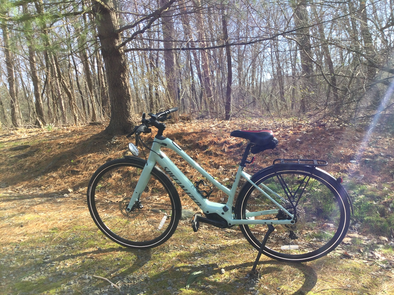

One thing to note about the step-through Vado 4.0 SL is that even with the shorter 280mm Redshift seatpost the post cannot be cut down. My wife is 5’5” and the Redshift 280mm seatpost is still too high for her in it’s lowest position on a M frame.
That's a good point. According to Redshift the maximum insertion to the clamp is 90mm ( 3.54"). I'm 5'7 1/2 so I think I would be ok. My seat top is 26" from the center of the crank, I believe, (I'm not at home to measure). Here's a photo. Can anyone infer if I would be ok?
