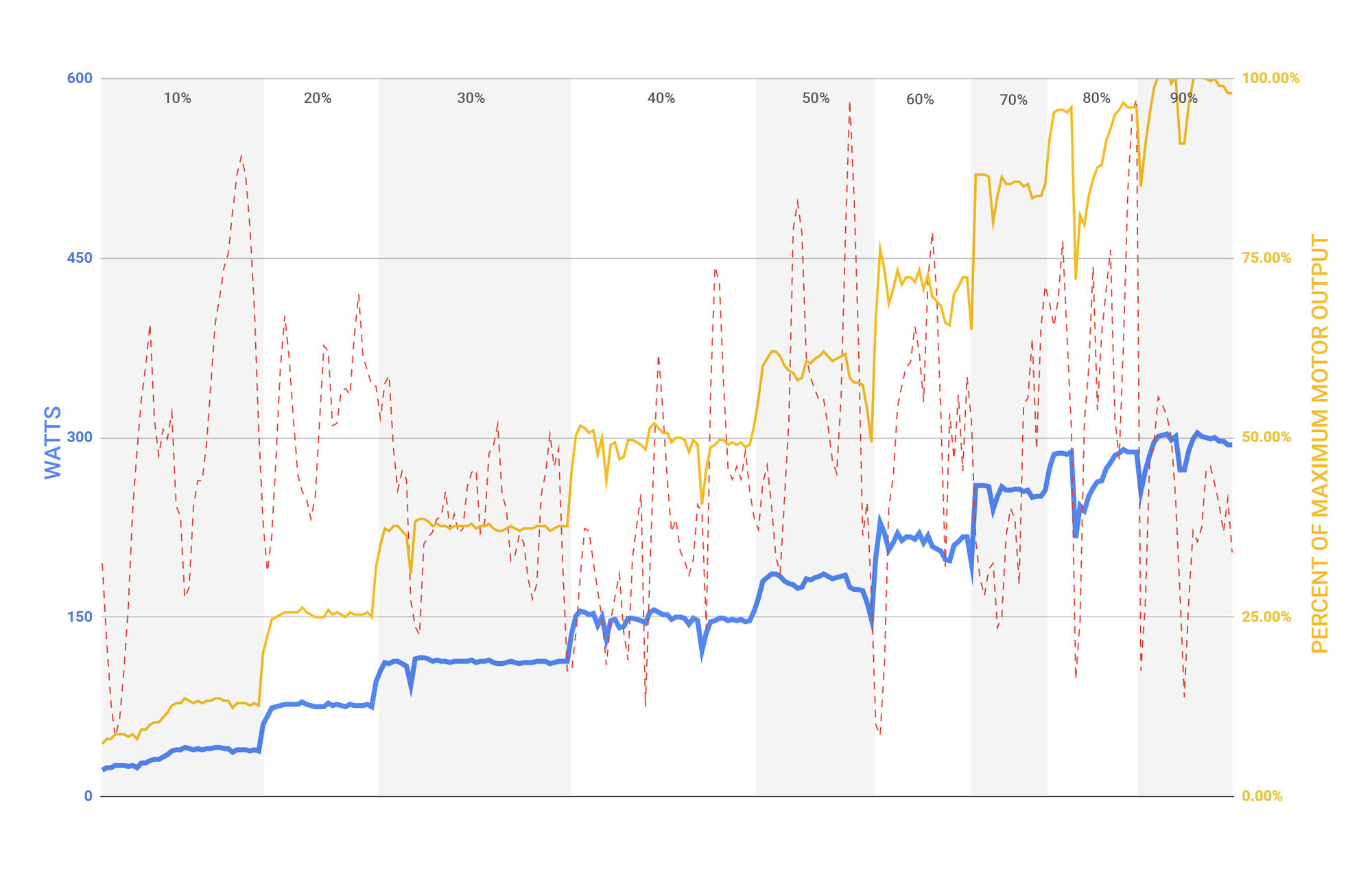

I have been corresponding with Spec Rider Care about my power delivery on my Creo. It feels perfect and I like the amount of assist I get in the stock setting, but I noticed that I was getting a lot less motor power under the same conditions that I did on my Vado SL. The VSL did roughly follow the formula you have explained here many times: 35/35 gives rider power X .35 X 1.8 / .8 (the /.8 to convert from mechanical to electrical power, which is how MC reports it), up to about 107 watts, which is 35% of the max motor power.
My creo, however, seems to deliver power without the 1.8 multiplication factor. So with the same default 35/35 setting, 150 watts rider input on the vado sl just maxed out and gave me around 100 Watts (electrical). At 150 watts on the Creo, I get around 45 watts (electrical). Changing to 35/50 does give more like 55-60 watts at 150 rider input.
Now for something someone might be able to help with: I assumed the three assist levels worked the same way, using the same algorithm. But I took a ride in (eco, sport, turbo) set at 35/50, 35/50, 36/50 and used Blevo to track the data (Blevo requires that turbo assist be higher than sport, thus the 36% there).
I rode at several steady power levels between 100 and 250 or so rider watts. Eco and Sport were very close, sport seemed to give slightly more power but probably too close to call. Turbo, however, gave me twice the power and was hard to ride without maxing out with 175 watts of assist. At 36/50, the 175 watts isn’t too far off from 50% max, but at 36% assist, my 150 watts should be more like 120 watts according to the 1.8 x you formula. I never rode my Vado SL in turbo so I don’t know if it behaved differently than the other modes. Has anyone here noticed that Turbo mode follows a different set of rules than Eco and Sport?
I do like the creo and before I figured out I was doing the same rides that I had done on my VSL, at about the same speed, but with about 1/3 less motor power, I could tell I was riding more efficiently and feeling faster. I just want to be sure my motor isn’t compromised somehow.
in that example, at least, the reason it’s not “1.8x” is because the MAXIMUM limit of 35 is 35% of 300w power draw, or approx 100 watts. if you put it on 35/100 you’d see 2x power draw relative to your leg wattage.
I know that. At 35/35 I expect to see it peak out at just over 100 watts and that would happen with about 140 rider watts. I get about 40 watts. At 200 rider watts I get about 70 watts.
I understand the algorithm to be 1.8 X rider power, up to the max. Setting, which at 35rider, 35 max power will be 100 watts or so. (Adjusted for electrical power)

Yeah, I wondered that too. And I wonder if the Creo is tuned differently than the Vado sl. I know the firmware version numbers are the same so I assumed they worked the same.
In turbo, even at 25/100, it wants to give me 300 watts with almost any pedal input. Since I rarely use turbo, that still works for me as a bail out setting but it makes me question whether things are working as designed.
ah - i missed the 40 watts. my creo definitely doesn’t behave that way when it’s on, for example, 10/100. i get 2 x .1 x riderPower. you can see it quite clearly in the chart i posted above.
as i noted at 10/10 i get no assist at all, so there’s definitely something else going on with the “max” setting. at one point i was theorizing that it also takes into account the TOTAL power including rider, so if you’re putting out a good amount of power yourself, it’ll do very little.
There is nothing like Turbo. Eco, Sport and Turbo are just names of presets. You can set 25/100 in Turbo and it won't be Turbo anymore.
It is not possible that 25/100 in Eco or Turbo presets behaved differently!
One thought: Creo is expected to ride faster than Vado SL because of air drag. Perhaps you are getting less actual assistance because you're riding faster on the Creo?

No, my observations are based on actual data from Blevo. On my Creo, turbo acts much differently that eco or sport. I can send you my Blevo csv file if you would like to see it. It shows that at the same rider input I get an extra 100 watts in turbo as compared to eco, even though both are set to the same assist and max. amounts.
