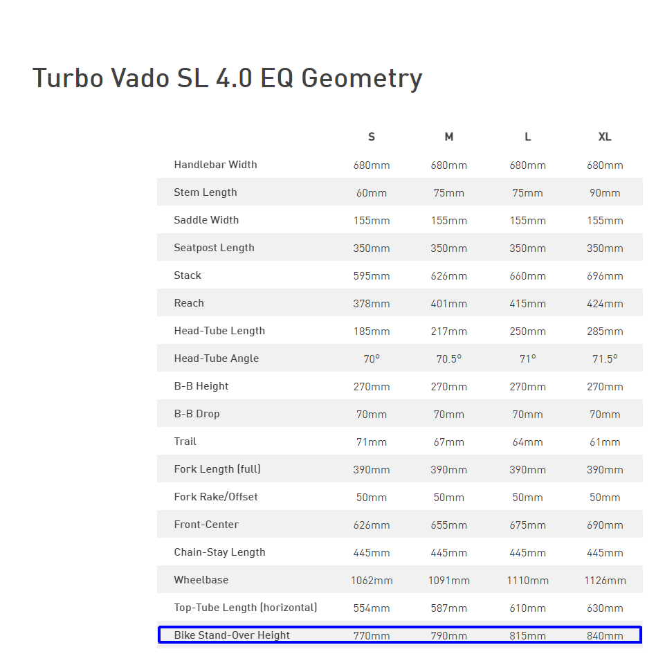

Kahn: What is your own "standover height"? Mine is 780 mm. With the 811 mm Standover Height of Creo size M, I would lose my private parts on the first ride! Why in the earth Spesh thinks all people have long legs?!
I tested an XL Creo along with the XL Vado SL that I ended up buying and the Creo was much smaller. I wonder if your measurements are off - My chart shows these stand over heights (2021 models) for the Creo: S 731, M 759, L 782, XL 810, XXL 840. The Vado SL shows as: S 770, M 790, L 815, XL 840
What size is your Vado SL?

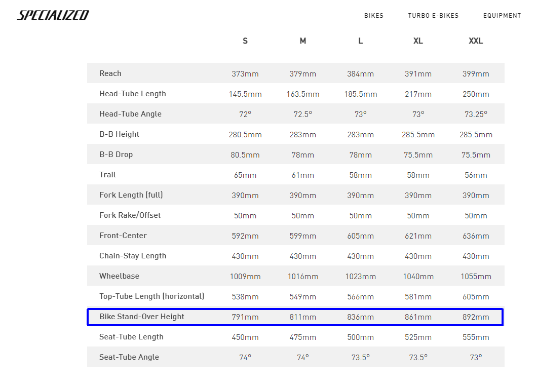

Calcoaster: See the listing of the Creo SL geometry from the page I've just seen:
It is for Creo SL Comp E5.
How comes your values are so different?
Stand-Over Height for my Vado SL (size M). My crotch is very close to the top tube but not touching it!

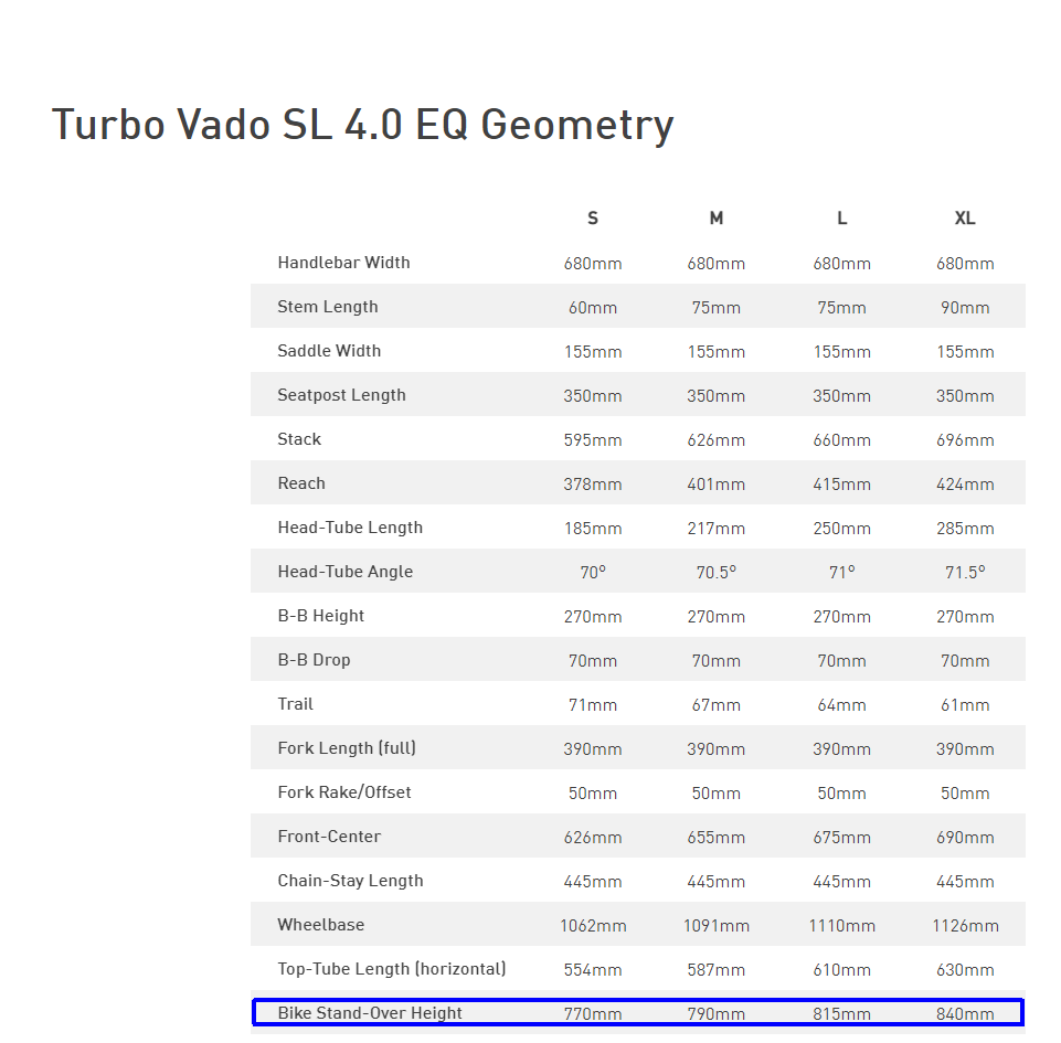

I do see the E5 (Aluminum Creo) shows the stand over heights your chart shows, with all the other models showing the much lower heights in my post. I wonder if the Specialized data for the E5 is an error. When I tested my Vado SL against a Creo, I rode and XL aluminum Creo and it was much lower than my XL Vado. It also seems odd that Specialized would make one model of the same bike with substantially different geometry than the other models. It might be wise to look at Medium E5 in person before ruling one out.

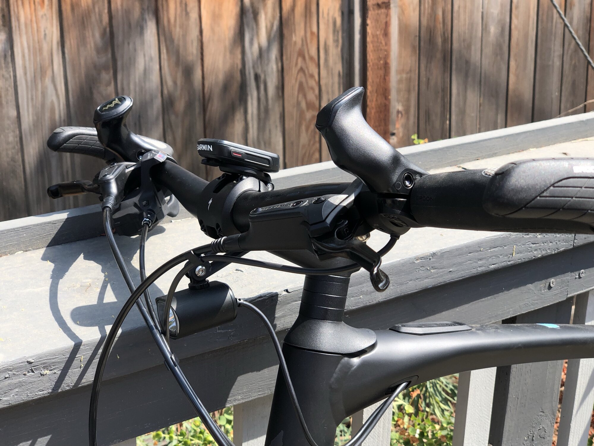

Stefan, another option for a more aero position is one that has been discussed before, but might be worth revisiting, is the SQ Labs inner bar end. I use them (along with the GP3) and they let me get lower and bring my elbows in, which is also important for an aero position. They feel a lot like being on the hoods of a drop bar bike, and my fingers are on the brake levers when I use them.

@Calcoaster: Did you need to move your brake levers even more inside to be able to install the Inner-bars? How did that affect the lever reach from the main part of the handlebar grip?

I did notice a discrepancy in the Creo Aluminum vs Carbon data tables and the aluminum version shows 811mm stand over for a Small frame?? I suspect it is a misprint since that is in between the L and XL in a carbon version. I do not think they share the same aluminum frame assembly but some components prior to welding may share common tooling. It's pretty clear to see the differences at the head tube and seat tube clamp. Chain stay length is also different.
It must be, then. It is weird to think a Small bike would be as tall! Pity, as I could have considered a Creo earlier this year. Not that I'm not happy with my Vado SL: it is only my needs have changed. Everybody around me got crazy with that gravel cycling thing :D

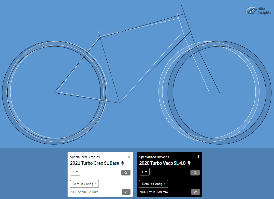

the differences between the two can probably be summed up by saying that for any given size, the creo is shorter, and lower. it's definitely not a particularly racy geometry for a road bike - call it halfway between a fitness bike like the vado sl and a true racy road bike like a tarmac. the creo much longer stems (20-25mm) which plus drop bars gives a range of hand positions from "somewhat similar, but much narrower" on the top of the bars to "much much lower but about the same reach" on the drops. on the hoods, the "shorter" frame is more than cancelled out, putting the rider in a more elongated and somewhat lower position.
it's this ability to move around while seated that i find refreshing about drop bar bikes; three different positions while seated, two of which are also useful out of the saddle!
note also in the diagram that the bottom of the wheels are not on the ground, the alignment point is the bb; the offsets of the sets of lines are relative to the riders feet. relative to the ground, the creo is lower still. in the medium size, standover height is a full 31mm lower!

Stefan, I put the SQL inner bars up against my grips and did move the brake levers out a little. It’s not a problem at all and the brake levers are still an easy reach from both the grips and the inner ends.
Thank you @Calcoaster! I'm going to look more closely to these grips.
