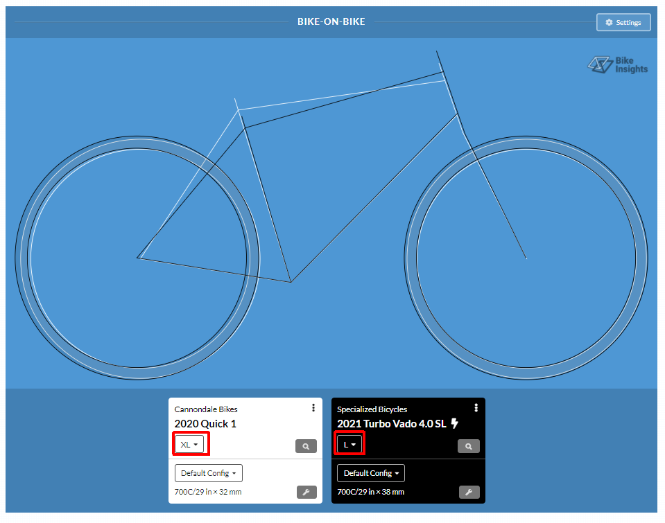

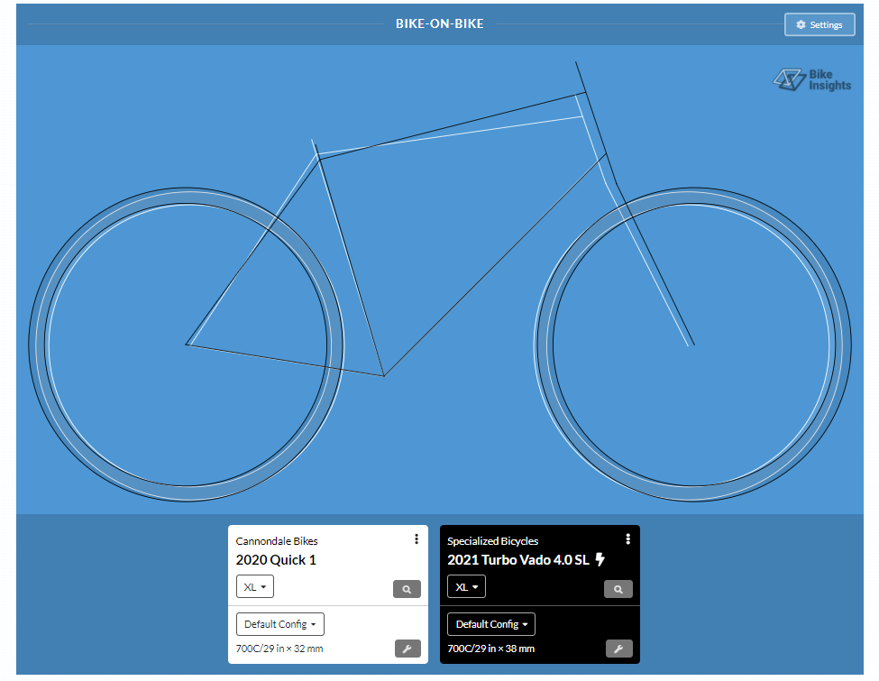

Which comparison looks more convincing to you?

I'm not sure the 2020 Cannondale Quick is the same frame geometry at all (I think mine is a 2015 bike and it's no longer sold, or listed on BI - see photo).
The 2020 model has an aluminium frame rather than my full carbon frame and forks and the standover is about 2 cm less for the current model. I'll check the other dimensions.
That they're different would also fit with the first of the two images you embedded. The XL SL Vado has a standover of 84 cm (identical to my Cannondale as measured). However, the 2020 Quick you compare it to is shorter (both on paper and in the BI diagram).

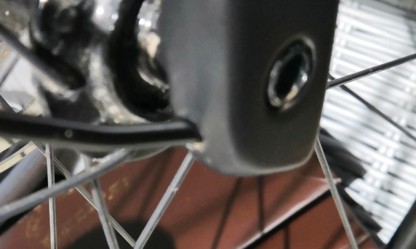

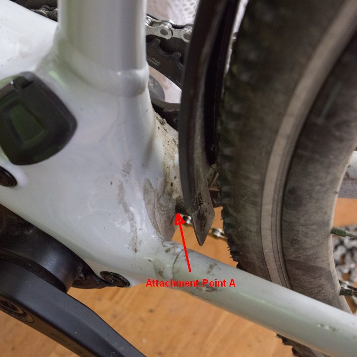

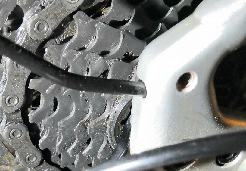

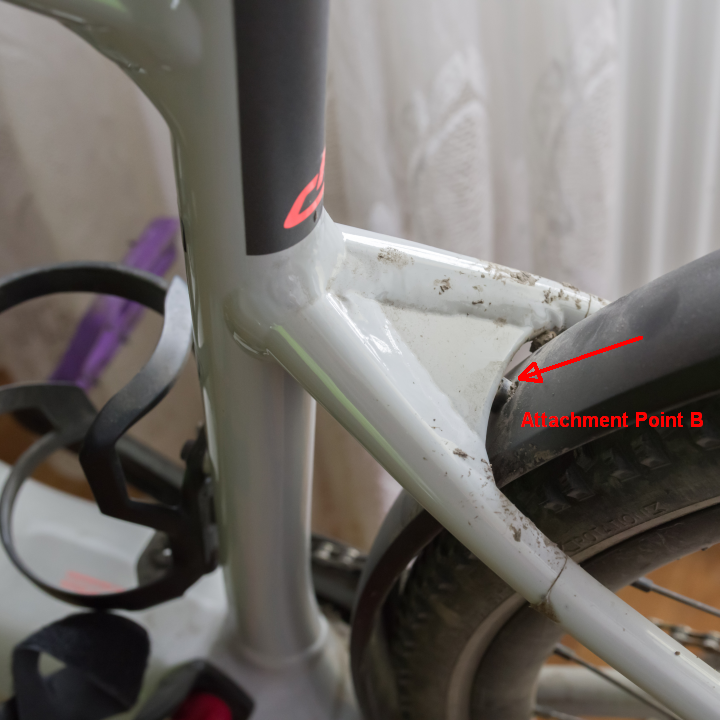

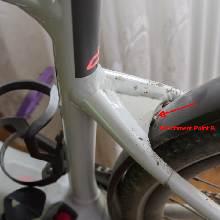

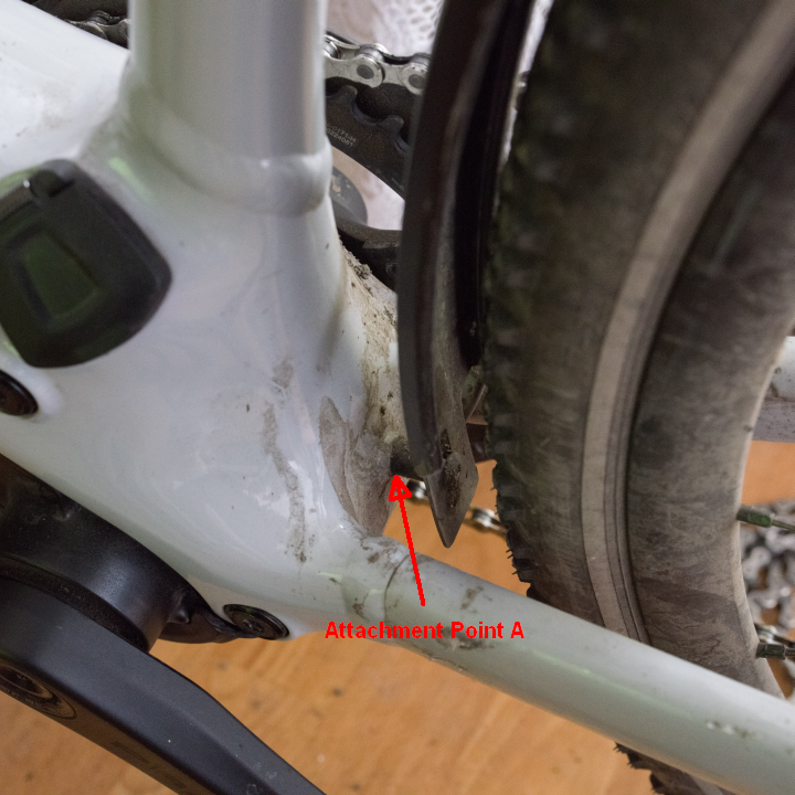

Installing mudguards... Not that easy. For the rear mudguard, Vado SL has two attachment points: a horizontal one very low at the back of the motor, and another at the rear triangle joint. Normally, the Vado SL rear mudguard is also supported by the rack in two attachment points. It means, there are only two attachment points that you could actually use (A and B).
With the front mudguard, the attachment point is a vertical hole under the fork arch.
For these reason I was suggesting blade mudguards attached to the fork, and to the saddle (or rear triangle) with zip-ties.

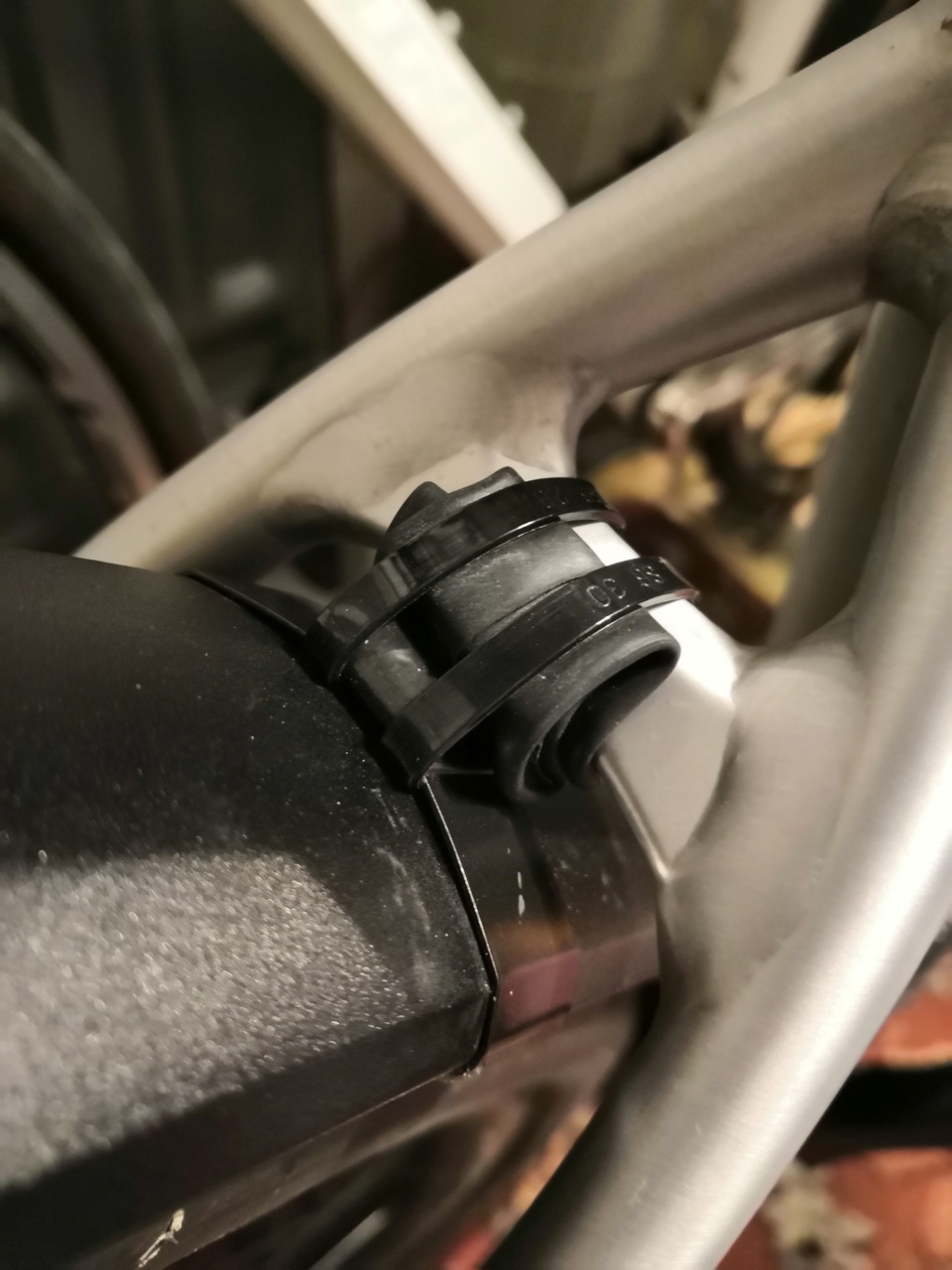

On the other hand I'd suggest getting the non EQ version. I only put mudguards on my TV SL5 for the winter season when I prefer to stay clean and dry! Otherwise for the rest of the year I like the smoother lines and less encumbered look of the bare machine... Guards are available from Specialized and fit very well (though my rear guard is slightly non-standard as I was an early adopter last year - pic attached!)
How do you support the back end of the mudguards @PennyFarthing ? I can see from Stefan's pics where they attach behind the bottom bracket and under the junction of the seat stays. However, your pic has a bridge at the seat stay junction, whereas Stefan's looks like it's brazed together as a filled-in triangle. The current pics on the Specialized website look like this as well - a filled-in triangle.

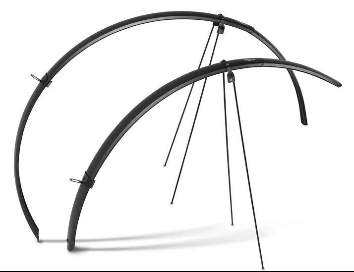

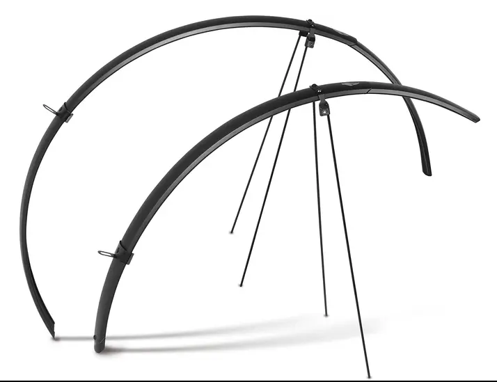

The guards are essentially 'Drytech's like this: https://www.specializedconceptstore.co.uk/product/16635/2017-dry-tech-fender-set/
When I bought the bike I got my LBS to fit a pair, however due to size availability issues I ended up with guards that were a bit too wide. My LBS nibbled some metal off the front guard to make it fit between the forks, however this introduced a point of failure - so when metal fatigue struck I got the correct front guard. The rear clip that secures to the frame also succumbed to fatigue, hence my very effective tie-wrap and bit of old inner tube cushion!
I just walked into my local Specialized store earlier this year and they sold me just a front mudguard for £20 which fitted perfectly [not sure I would have paid the price shown on the above link for a set!]. I assume I could have got a similarly priced rear, but as I'm still using what my LBS put on I'm fine for now. The stays fix into the provided holes in the frame and are held with tiny allen head grub screws. Front & rear shown, photography not the best due to cluttered & dark garage!
I'd advise discussing with a store before ordering guards to make sure you get the right sized/priced ones!

I might have misunderstood you but Drytech mudguards is something I want to get rid of :) I hoped for some MTB mudguards.
