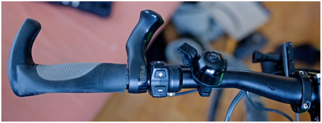

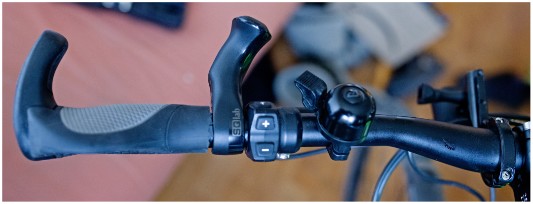

@Calcoaster & @TS25: I hate you. Because neither of you showed the details of installing of SQLab Innerbarends. Can you see anything wrong here?
Yes, it is. With this setup, the thenar eminence (Mount of Venus) of my palm rests on the remote. Not nice.
To make this wrong setup, I had to:
  • Remove the (precisely setup) Mirrycle mirror
  • Remove the Ergon GP2 bar-end (meticulously tuned for angles)
  • Cut the GP2 to remove 22 mm of its width (I won't let my controls travel another 22 mm to the right here!)
  • Insert the Innerbarend and set it in a right position.
So, do you ride with the remote under your palm? Your mount of Venus: what is it supported on? And you call it ergonomic?!

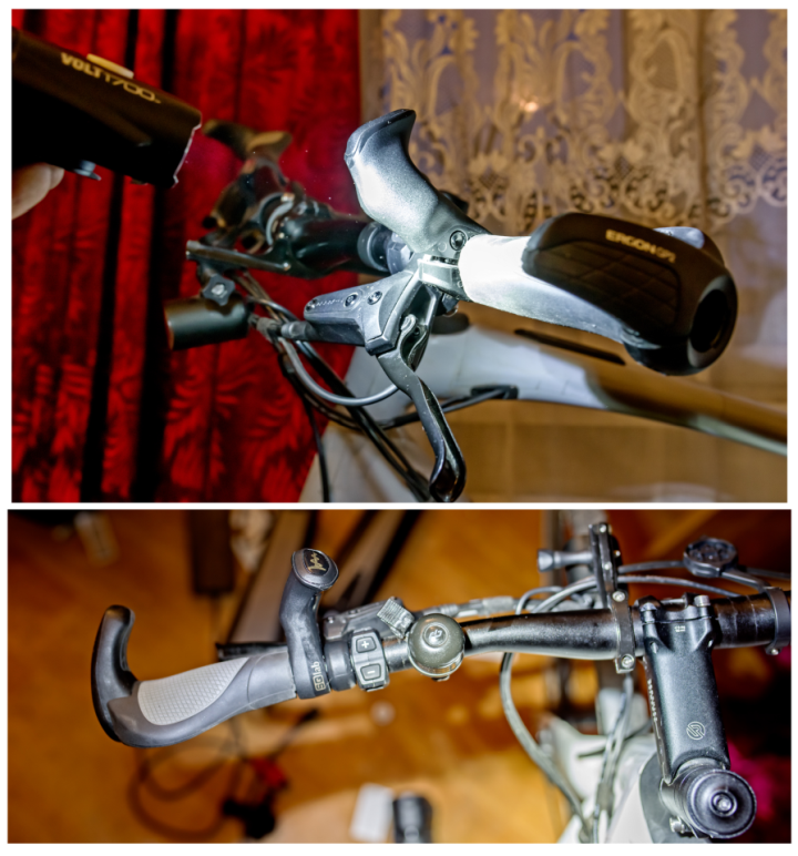

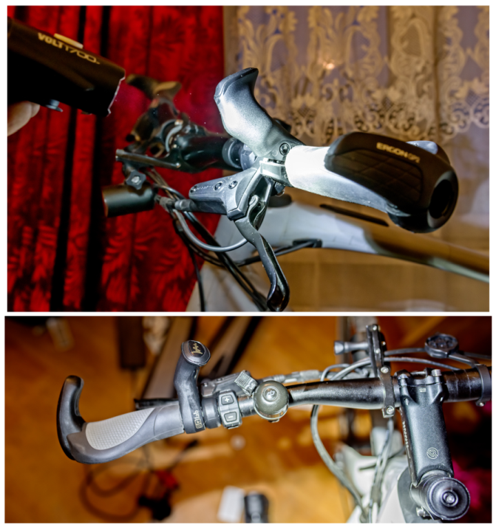

Now, that could be cured by swapping the remote with the brake lever mount:
  • Remove the Ergon grip
  • Remove the Innerbarend
  • Remove the bars from the Redshift stem (because of the insufficient cable slack to remove the remote and the brake lever)
  • Untie the cables
  • (write the rest yourself)....
But no! The left brake lever has no cable slack left! Impossible to move the brake lever to the left any further!
I'm going to explode. That little piece of .... German "engineering art" is so small it barely fits my large hands, and will be useless when I put thick winter gloves on...

I thought my pictures in this forum present since 2020 were self-explanatory. Of course you better put the brake levers next to the grips, as shown:
No need to remove the bar from the stem, or the remote, for that. Just remove the left brake lever completely, slide the remote to the right and set the brake lever back, next to the grips.

Whoever has invented SQLab Innerbarends shall deserve a slow & painful death...
Now, the two smaller fingers of my left hand are in conflict with the brake lever unit.
Useless crap. You own me a new set of GP2, both of you. You can share the cost :D And I'm throwing the Innerbarends to a dustbin after the first ride!

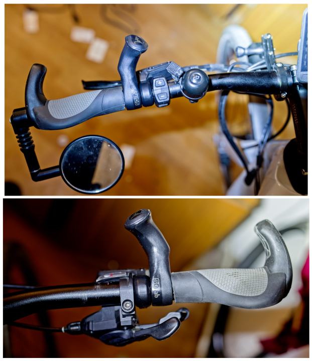

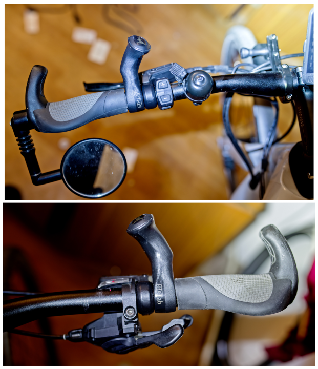

SQlab Innerbarends Finally Mounted...
The process required shortening the GP2s, removing the handlebars from the stem, loosening all controls on the handlebars, reorganizing some controls, re-tightening and readjustment.
Everything to install that weird contraption :) It is even not rubberized! Fancy holding it during the frost, snow, in the rain or sleet... I only hope my nearest rides could convince me to this invention...
P.S. The way I reorganized the left side gives me access to the remote, and even to the bell... Only I need to remove my hand from the innerbarend to operate the remote. (I can operate the remote from the main grip without issues).

I have completed my Innerbarends test ride. Honestly, I could live without them. They are hard on palms, even in gloves! The width of handlebars for ride control becomes very narrow, making it less controllable. Still, I won't throw the SQlab into the dustbin. Not yet. I need a very long ride to determine the usefulness of the inner bar ends yet.
What I cannot understand are claims of several users that innerbarends are better than GP2/GP3. Not for me. I spend hours riding in GP2/GP3 bar ends to the utmost satisfaction.
